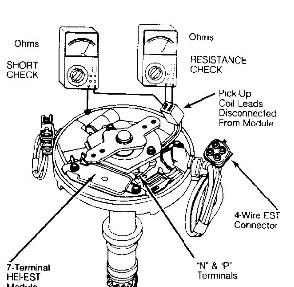

Car turns over but will not start. Have replaced the carburetor, coil, plugs and wires, cap and rotor, ICM, ESC. Checked for spark, was barely a spark at the plug. Any ideas ? Thank you!

check pickup coil in distributor for resistance twirl the wires while doing this should be 500-1000 ohms if not replace it. also if this has a tachometer pull the white wire off as it will cause engine to not start. finally take module inside dist to auto parts they can test to see if it is bad.
