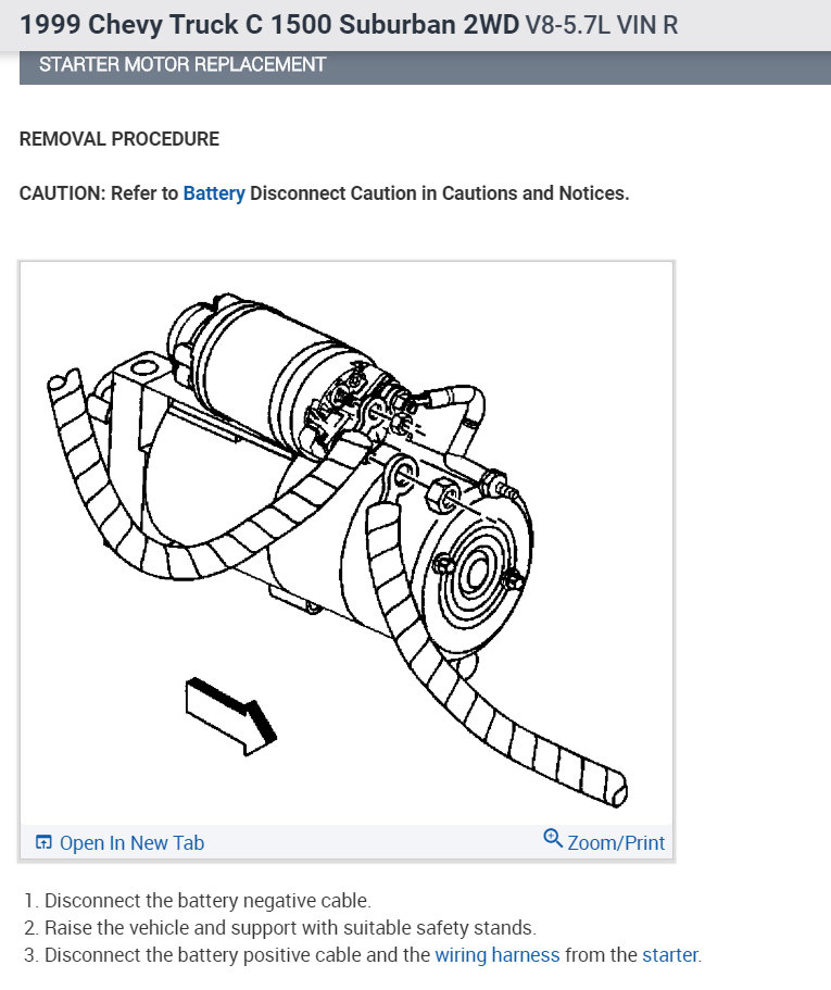

It sounds like the starter motor is going out which is common. this guide will help confirm the issue:

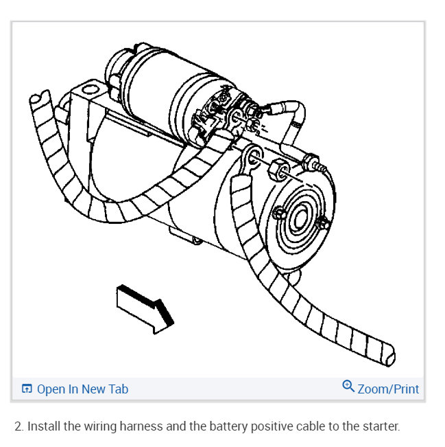

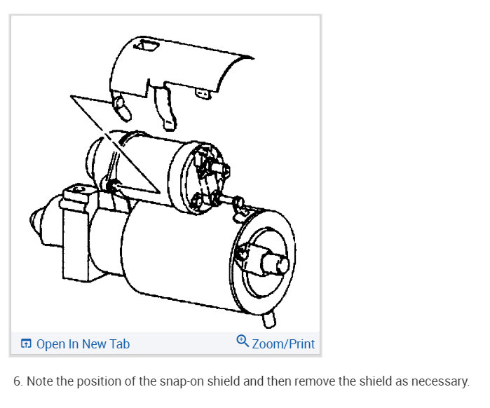

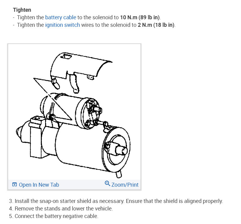

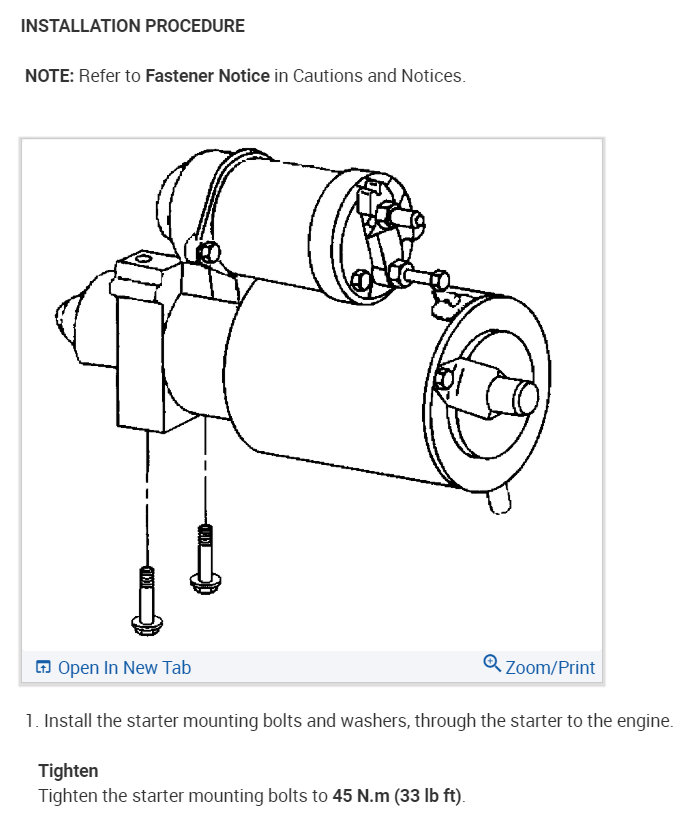

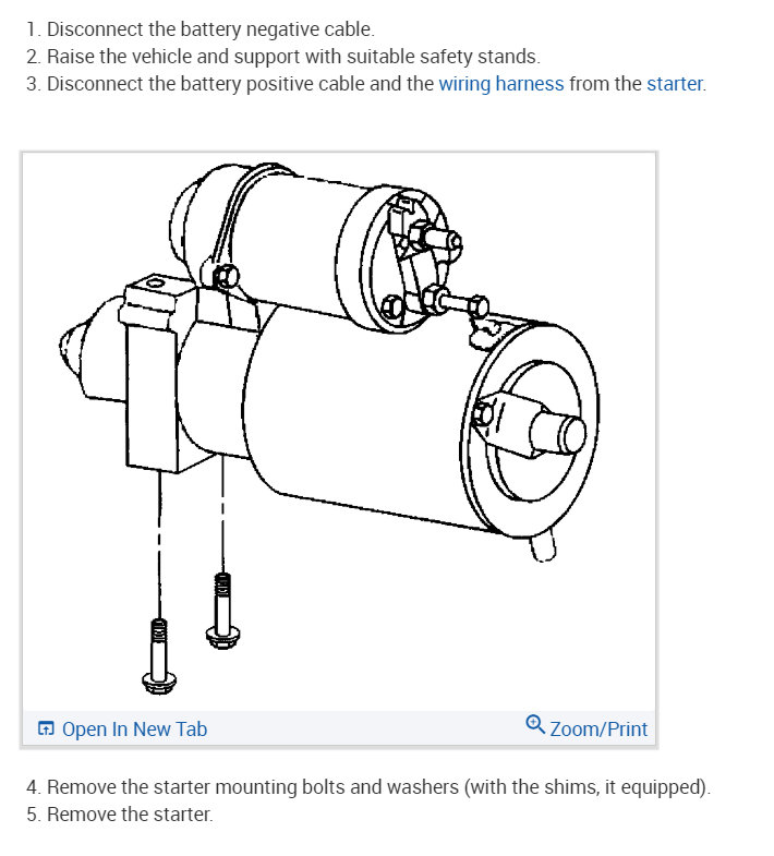

This guide will walk you through the replacement with diagrams below for your car:
