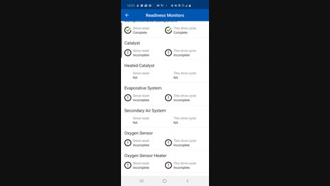

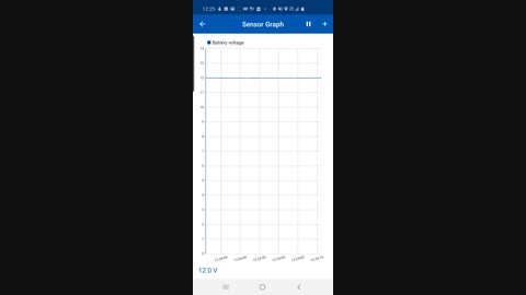

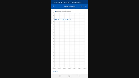

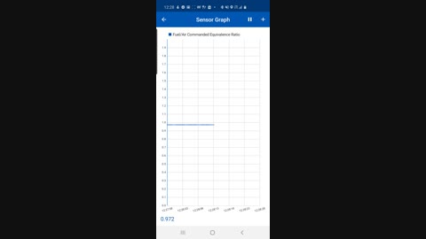

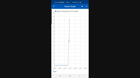

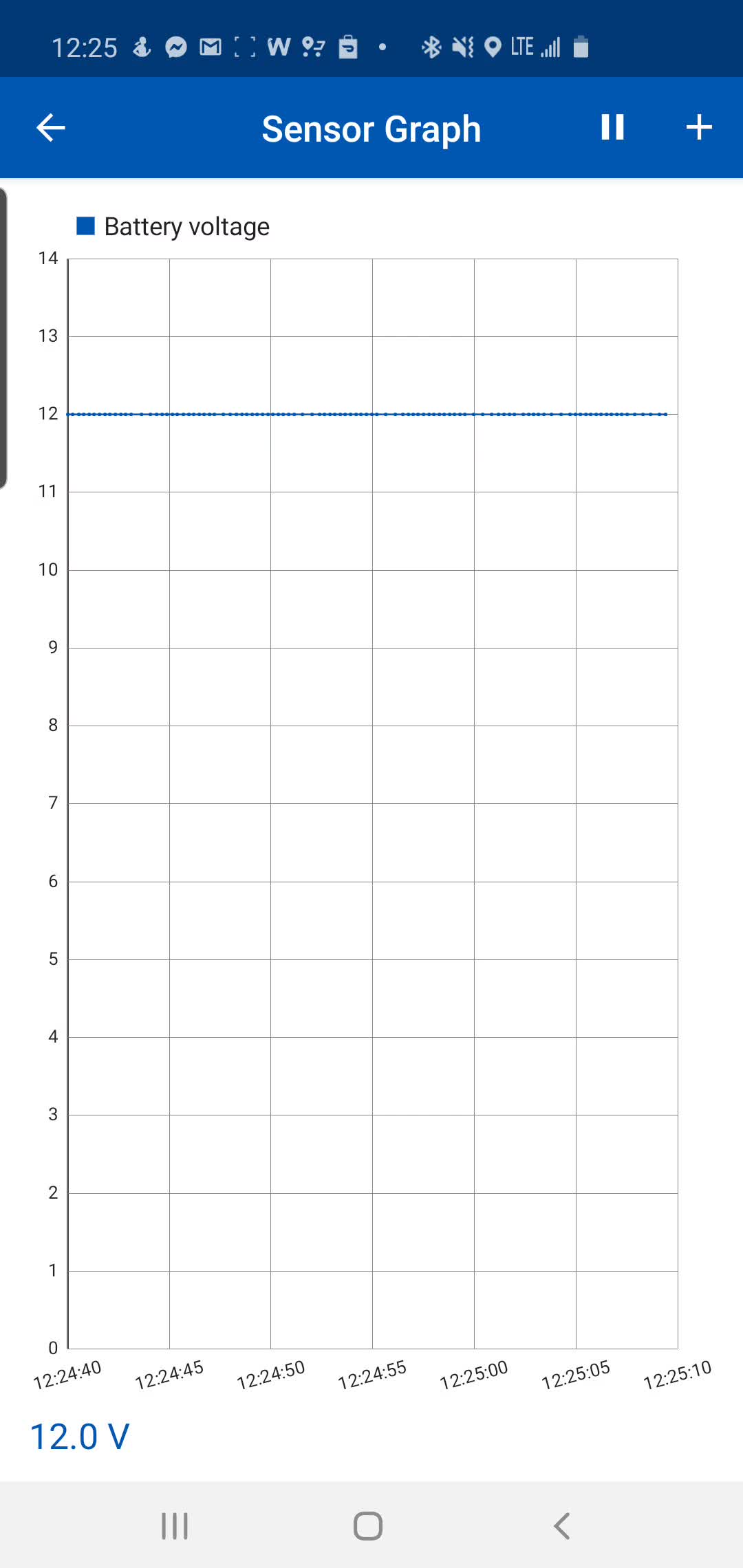

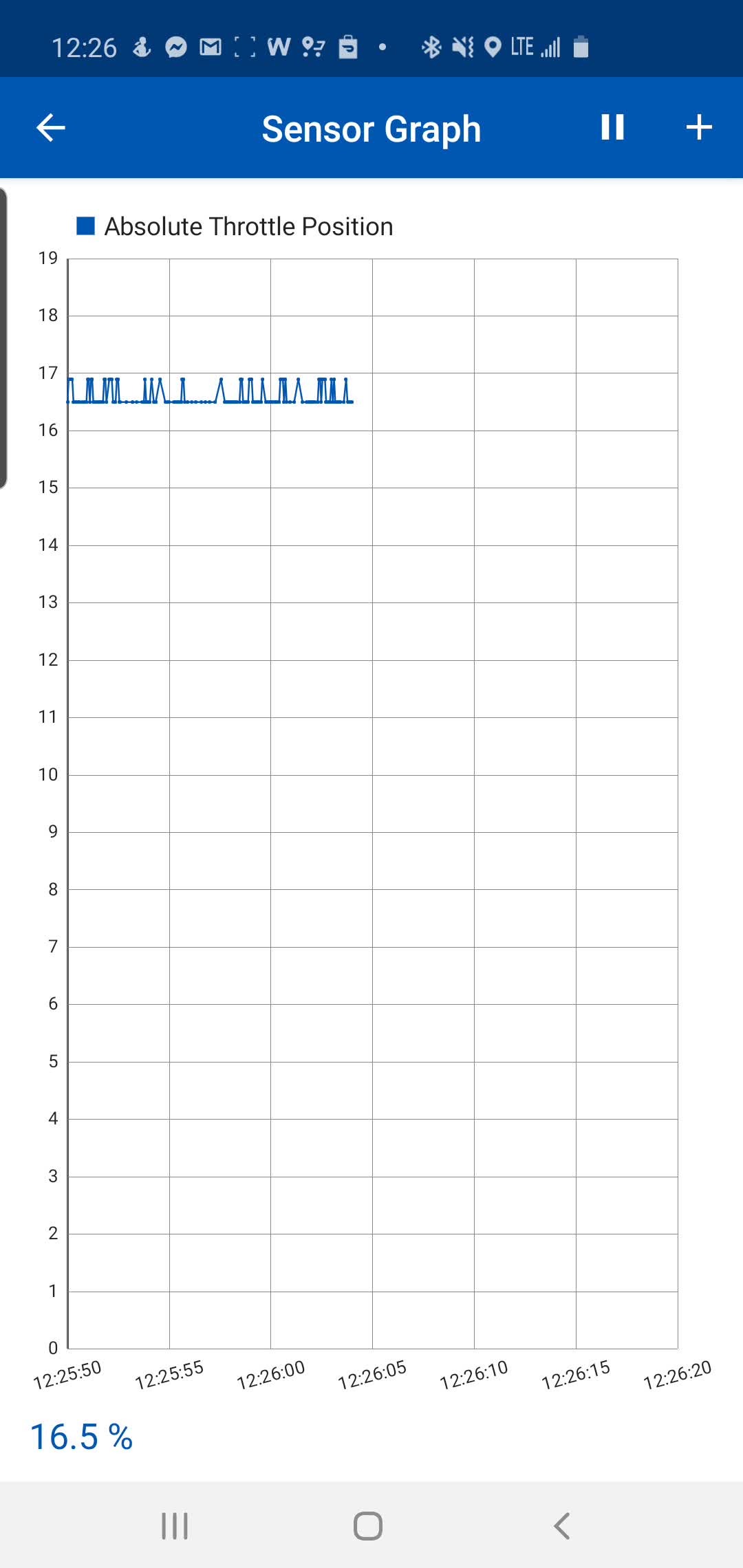

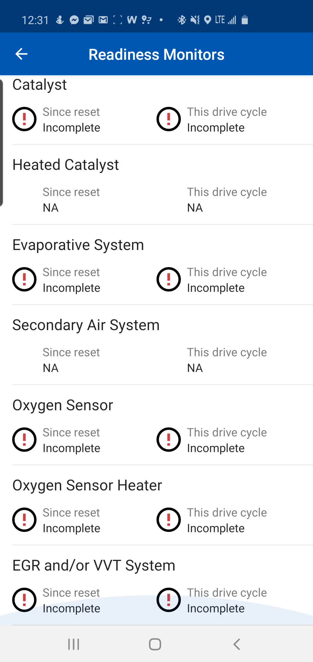

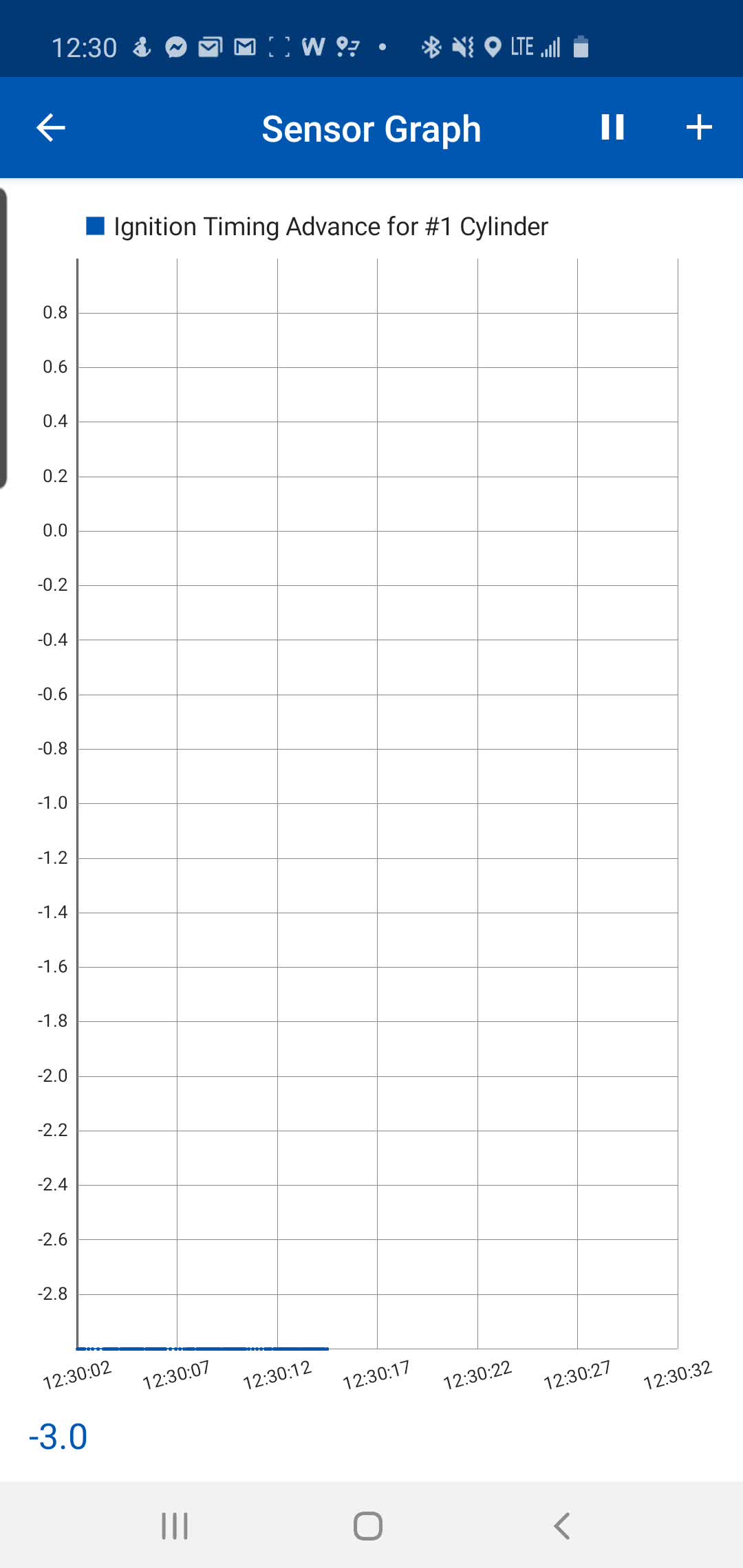

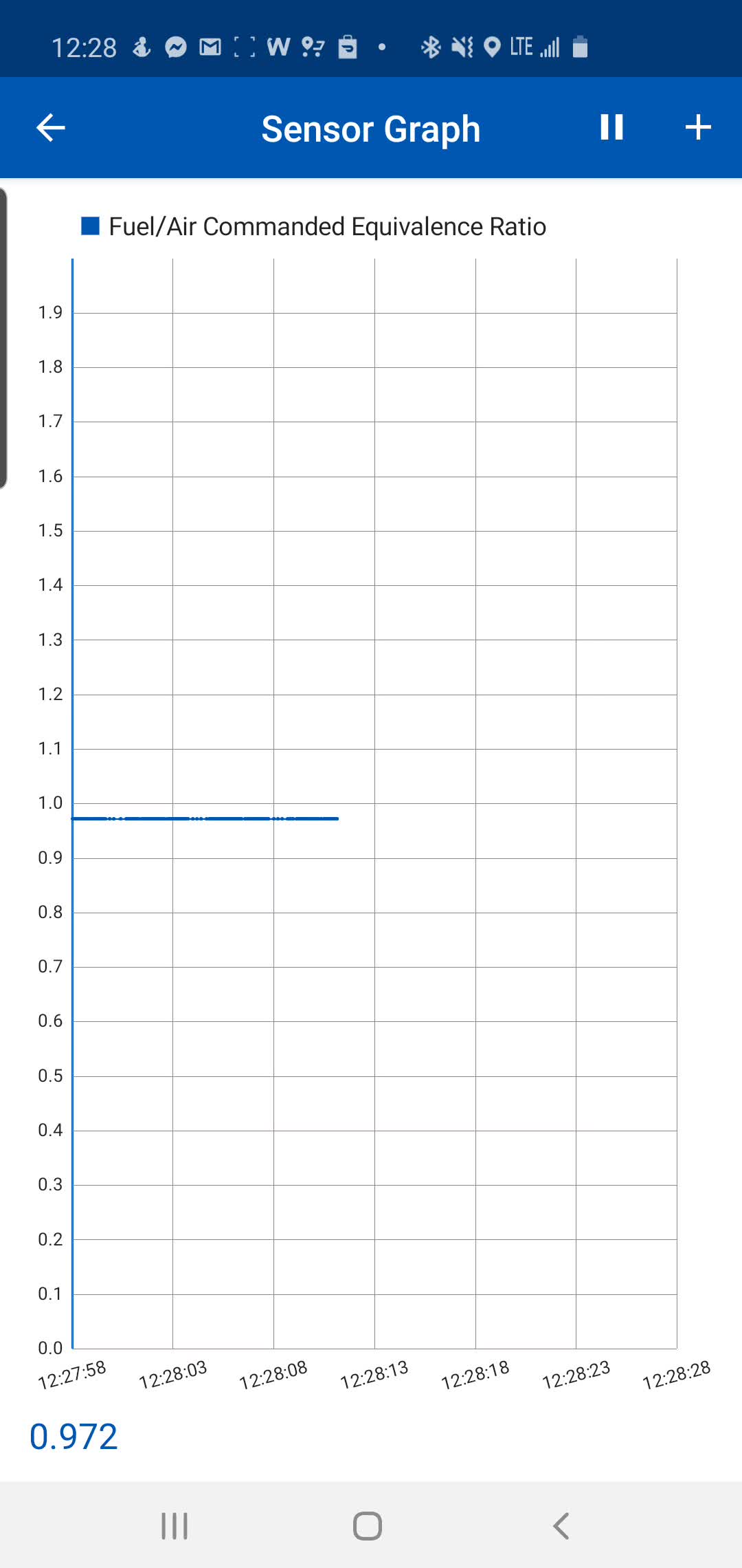

The car red lightning bolt light up. Nothing else. Starts with starting fluid but stalling right after. The battery died in the winter a couple of times . We had to change the belt and the idler pulley.
We bought a obd2 Bluetooth scanner but no codes shows. Our neighbor put his own scanner he said oil pump.
Our scanner can run diagnostic and check sensor. I made some picture and video about it. I try to send here.

Good afternoon,
The first thing I would do is to check the fuel pressure to the rail.
You may need a fuel pump.
There is no code for the oil pump. I have no idea where he got that idea.
Check the pressure and let us know.
