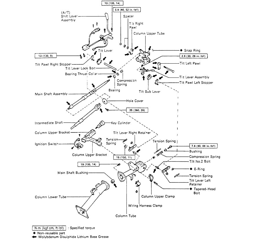

When i start the key it start but if i release the key the stop..
Feb 9, 2023 at 11:38 AM
Experienced Mechanic
55,542 POSTS

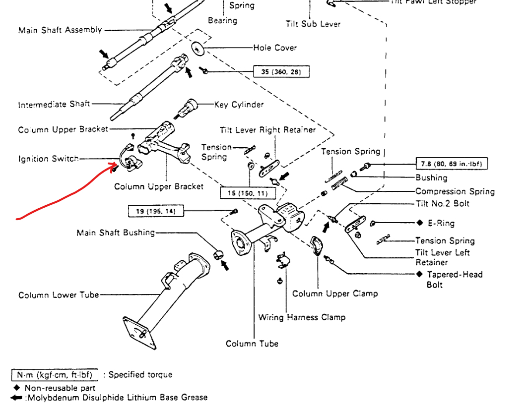

This is common when the ignition switch goes out. here is how to replace it in the images below. Let me know if that fixes it, please.
