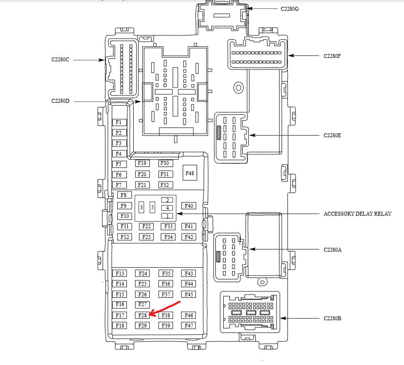

The car does not crank. Did the usual checks on the fuse and the starter relay; all look good. The battery is fully charged. I do know that the starter is good because I jumped the starter relay and it cranked the engine. I'm at a loss for why the key will not crank the engine. Did try to start it in neutral and still nothing.

Does this car have the push button start or key? If it is the push button I have seen this go bad. The starter relay is controlled by the PCM fyi, I would check fuse #f28 on the BCM fuse panel, this guide can help and I have located the fuse for you in the images below, also please go over this video to help.
https://www.youtube.com/watch?v=6YRW8fyNudY
Fuse check guide:
Please check these out and get back to me. Check out the images (below).
