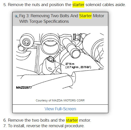

Sometimes the car would not start in park or neutral and sometimes it would. I replaced the transmission range switch but that did not solve the problem. Any ideas what the problem might be?
Jul 14, 2018 at 5:37 AM
  • 55,709 POSTS

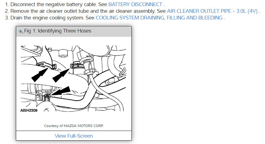

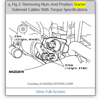

It sounds like the starter is going out, but to be sure lets use a test light at the starter when it will not crank over to see if the trigger (small) wire use this guide to help.
and
