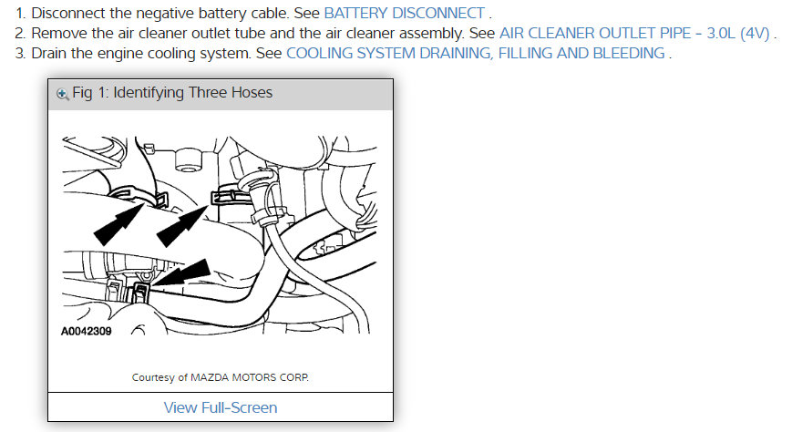

Sometimes the car would not start in park or neutral and sometimes it would. I replaced the transmission range switch but that did not solve the problem. Any ideas what the problem might be?
Jul 14, 2018 at 12:37 PM
  • 54,835 POSTS

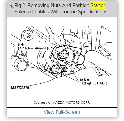

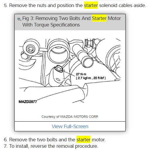

It sounds like the starter is going out, but to be sure lets use a test light at the starter when it will not crank over to see if the trigger (small) wire use this guide to help.
