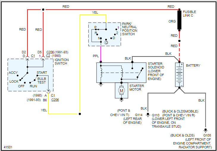

intermittently, my vehicle listed above V6 the starter begins to spin freely, then binds or grabs and then releases to spin freely again. I have replaced the starter and battery but the problem remains. (like a power short of some kind?)

Clearly I would suspect the starter is the issue on this but if you replaced it and it is doing the same then then we have to assume there is another issue. So we need to go to the starter and check voltage to find out what the possible issues are.
I attached the wiring diagram and you should have 12 volts all the time on the black wire. Which I suspect you will.
Then we need to have 12 volts on the other wire only when you are turning the key to start. Let's monitor the voltage when the starter is engaging and disengaging and that will tell us we have a control issue if the voltage is low or varying. Let's start here and see what happens. Thanks

I will need to get assistance in the next day or so to evaluate your answer and respond. Thank you so much for the advice!
