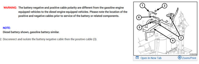

Yesterday my grandmother told me that her car wouldn't start and I went to jump off the battery and the car would start when I jumped it off, but whenever I took off the cables for my truck it would shut off once and then whenever I had it running I took off the positive power from the battery and the car stalled what might be the issue.
Nov 12, 2024 at 10:40 PM
  • 55,732 POSTS

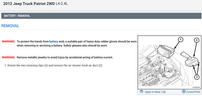

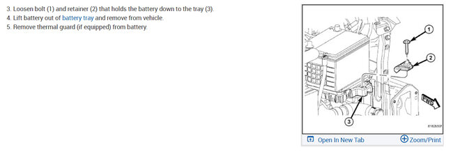

Please do not remove the positive cable from the battery while running, you can blow out computer modules. It sounds like the battery or alternator is bad. I would jump start the car again and then use a voltage meter at the battery to see if the alternator is charging. This guide can help, if the battery is charging that replace it with a new one and the problem should be fixed, here is a guide to help you:
Here is how to change the battery out. Check out the images (below). Please let us know what happens.
