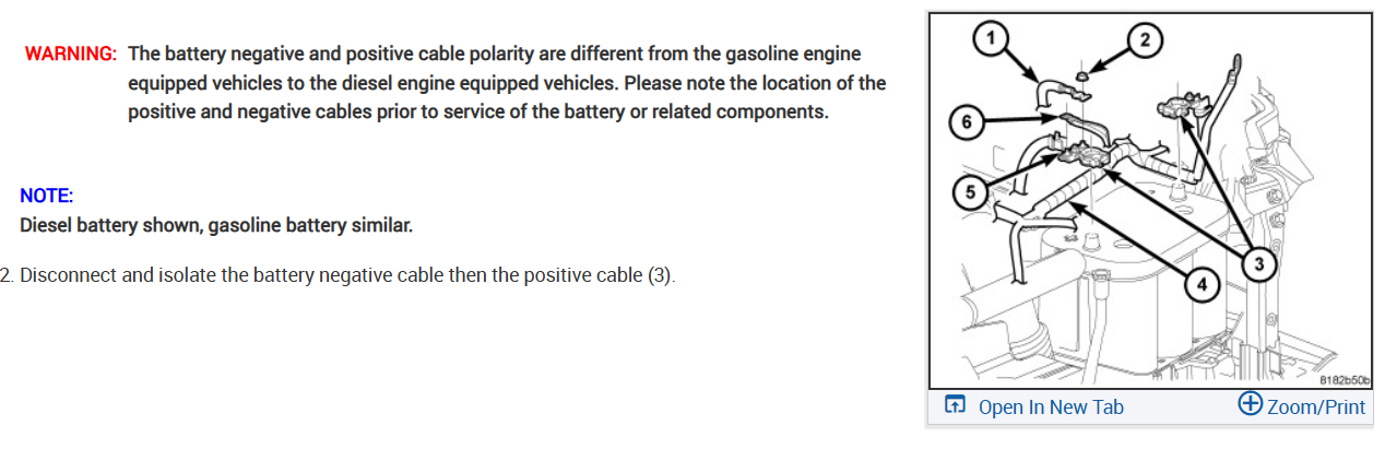

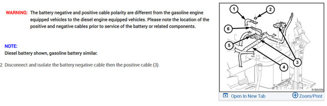

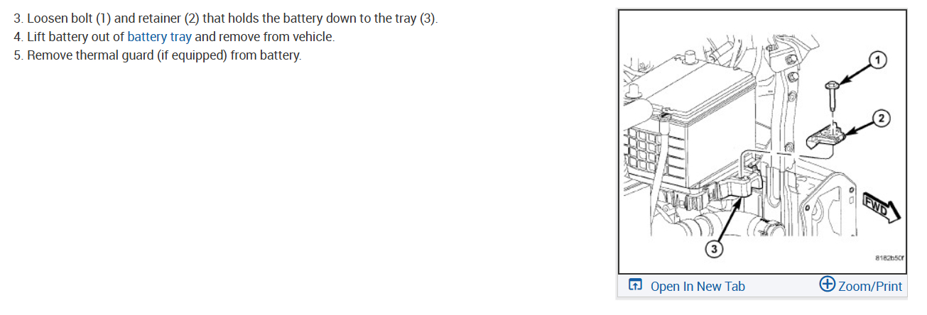

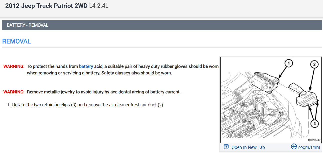

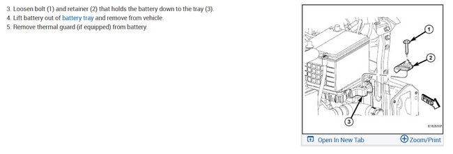

Please do not remove the positive cable from the battery while running, you can blow out computer modules. It sounds like the battery or alternator is bad. I would jump start the car again and then use a voltage meter at the battery to see if the alternator is charging. This guide can help, if the battery is charging that replace it with a new one and the problem should be fixed, here is a guide to help you:
Here is how to change the battery out. Check out the images (below). Please let us know what happens.
