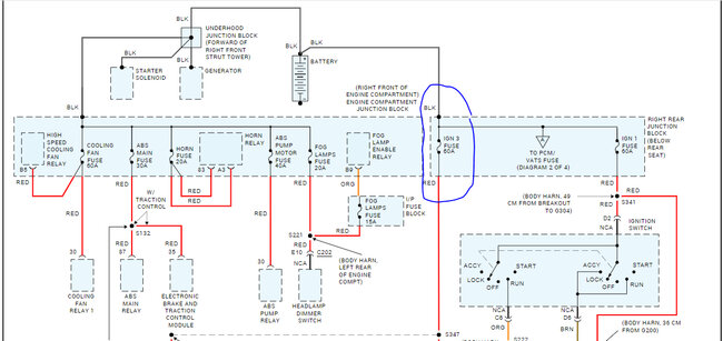

I recently had my alternator tested and they said it was going bad, so I put in a new alternator and battery. I drove it yesterday morning no problem but when i shut the car off it won't start is giving no electricity at all.

Recheck the battery terminals to make sure they are tight. If they are, check the ignition 1 or 3 fuse under the rear seat.
Let me know what you find.
See pic below. Note: I am basing this on the idea that nothing electrical is working.

I checked the fuses they were fine; the problem was the bolt that was screwed into the positive ground wire for the battery was rusty as heck, so I scrubbed it with a wire brush connected it back now the car starts perfectly fine. I do appreciate you time Joe, thank you kindly.
