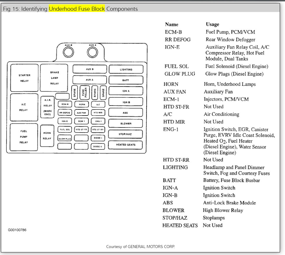

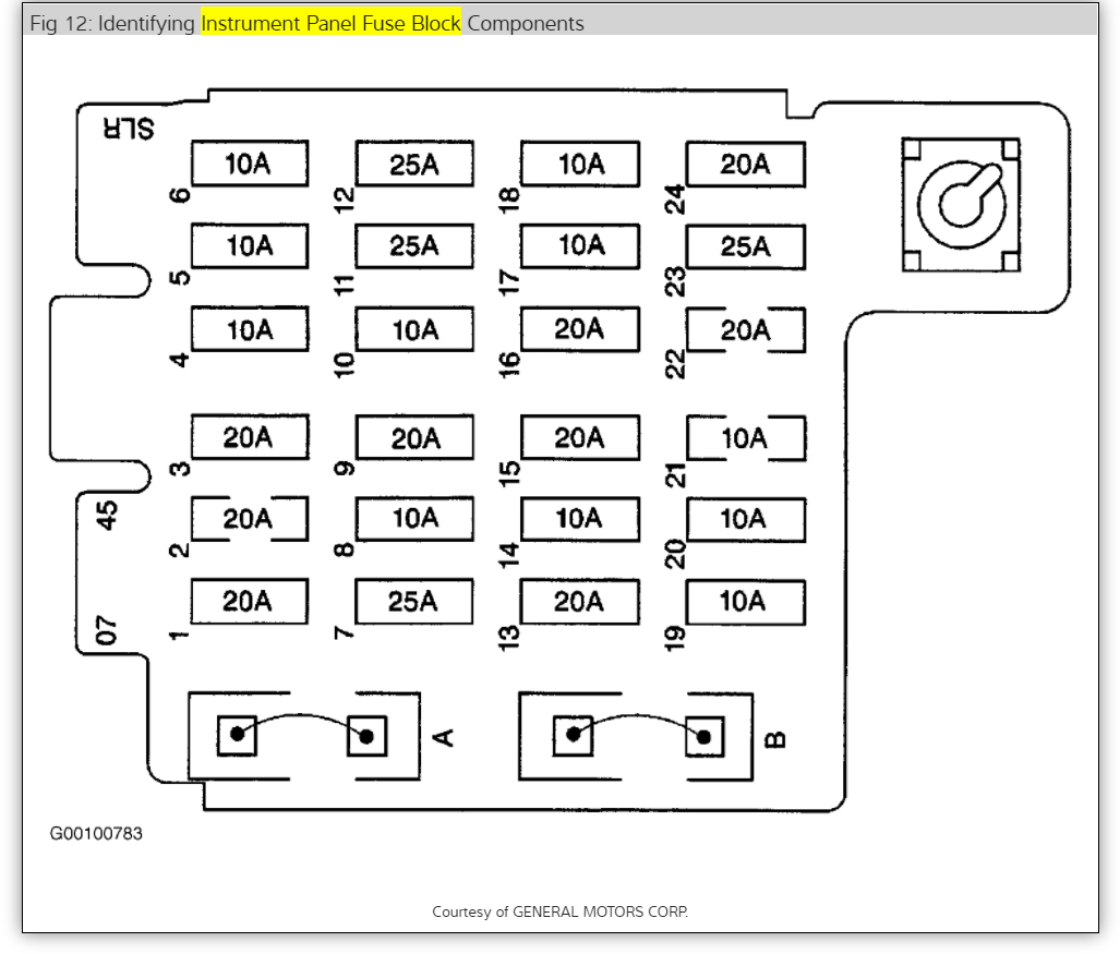

I replaced the ignition switch, ignition switch housing and I reset the security system. The truck ran fine for a couple of days. Today truck won't start, gauges aren't working but drive selector and mileage are working.
Jan 2, 2024 at 11:24 PM
  • 55,721 POSTS

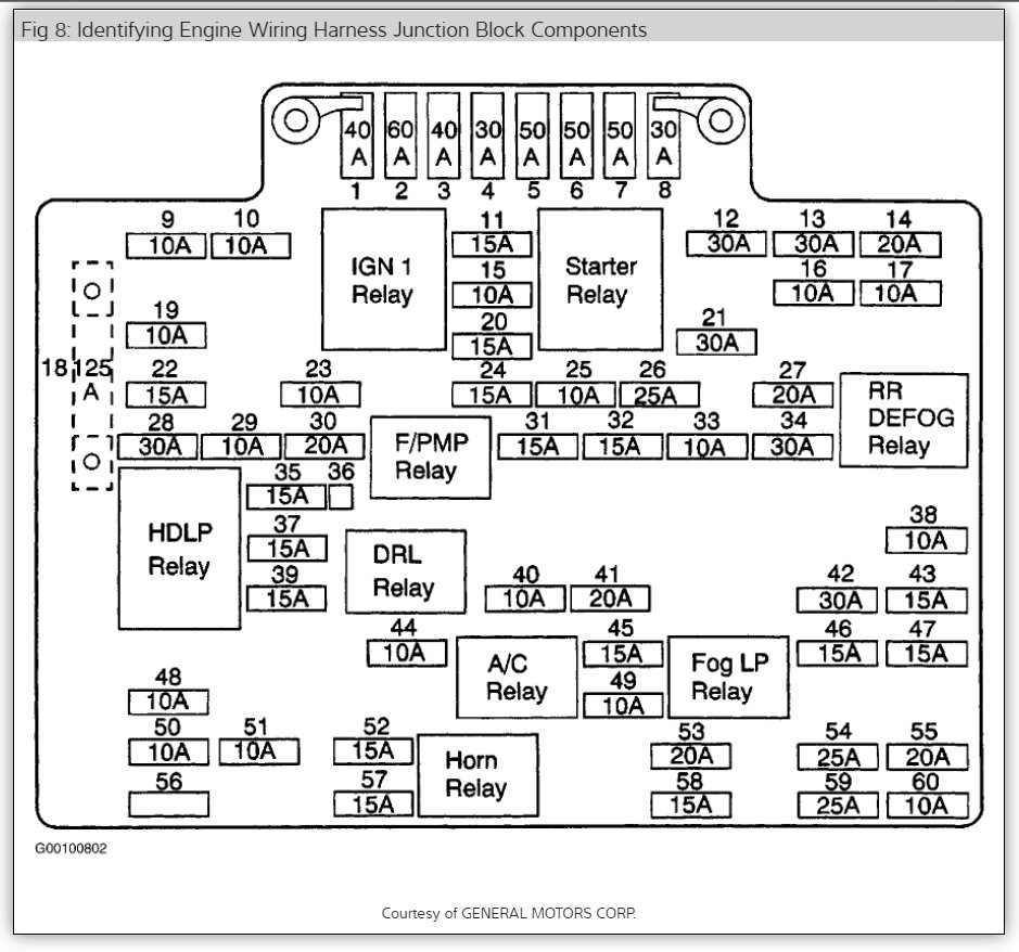

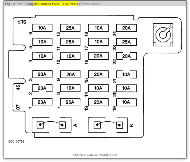

I have seen a shorted instrument cluster cause a no start issue. We need to check a few things, first when you turn the key on without cranking the engine over can you hear the fuel pump inside the fuel tank for about 5 seconds?
If so, let's check for spark which this video will help with:
https://youtu.be/baq_aEWNQ0Y?si=UTVc1R-_dI-o-EvJ
Also, let's run the codes to see if any are stored. Go over this guide:
I would also check the fuses.
Check out the images (below). Let us know what you find.
