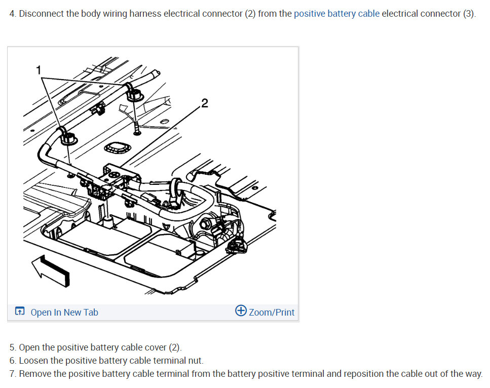

I just changed the low-pressure fuel pump on my vehicle listed above CX and now my vehicle won't turn over. At all! No cranking whatsoever. Just makes a clicking noise. Help please it's the only vehicle I have, and I am learning as I go because I can't afford to take it to a shop.
Sep 12, 2024 at 12:32 PM
  • 55,423 POSTS

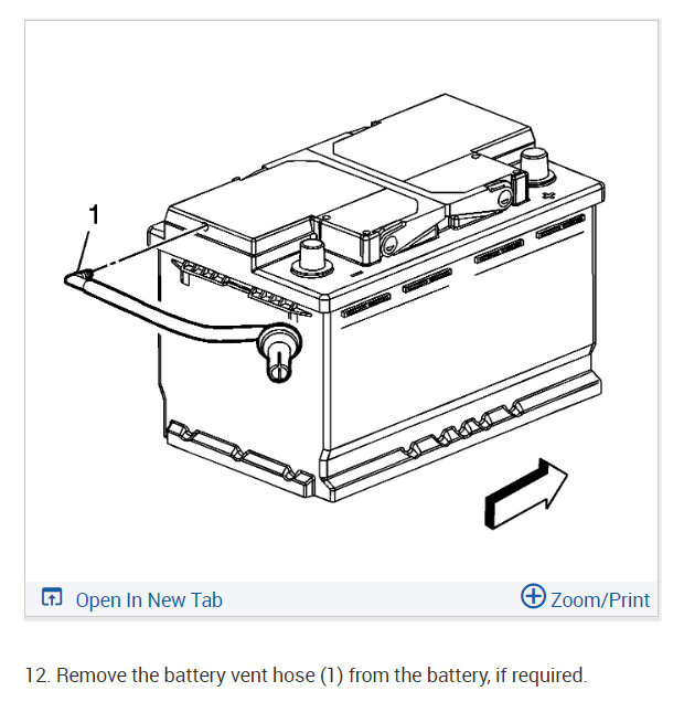

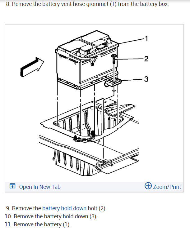

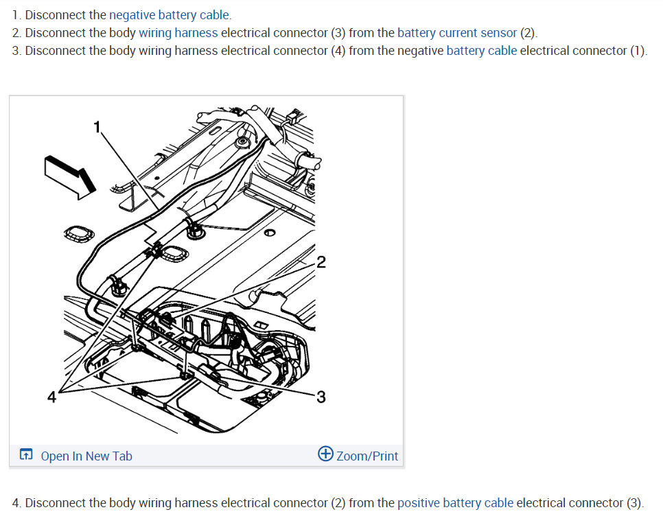

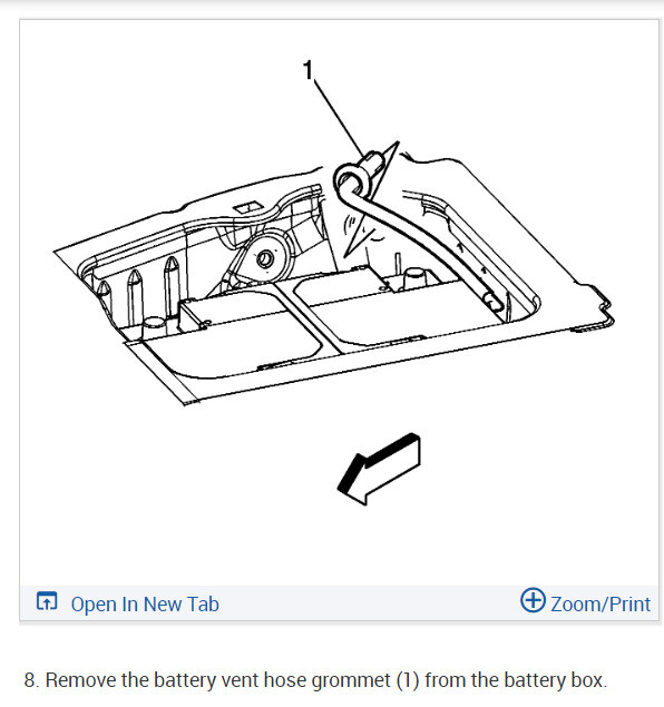

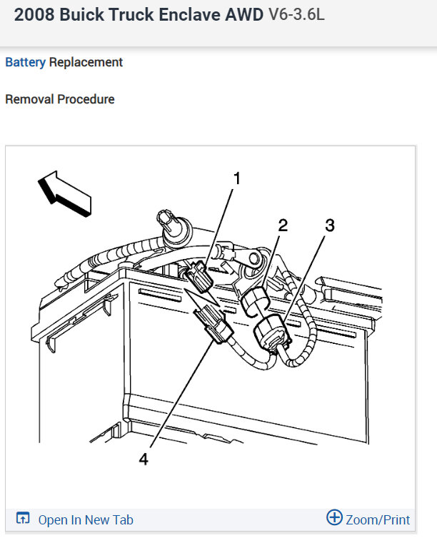

Yep, the battery sounds like it needs replacement, here is a video that will help you find out for sure:
https://youtu.be/6YRW8fyNudY?si=PcYklmYGplxdED0i
Here is how to change the battery out. Check out the images (below). Please upload pictures or videos in your response of any problems so we can see what to help you with.
