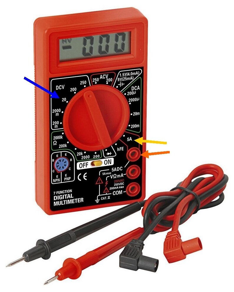

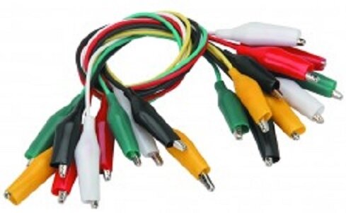

If you go to a Harbor Freight Tools store, the photo below shows the meter I use. The clip leads are shown in the second photo. They come in a pack of about ten. We only need three for the current drain test.
The problem with this test on cars as new as yours is the need for some computers to time out and go to sleep mode. That might take up to 30 minutes during which time up to three amps might be flowing out of the battery. If you insert the amp meter as I'll have you do later, that can blow its internal 2-amp fuse. Testing becomes valid after that 30 minutes.
The bigger problem is anything that is done to interrupt that current flow will reset the timer, then we have to wait again, for up to another 30 minutes. Interrupting the circuit includes turning the ignition switch to "off", disconnecting and reconnecting the battery's negative cable, moving the red meter lead from one jack to a different one, and even switching ranges on the meter. These will be solved with the third clip lead. The first two are just used to connect the meter's probes so you don't have to stand there and hold on to them.
