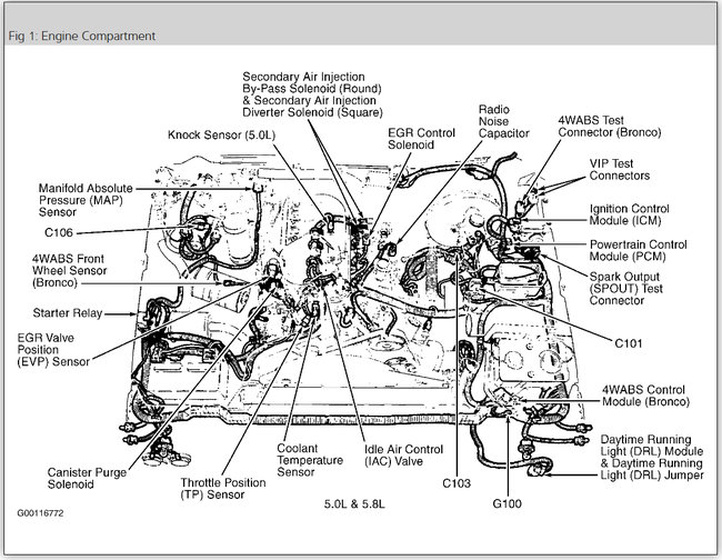

At first truck would stall while driving and not restart. Once restarted it would intermittent stall again. Now it starts but I put it in gear and stalled. Tried to start again but turns over and shuts off right away

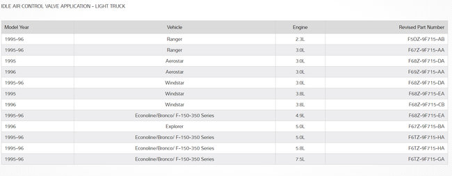

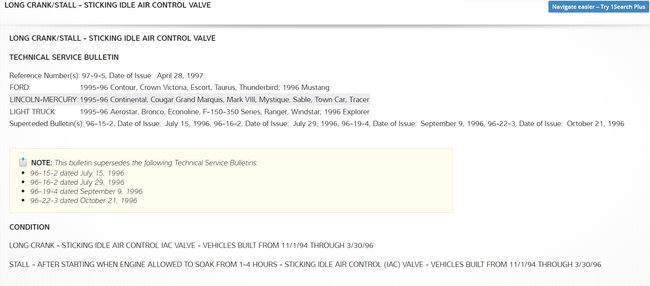

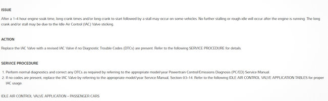

This sounds like it could be a problem with your idle air control valve (IAC). I have included a Technical Service Bulletin (TSB) along with the component location and a location diagram for you in the diagrams below. I hope this helps and let us know what you find out.
