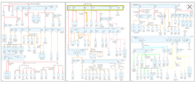

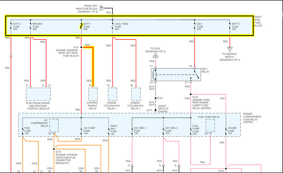

Okay,
I attached a power distribution diagram. I highlighted a 50 amp fuse. Can you verify power on both sides for me?
