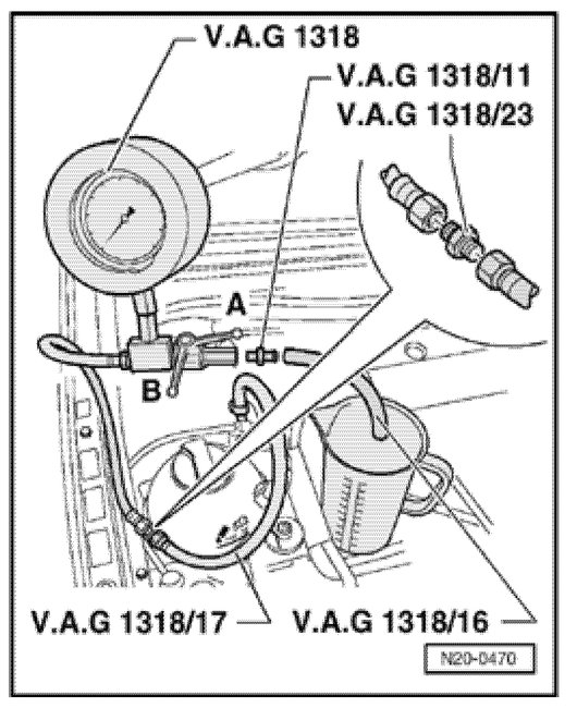

Have you checked to confirm fuel pressure is within spec? Also, was the check engine light staying on prior to this happening?
This could be a few different things. The idea that it won't take gas would lead me to check pressure first. Here is a link that shows how that is done. You will need a fuel pressure gauge, but most parts stores will lend you one.
Here are the directions specific to your vehicle. The attached pics correlate with the directions.

Fuel Pressure, Checking
Special tools, testers and auxiliary items required
^ High pressure fuel gauge
CAUTION!
Fuel supply line is under pressure! Wear protective goggles and protective clothing to prevent injuries and contact with skin. The fuel system is under pressure! Before opening the system, place rags around the connection area. Then release the pressure by carefully loosening the connection.

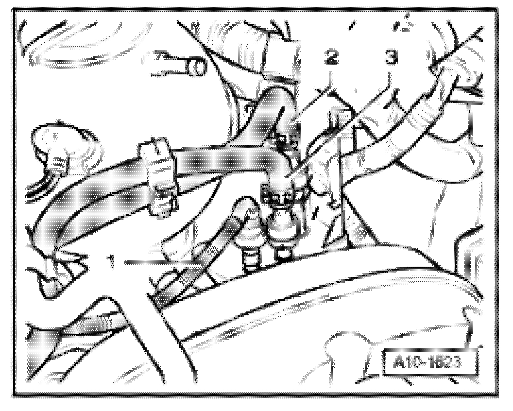

pic 1
- Remove the fuel supply line - 3 - and catch leaking fuel using a rag.

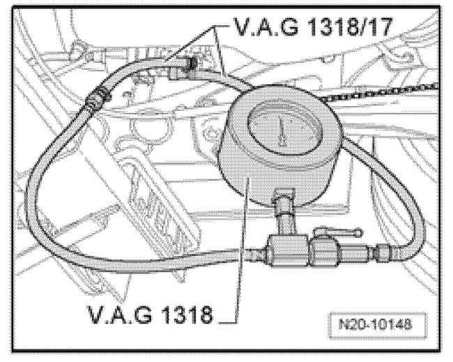

pic 2
- Install a High pressure fuel gauge in place of the fuel supply line.
- Open the shut-off valve of the High pressure fuel gauge.
- Switch the ignition on and off until the fuel pressure on no longer rises.
- Check the indicated fuel pressure on the High pressure fuel gauge.
Specified value: 3.5 to 5.0 bar.
If the fuel pressure is OK, check the residual pressure.

If specified value is not obtained:
- Check the fuel pressure in front of the fuel filter.
pic 3
- Connect a High pressure fuel gauge between the fuel filter and the fuel supply line.

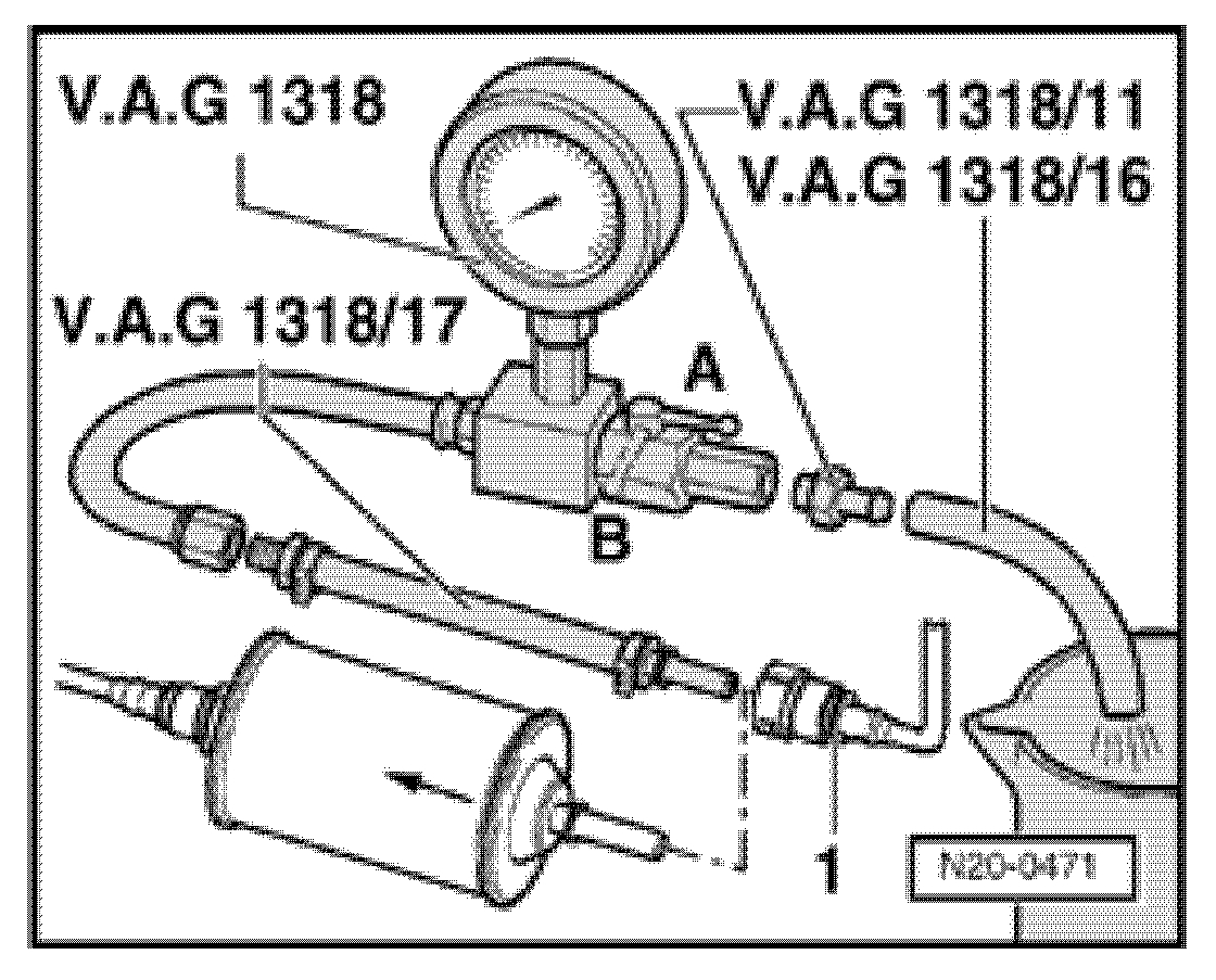

pic 4
- Slowly close the shut-off valve of the High pressure fuel gauge. Pressure must increase to min. 6.0 bar. If 6 bar is reached, open shut-off valve again immediately!
If the fuel pressure increases:
- The pressure relief valve in the fuel filter malfunctioning, replace the fuel filter.
If the fuel pressure does not increase:
- Replace the fuel pump.
