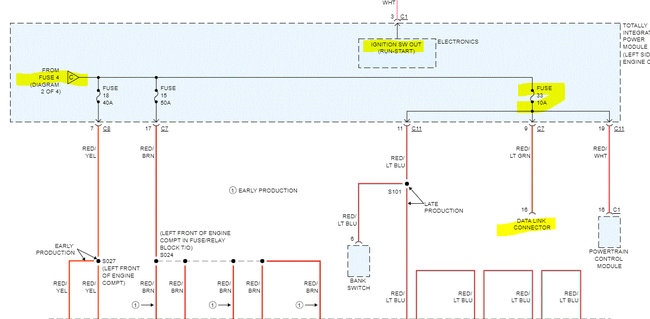

Replaced battery but still won't turn over. Lights come on. Tried using a computer to diagnose the problem but won't communicate with diagnostic reader. Why won't it start?
Feb 18, 2022 at 11:56 PM
  • 110,244 POSTS
When you turn the key to the start position, do you hear anything? For example, is there a click or anything that you notice?

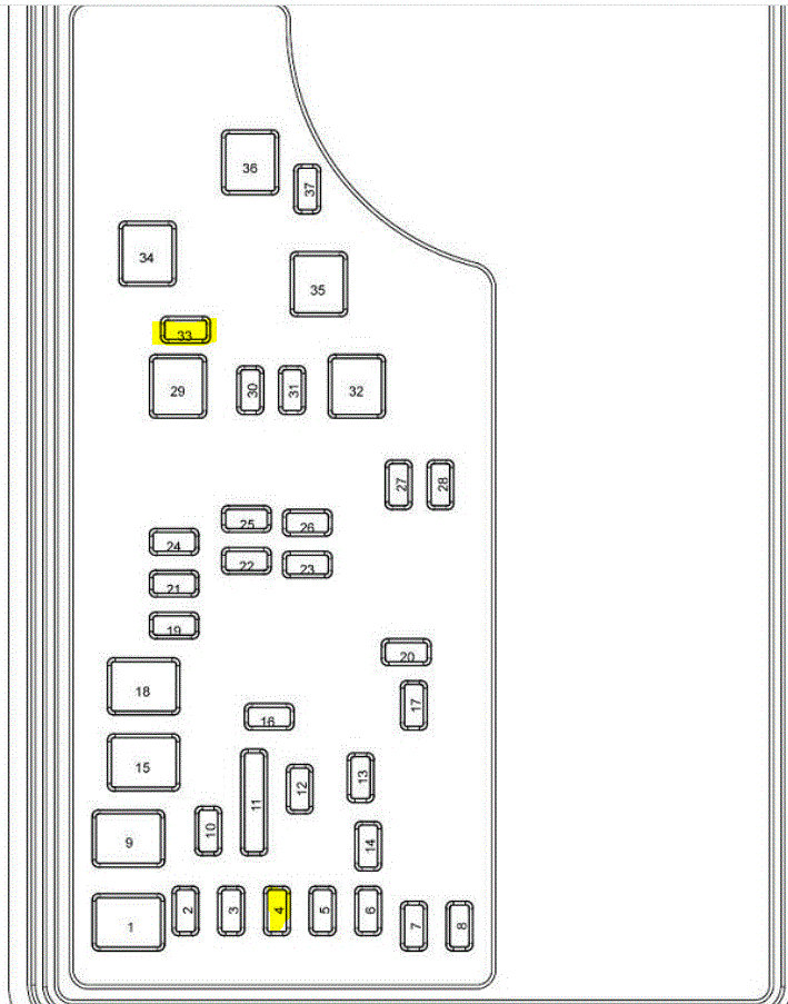

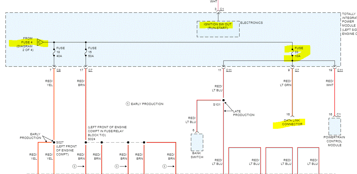

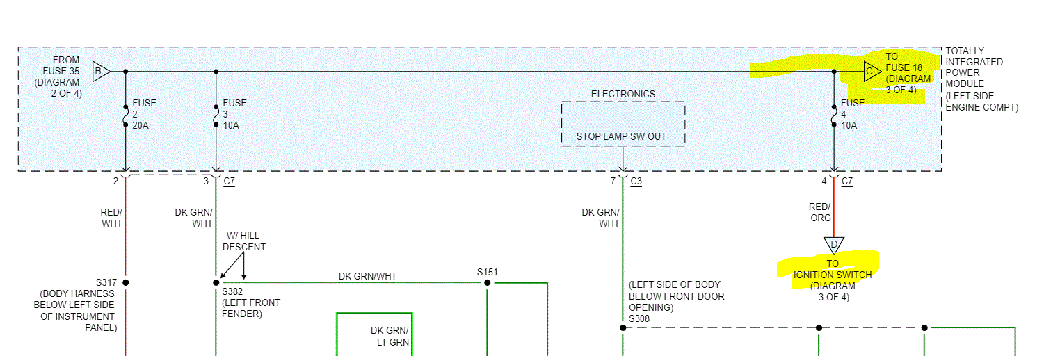

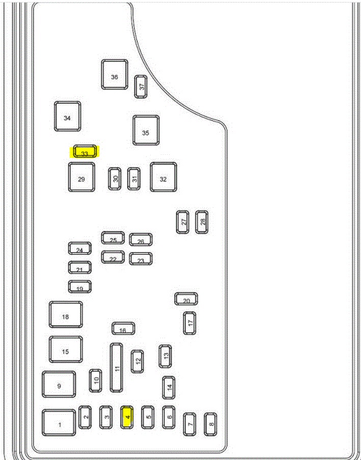

Next, the code reader is another story that may be associated with this. If you look below, I attached two pics. I need to know if the fuses highlighted, 4 and 33, are good. In addition, I need to know if there is power to them. If they are good, it is very important that I know if there is power to them. Here is a link you may find helpful:
The fuses are located in the under-hood fuse box. I highlighted them in pic 3. Note, also check fuse 35 in the same box. I didn't highlight it, but it is to the right of 33 and a heavy-duty fuse.
Let me know what you find,
