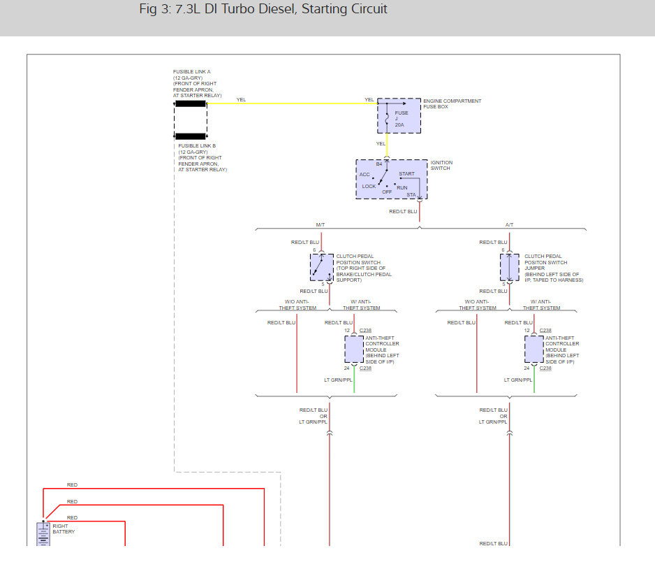

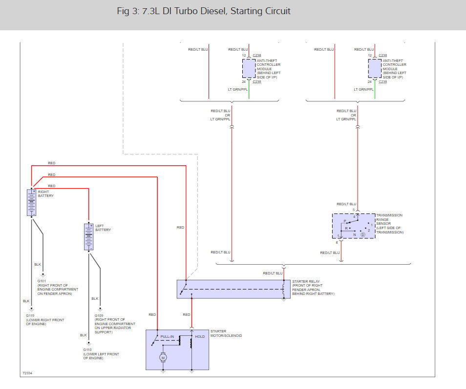

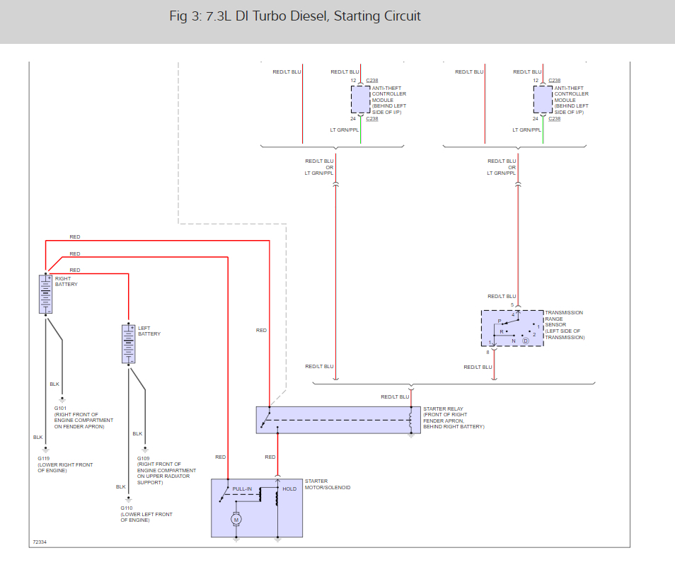

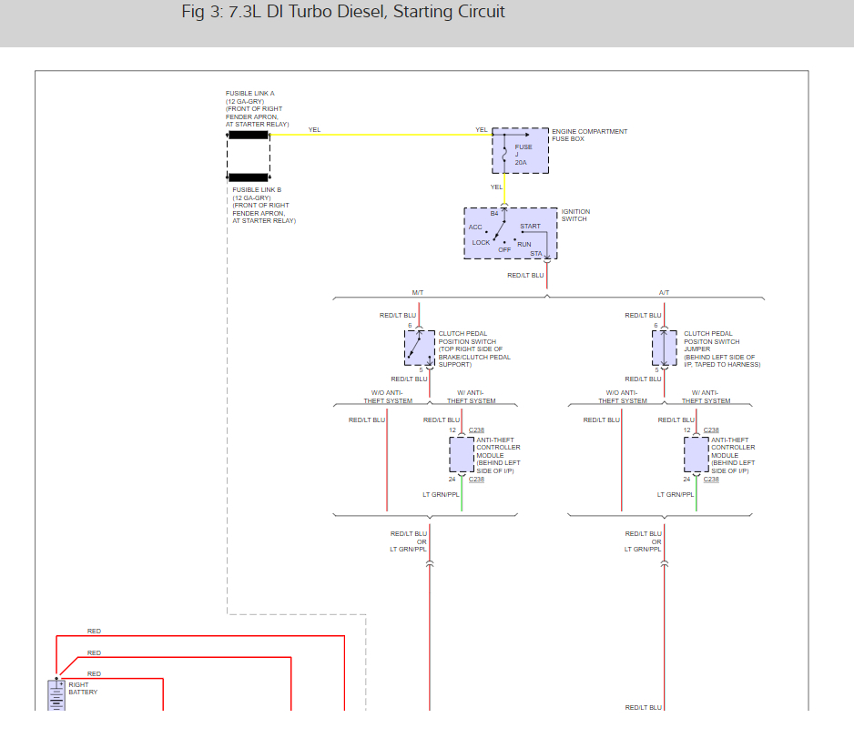

Fender solenoid and starter both brand new and still clicks at solenoid on fender wont turn over. however, you can jump the starter under pick up with a screwdriver and it will fire up and run great. please help
May 3, 2019 at 4:46 AM
  • 55,721 POSTS
It sounds like you have a neutral safety switch that can be out but to be sure lets use this guide below and the starter wiring diagrams to see where you are loosing power.
Check out the diagrams (Below). Please let us know what you find. We are interested to see what it is.
