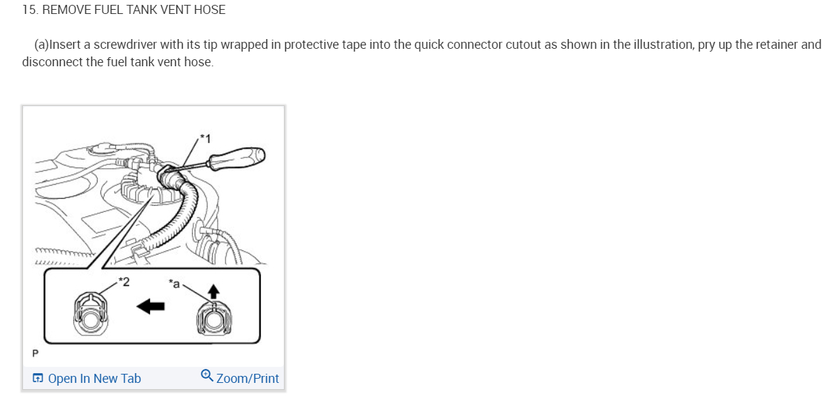

On my 2kd engine I am not getting diesel from my rail to my injectors. However, diesel from pump to my rail is there.

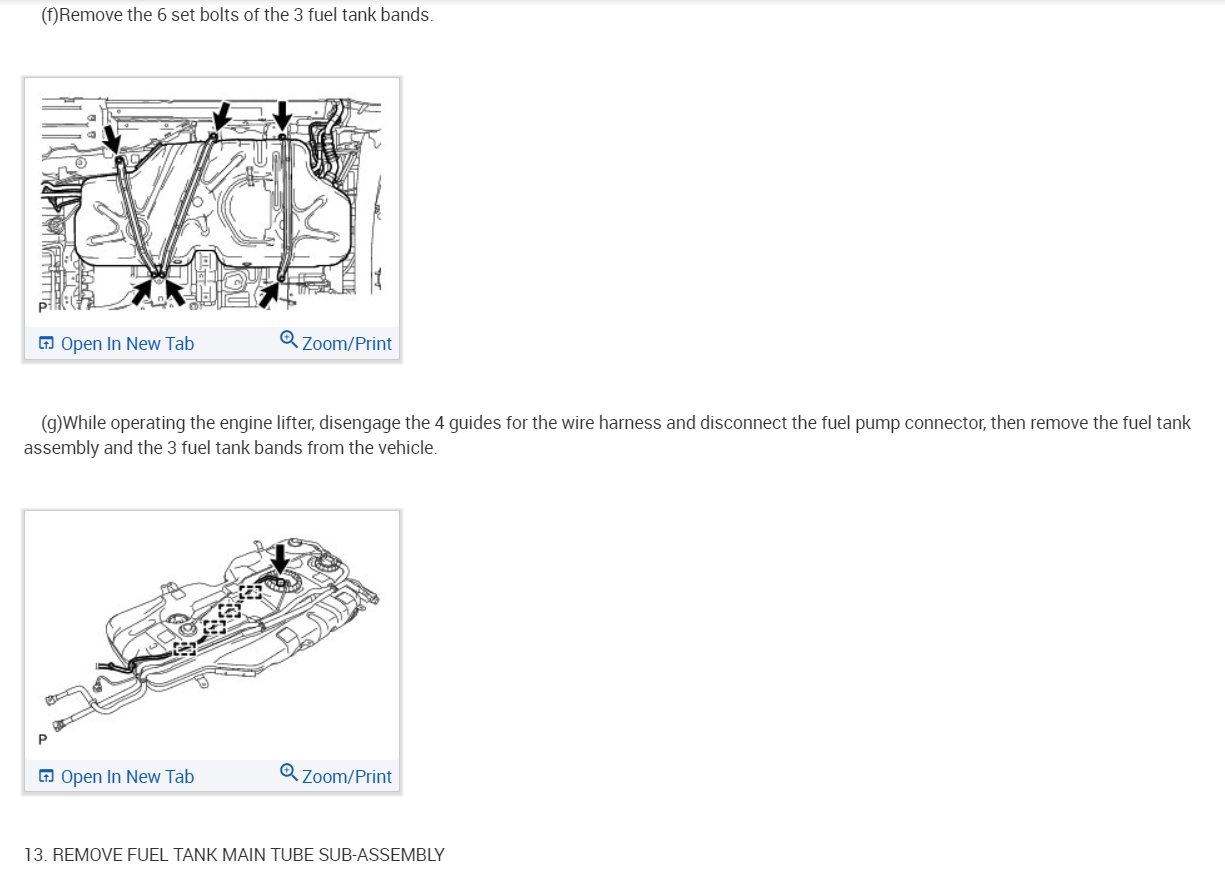

Hi Mr Ken I cleaned the throttle but still same problem then again I tried using a high pressure pump and the vehicle could rev up but when I remove the high pressure pump I loose my revs could this mean I have to change my diesel pump
Oct 23, 2018 at 4:18 PM

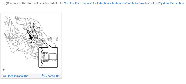

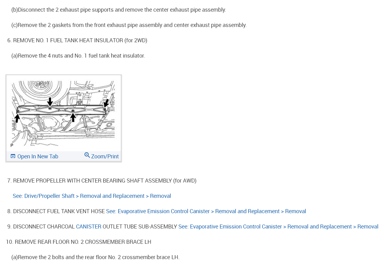

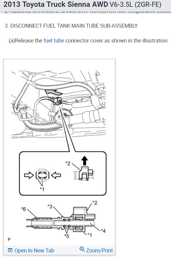

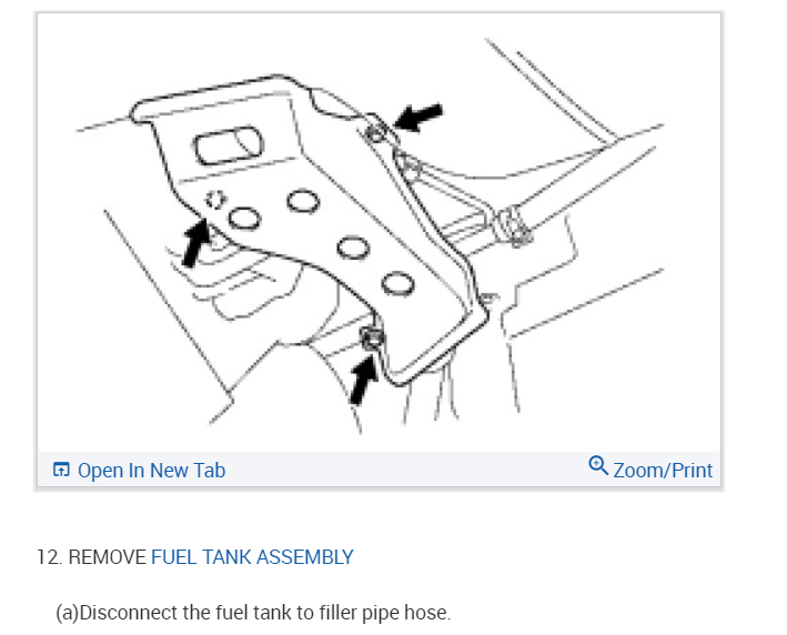

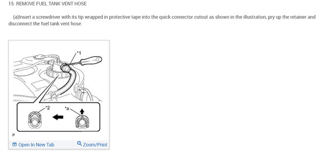

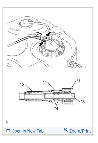

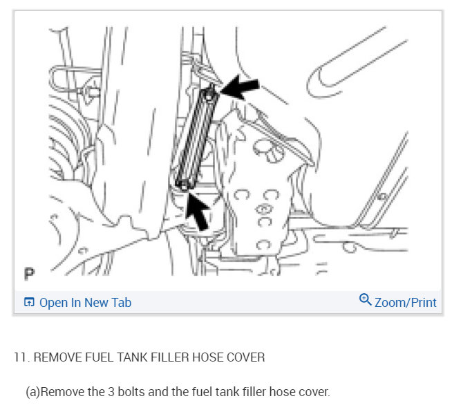

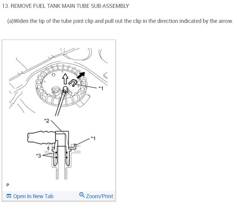

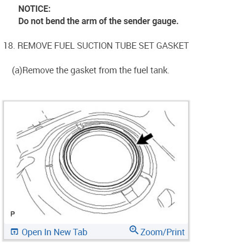

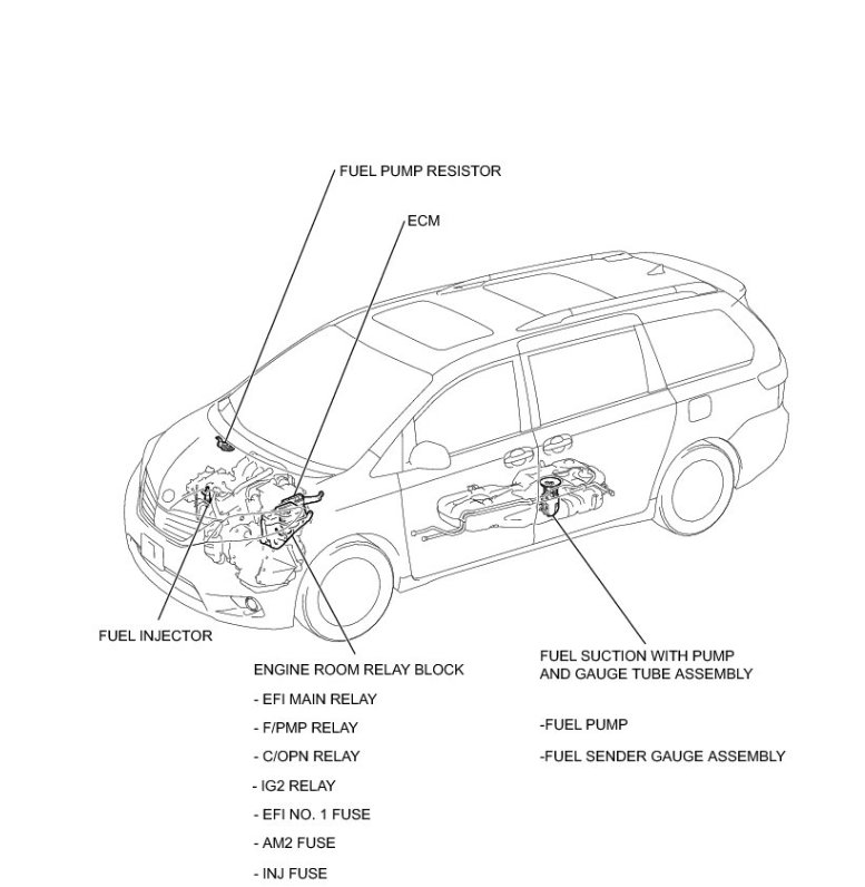

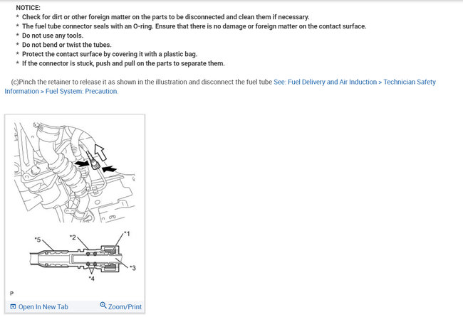

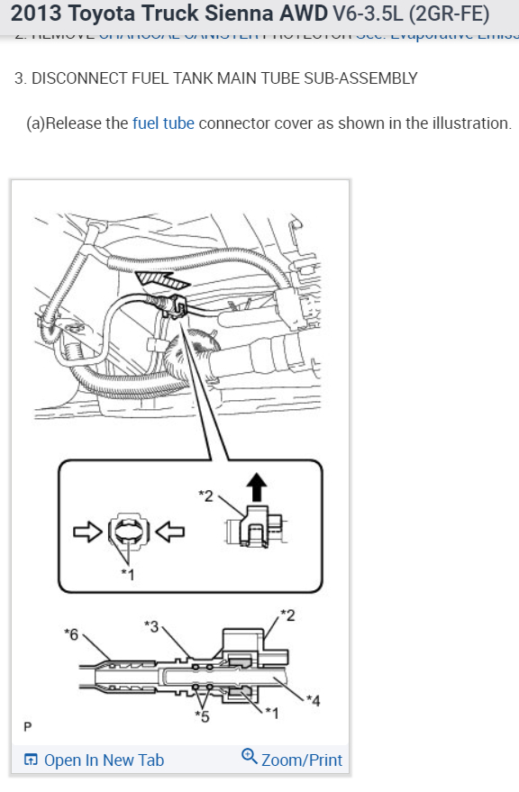

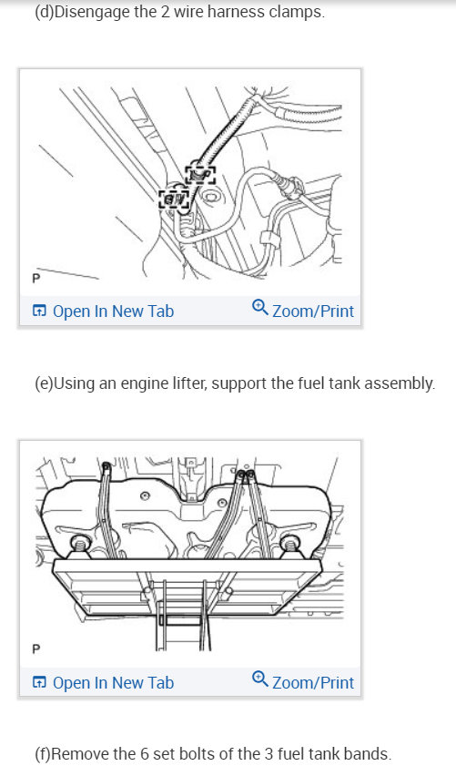

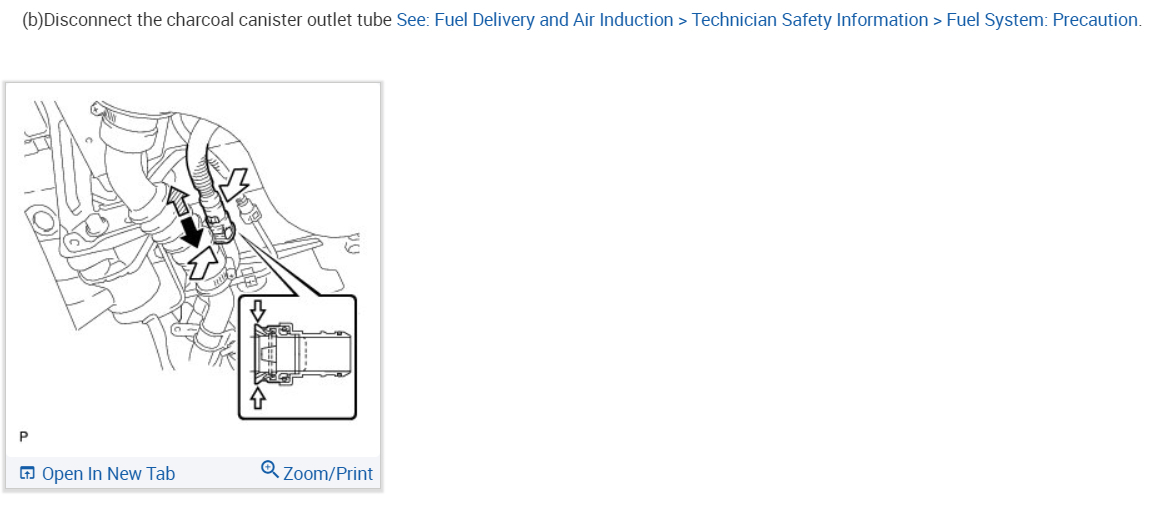

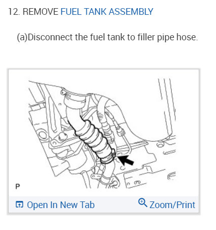

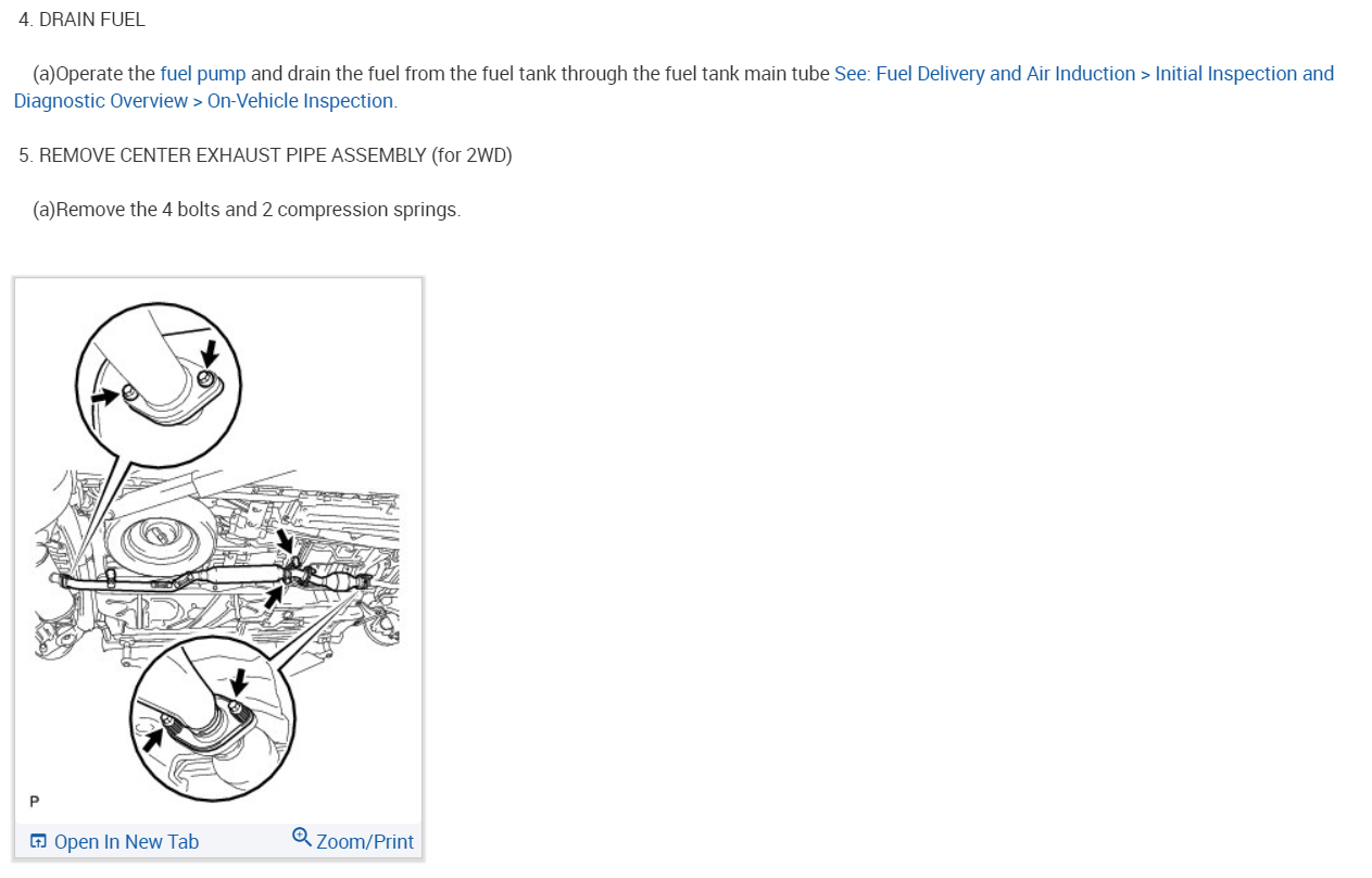

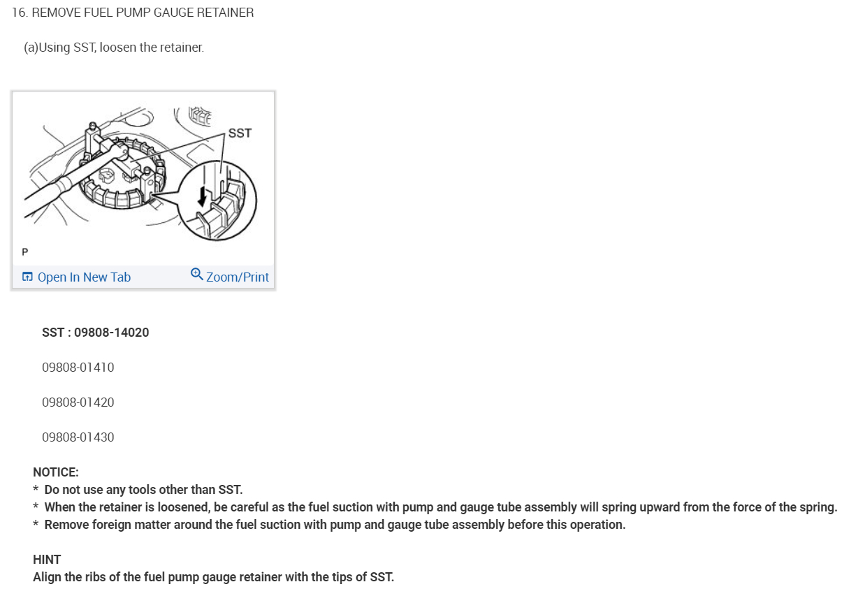

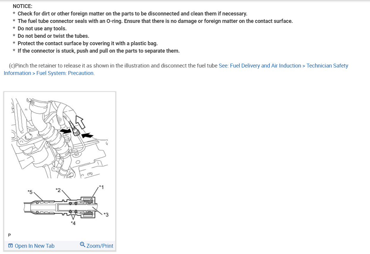

  • 55,721 POSTS
Yep it sounds like the primary pump in the tank is bad here are diagrams to help you change it out. Check out the diagrams (Below). Please let us know what happens.
