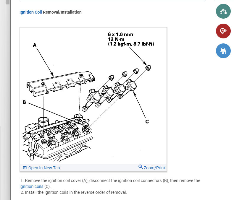

If that is the case, we need to make sure the coils are fully connected and not misfiring.
Here is a guide that will help with this:
However, if you have the old coils, I would suggest you swap them back on one at a time and see if any of them cause the issue to go away.
