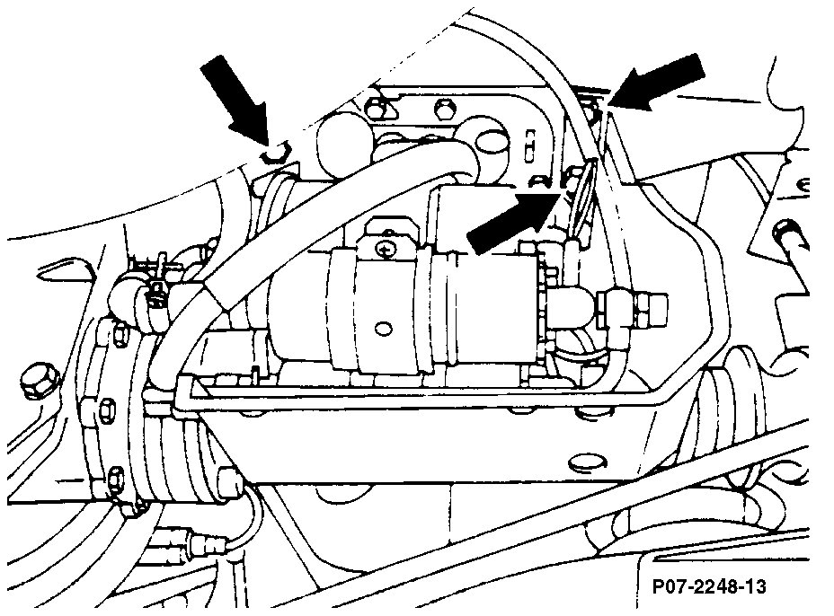

REPLACING FUEL FILTER
See picture 1
- Remove protective cover by removing mounting bolts (arrows).

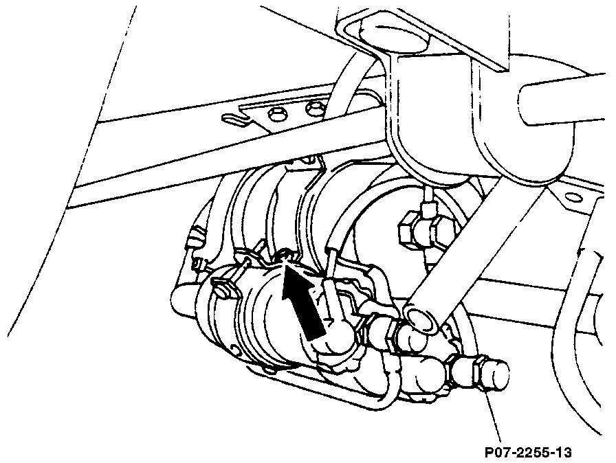

See picture 2
- Disconnect fuel line and fuel hose.
- Loosen mounting screws (arrow) pivot holder down and remove filter.
- Install new fuel filter and plastic sleeve in flow direction.
- Sleeve should project on both sides of the holder since contact corrosion may occur if there is direct contact with the holder.
- Replace plastic sleeve, if necessary.
- Reinstall protective cover.
_______________________________
