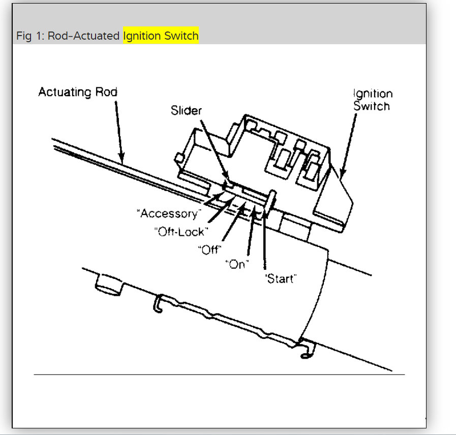

I turn key begins to crank but won't turn over. so turn key off and it continues cranking until I disconnect battery.
Jun 29, 2019 at 8:50 AM
SCGRANTURISMO
  • 4,897 POSTS

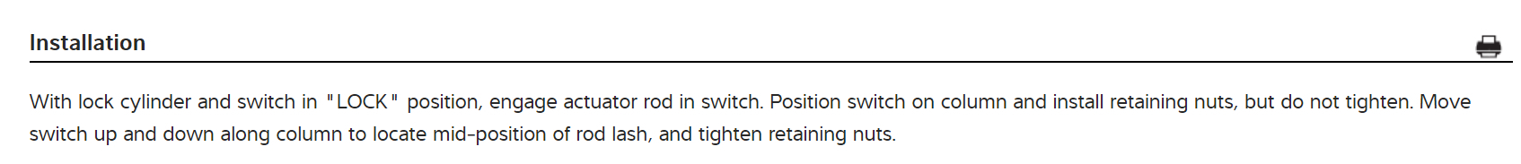

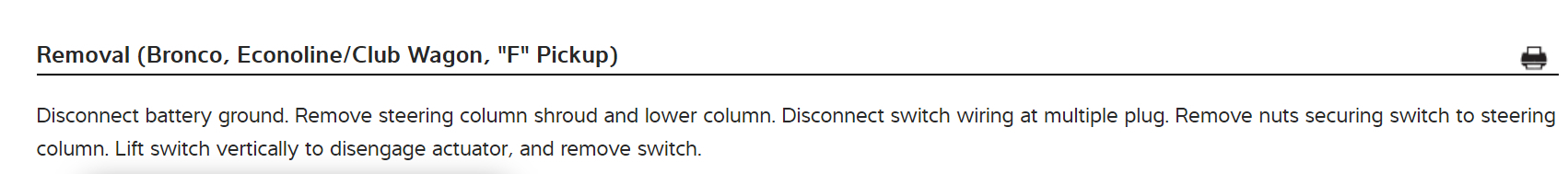

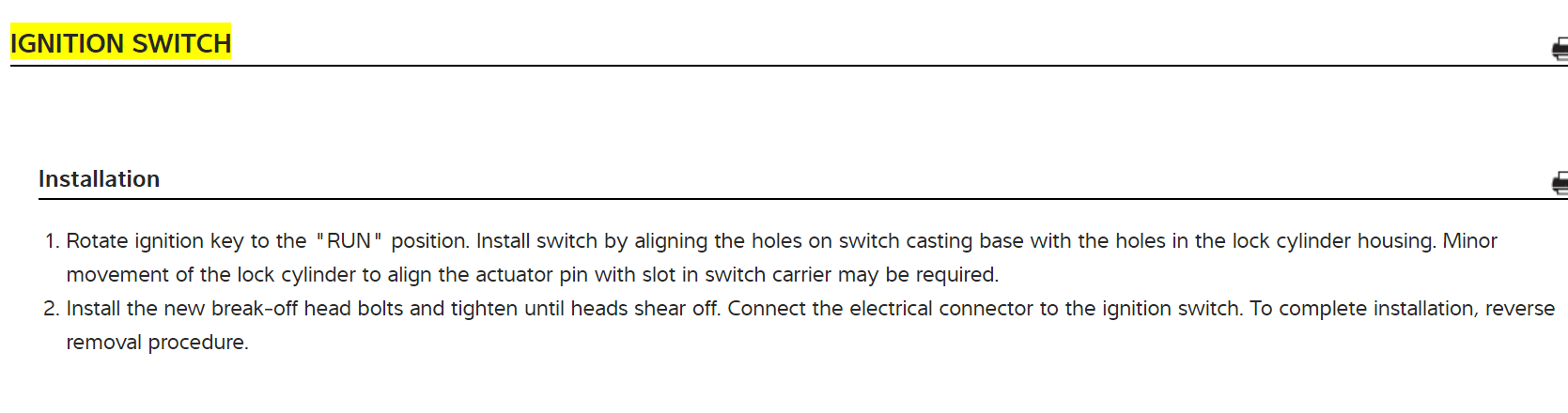

This is a problem with your vehicle's ignition switch and it should be replaced. In the diagrams down below I have included the instructions on how to replace the ignition switch in your vehicle. Please go through these instructions and get back to us with what you are able to find out.
