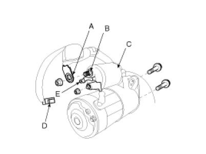

Make a zipping sound when I try to start. But no start up not even the the normal start sound.

Based on your descriptions, the solenoid on the starter has failed. The solenoid Bendix engages the ring gear on the starter with the car's flywheel. Now, either the ring gear isn't extending to reach the flywheel or the teeth are bad on one or the other.
With that in mind, you need to remove the starter and inspect it. Most parts stores will bench test the starter to determine of the Bendix isn't engaging the ring gear.

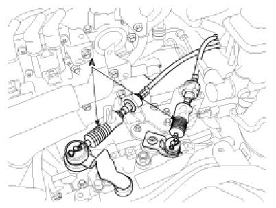

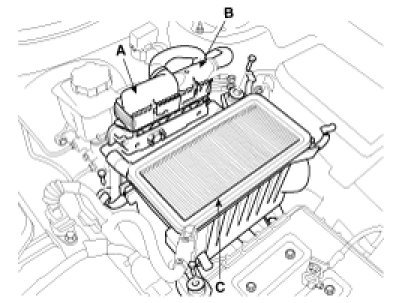

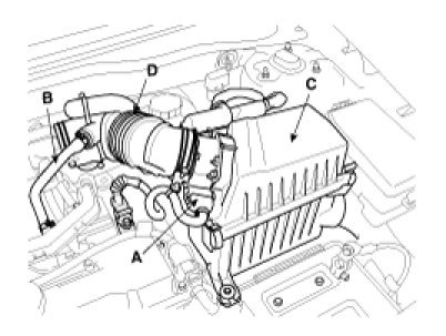

Here are the directions for removing the starter. Make sure when you disconnect the wires to it that you mark them to ensure they are put back the same way. The attached pictures correlate with these directions.

2. Remove the air cleaner assembly.
3. Remove the shift cable and bracket. (M/T)
4. Disconnect the starter cable (A) from the B terminal (B) on the solenoid (C), then disconnect the connector (D) from the S terminal (E).
5. Remove the 2 bolts holding the starter, then remove the starter.
