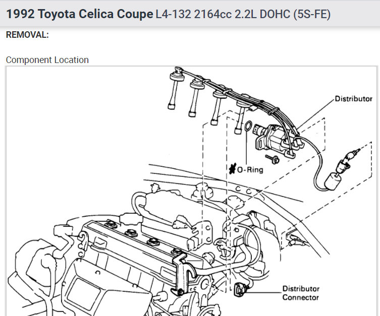

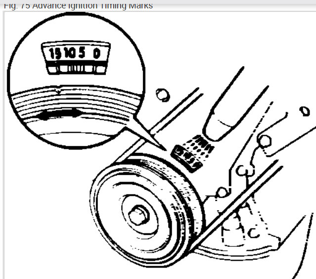

Turns over won't start ,told it was crankshaft positioning sensor.
Oct 12, 2020 at 6:38 AM
DANNY L
  • 5,648 POSTS
Hello, I'm Danny.

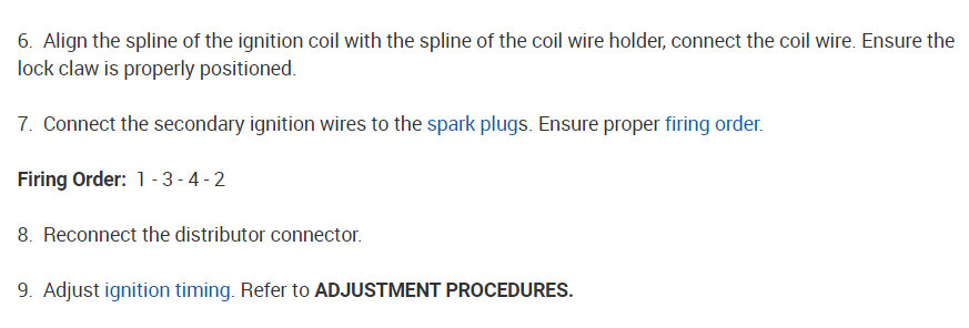

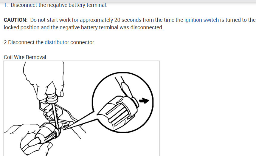

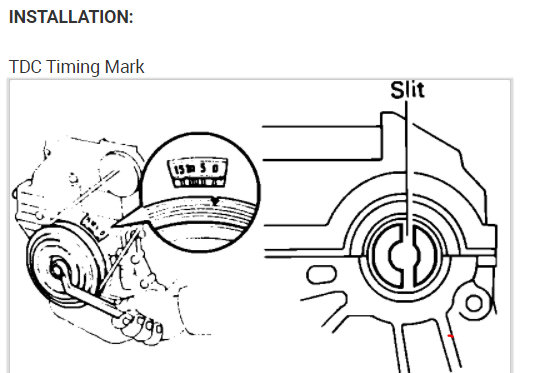

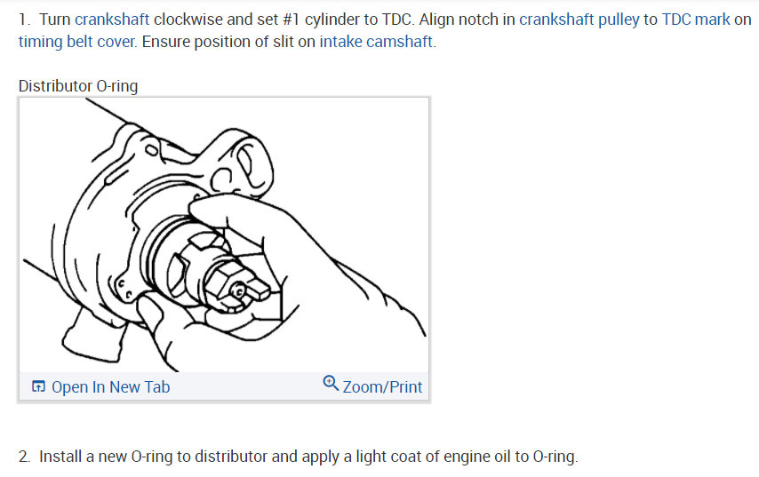

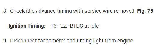

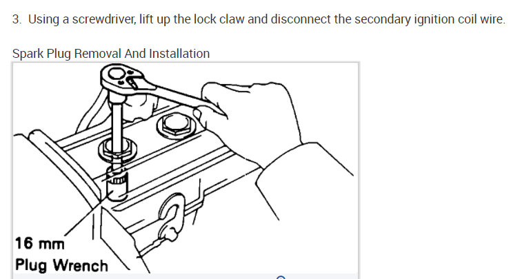

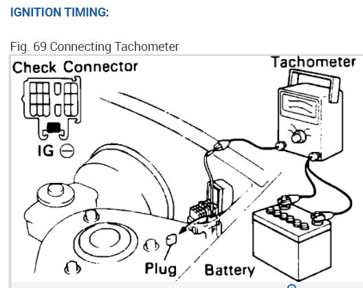

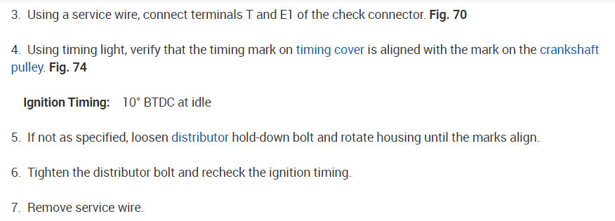

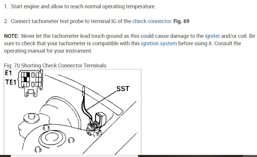

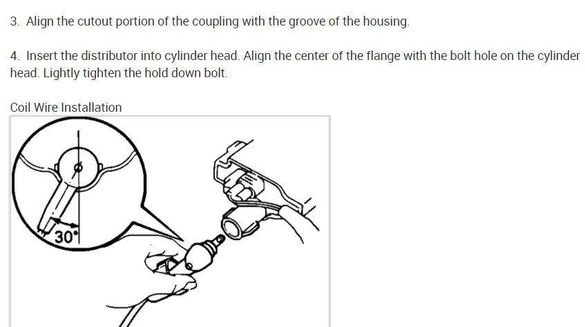

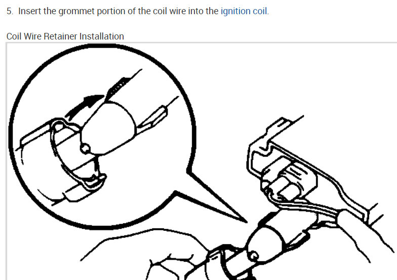

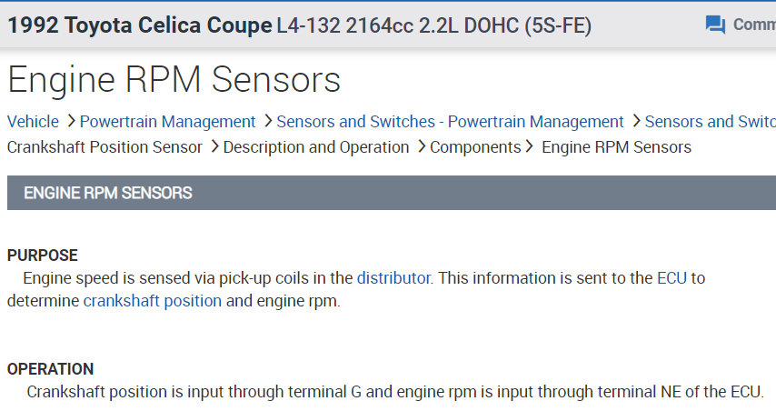

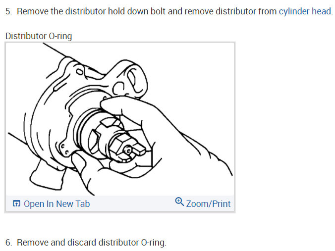

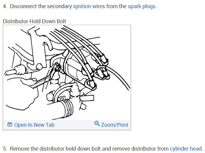

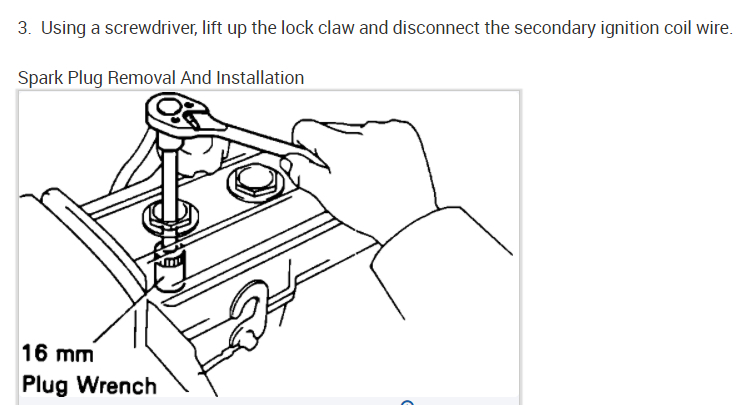

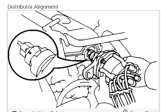

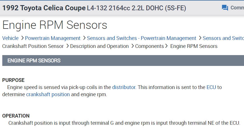

The crankshaft position sensor is a different style for your car. Engine speed is determined by pick up coils that are built into your ignition distributor. I've attached picture steps below for distributor removal and replacement.

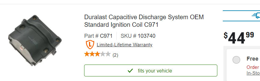

So what your are telling me is it's the distributor that's bad ?

If the symptom is your car is not starting there is an ignition coil located in the distributor underneath the distributor cap. I've attached a picture below with a part number and price from AutoZone auto part stores. Your vehicle does not have a conventional crankshaft position sensor. Hope this helps and let me know if you have any further questions about this issue. Hope this helps and thanks again for using 2CarPros.

Thank you for your advice. the person I bought car from changed the distributor and had the plug wires in the wrong order. I corrected them and it starts right up now. thanks again
