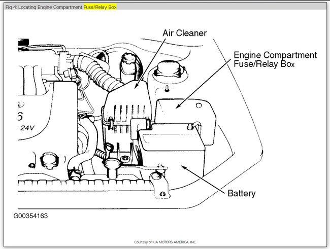

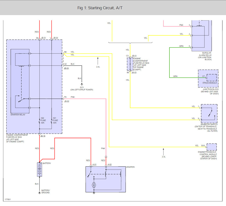

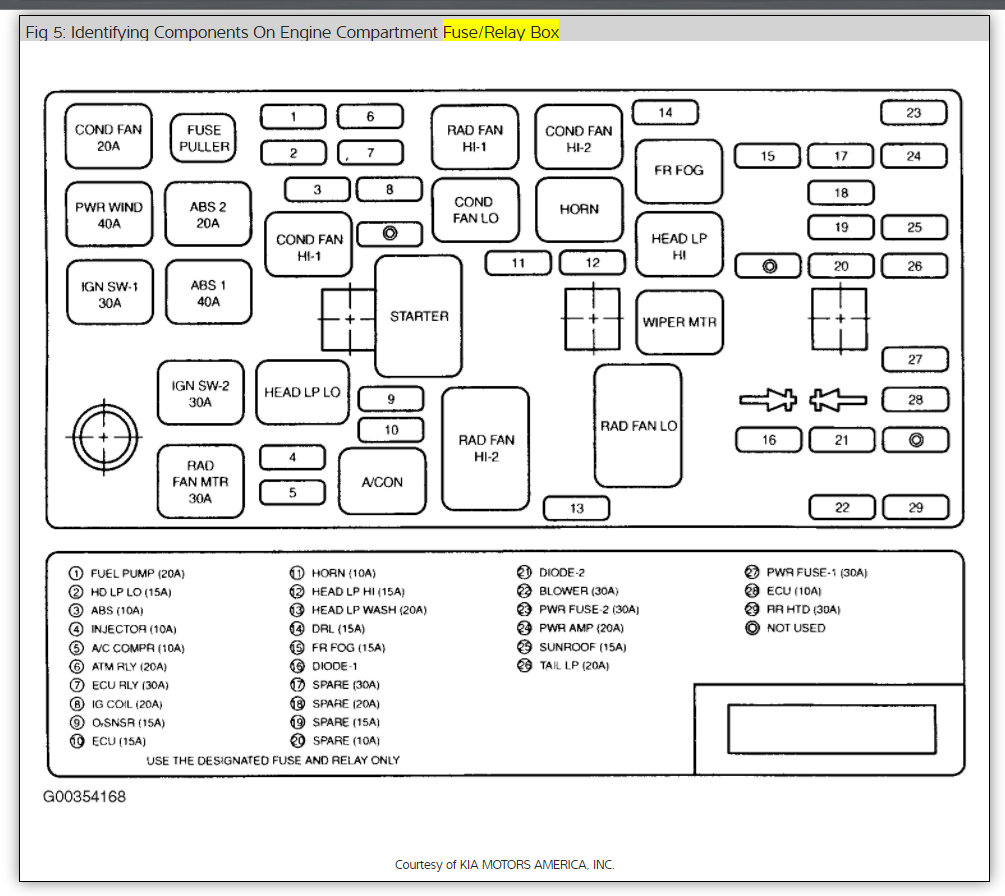

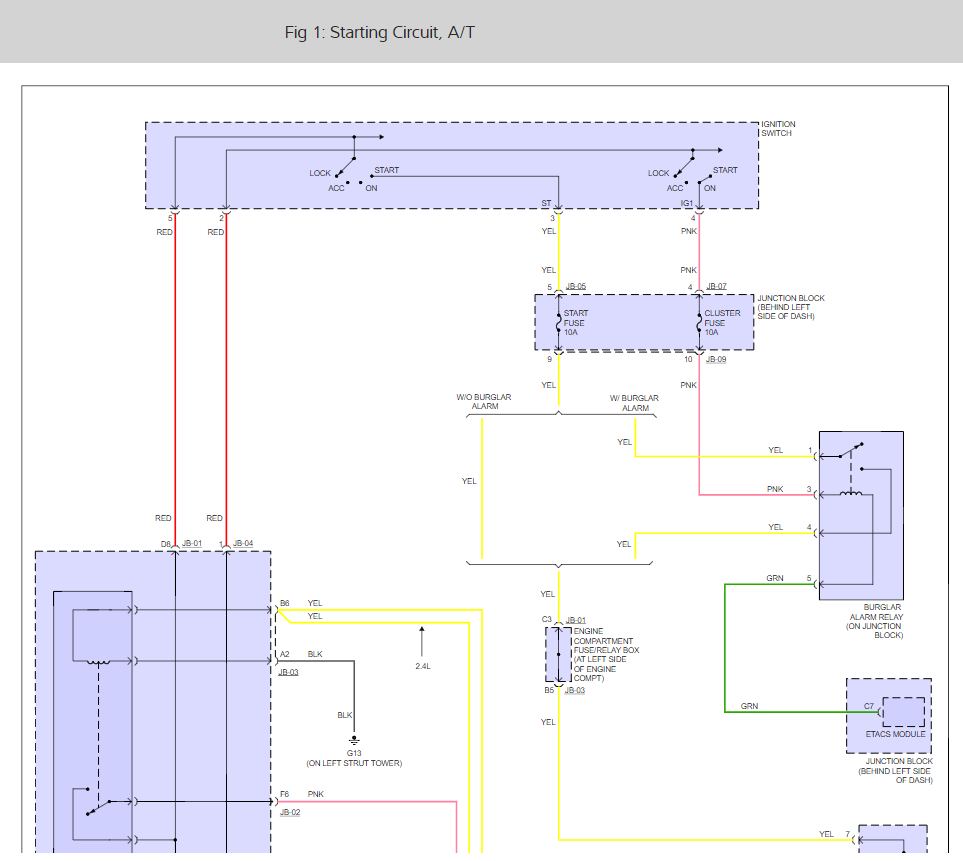

When I turn the key to start the car it does nothing. There is no sound made, not even a clicking sound, as if nothing is connected. I replaced the starter and solenoid and battery. The car is front wheel drive and it has been sitting for a long time because the starter stopped working.
Aug 7, 2017 at 2:45 AM
  • 55,743 POSTS
It sounds like the starter relay is not working. Here is a guide and some diagrams (Below) so you can run a simple test to get the problem fixed.
and
Please run this test and get back to us we are interested to see what it is.
