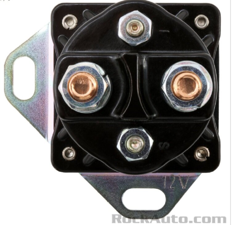

If I turn the ignition to "start" the starter is inoperable. If I leave the switch in the run position and jump across the two studs on the starter solenoid (on the passenger side fender) the starter engages normally, and the engine starts and runs fine. Is there an additional starter relay (NAPA sells one for this vehicle), where is it located? That and a bad fusible link is all the possibilities left, I think.

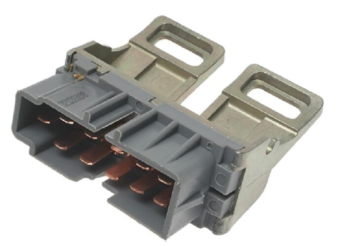

The first thing to check is if the ignition switch shifted. It's on the steering column and is adjustable. The photo shows the two slotted mounting holes. It's somewhat common for them to work loose and move under spring pressure, then the key cylinder won't turn quite far enough for the starter circuit to engage. The two mounting screws commonly have 5/16" hex heads.

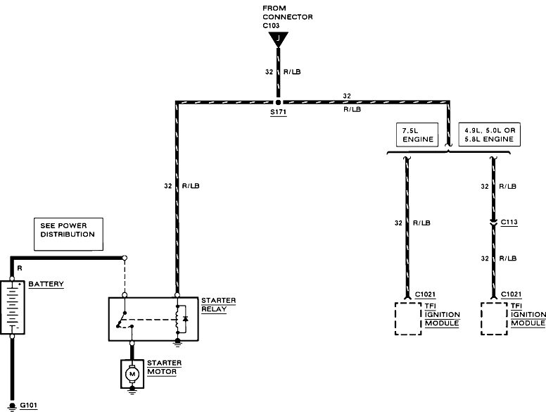

Next, have a helper turn the ignition switch to "crank" while you check for 12 volts on the red / light blue wire on the starter relay. Use an old-style test light if possible as they can be more accurate in this type of circuit than a voltmeter. If that 12 volts shows up, the relay is the likely suspect.
As a further test, or if you don't have a helper, use a small jumper wire to connect 12 volts to that smaller terminal with the red / light blue wire. That should make the relay engage.

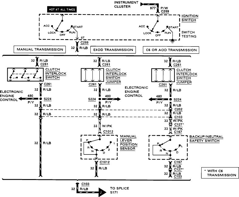

If you don't get 12 volts on the red / light blue wire when the ignition switch is in "crank", its adjustment and the clutch switch become the better suspects. Let me know what you find, then we'll figure out where to go next.
