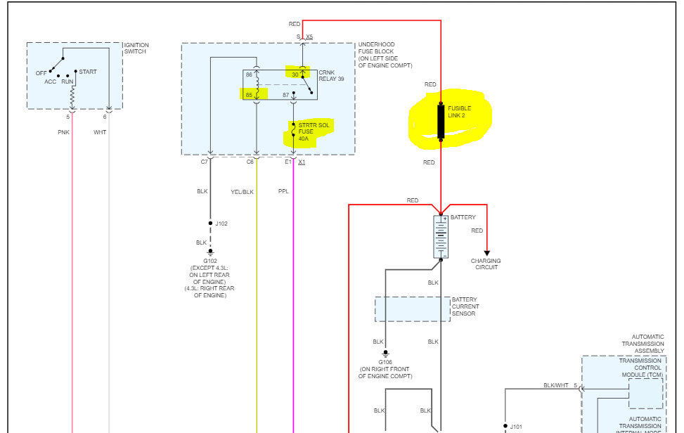

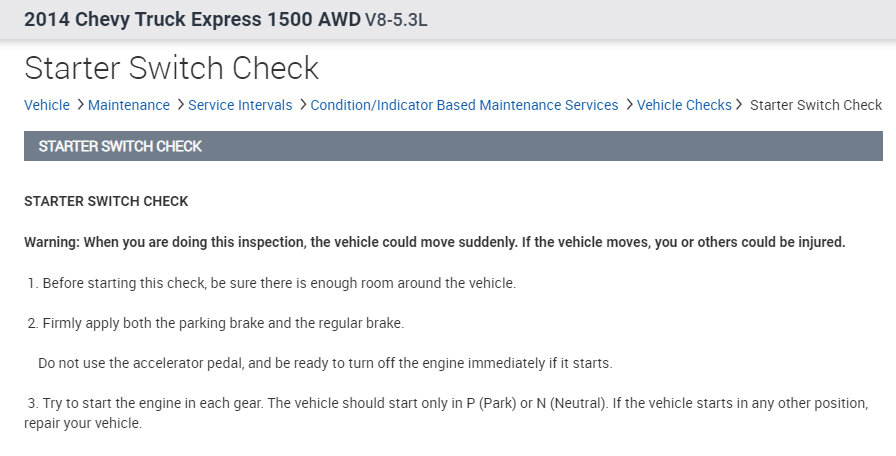

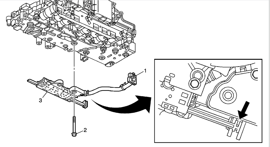

It could be related to the park neutral position switch (PNP). To confirm, try the test below in pic 1.
Next, when you try starting it, do you hear anything? Is the gear indicator working properly?
I attached the wiring schematic below, so you have a reference. If the shifter seems to be indicating the correct gears, the PNP is in the transmission housing.

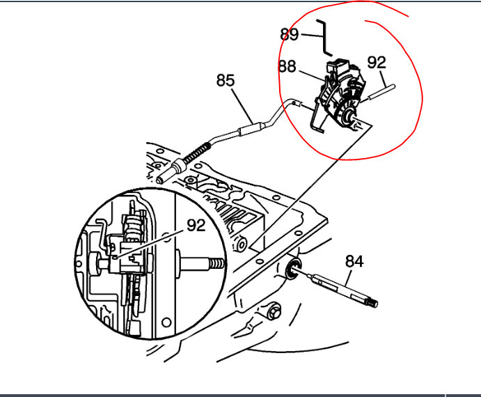

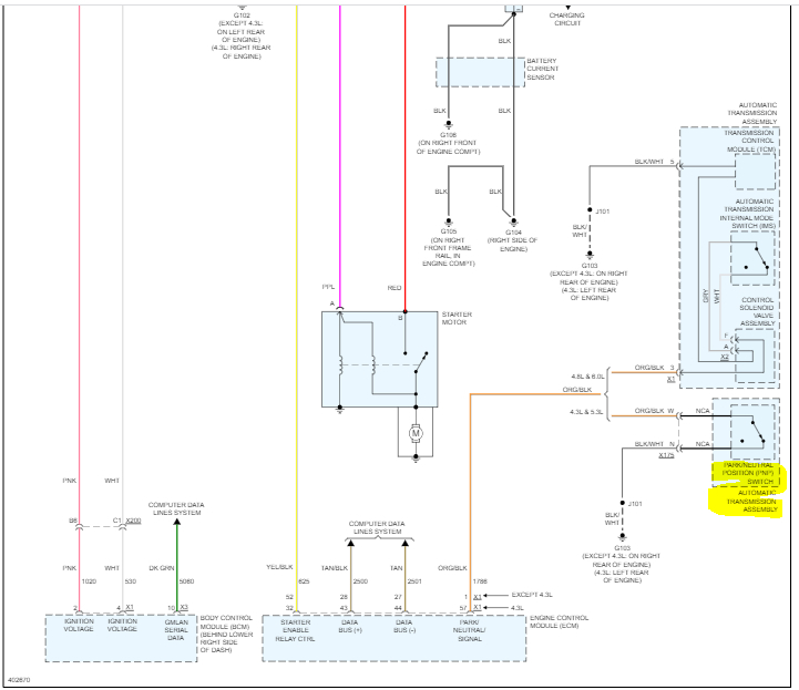

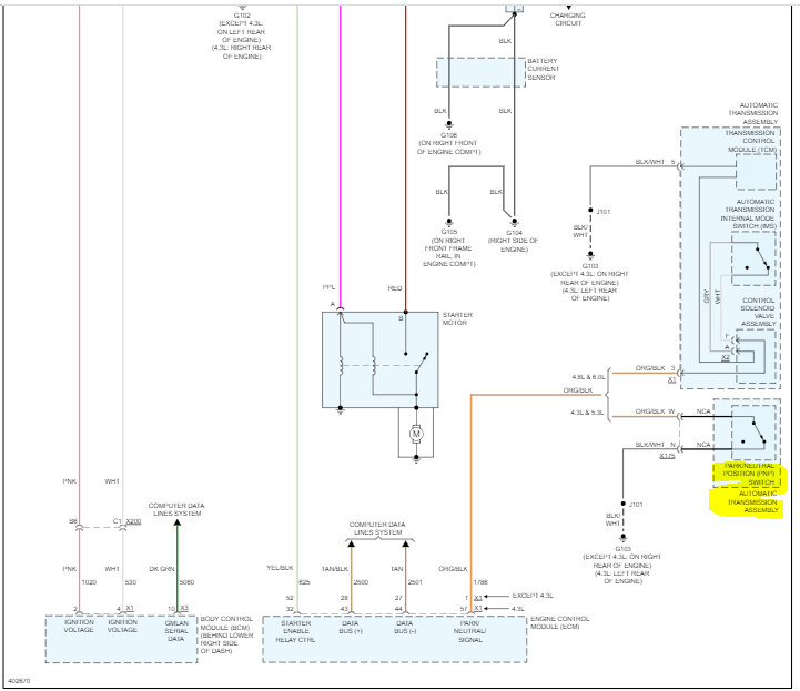

I just want to make sure the PNP is the issue. It is part of the transmission range sensor and is located inside the transmission. Also, there are two different transmissions that were offered on this vehicle.
If you look at pics 4 and 5, I highlighted the switch for both types of transmissions. Pic 4 is the 4L60-E and pic 5 is the 6L90, which isn't as common.

Today I tried starting the van as you suggested, with the brakes on in each gear setting, park, neutral, reverse, and each gear. nothing, no noticeable sounds, it didn't crank.
I put the van in reverse with the key "on" to see if the reverse lights came on, they did.

You may have a starter that is bad. If this happens again, at the starter you will see a heavy gauge wire from the battery. There will be a smaller one as well. Have a helper turn the ley to the start position while you check for voltage at the smaller wire. If you do have power, I would replace the starter motor.

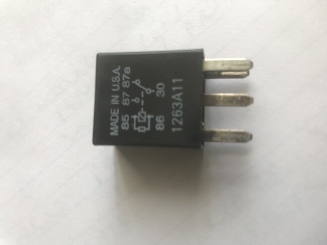

Yesterday I thought I'd check the fuses to make sure it's not something minor before I take it to the dealer, and although I've done it before I swapped the crank relay with the fuel pump relay (they are identical, see the attached photo) and the van started, first time no hesitation. Then I switched them back and the van started again.
Something changed and the only thing I did besides removing the cover off the fuse panel was I swap the relays. maybe there was a back contact, but the relay socket feels firm. and I tested the start relay with a 12 vdc battery and continuity tester and it closed 200 times, w/o fail. Nothing obvious, except the van starts now.
I installed a new starter relay, and everything runs great. But I still don't know why the van died at a red light, here's what happened at the red light:
