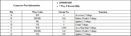

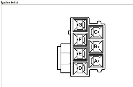

The battery is fully charged, neutral safety switch replaced, gas in the tank and it still wont crank. Checked all possible fuses and they all appear to be good. Ideas?
Nov 8, 2010 at 5:42 PM
BMRFIXIT
  • 19,053 POSTS
Remove steering cover to access to the wiring harness and use a test light or volt meter check red/black wires for battery positive

also the steering wheel wont lock
Nov 9, 2010 at 9:26 AM
BMRFIXIT
  • 19,053 POSTS
LETS CHECK THE IGNITION SWITCH OPERATION
CHECK AND TEST THE WIRES AS ABOVE
LET ME KNOW
