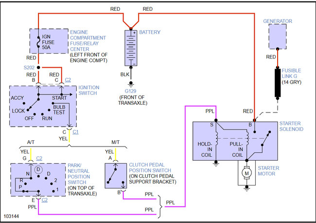

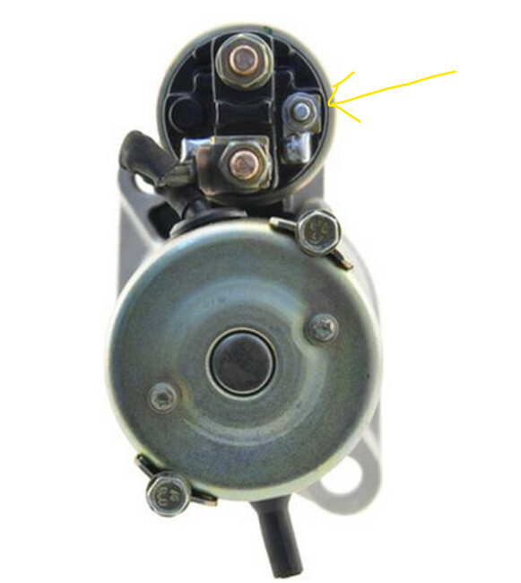

My question involves the starter signal wire. I am guessing that it attaches to the small stud on the solenoid. Not the bigger stud that the positive cable attaches to.

Yes, you are correct. It should be a thin purple wire. I have included some images for you.
