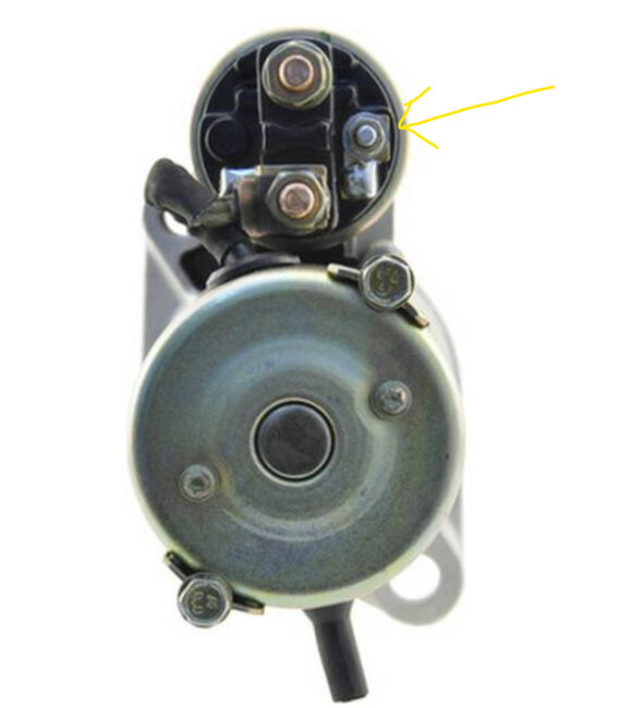

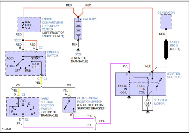

My question involves the starter signal wire. I am guessing that it attaches to the small stud on the solenoid. Not the bigger stud that the positive cable attaches to.
Jul 5, 2023 at 2:21 PM
BRENDON S
  • 653 POSTS
Hello JOHN FULLILOVE,
Yes, you are correct. It should be a thin purple wire. I have included some images for you.
