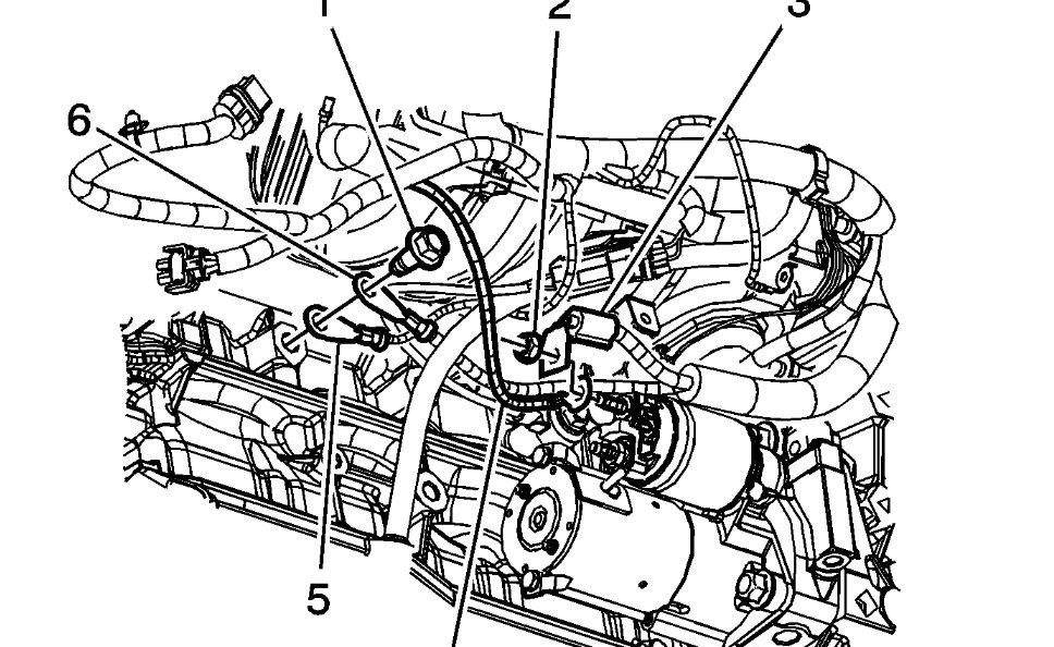

Car has two wires and a plug in harness. Can you get them installed wrong when changing the starter out?
Nov 10, 2018 at 9:41 AM
Good afternoon.
The heavy thick cable goes to the big post on the solenoid.
The little wire goes on the little stud on the solenoid.
Nov 10, 2018 at 1:17 PM
MADJACK421
Thank you. Someone is telling me I crossed them up and with the end connections the sizes they are you cannot cross them. Am I correct?
Nov 10, 2018 at 1:38 PM
Correct.
