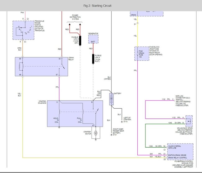

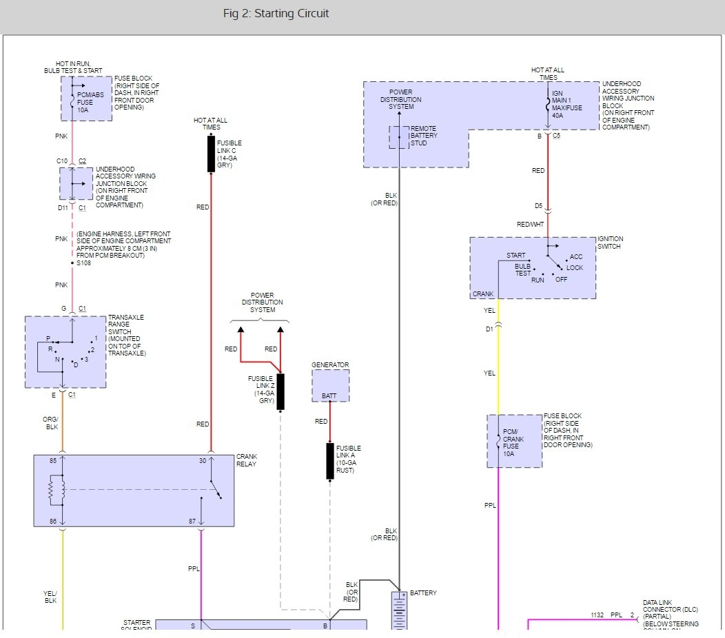

Problems with reminder where wires go?

The big eyelet wires go to the large lug while the small eyelet goes to the small terminal next to the block, here is a wiring diagram and a guide to help you get the problem fixed.
Please let me know if you need anything else to get the problem fixed.
