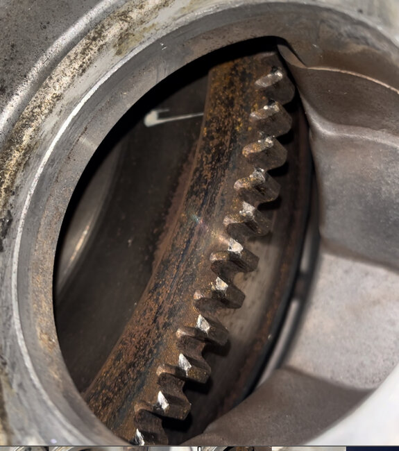

Okay, let's remove the starter and with a flashlight look at the teeth on the flex plate. You can upload an image of the teeth so I can see if needed.
Mar 13, 2024 at 2:27 AM
ARIANADANIELLE5345
  • 402 POSTS
Here’s a picture.
Mar 14, 2024 at 8:50 AM
  • 55,770 POSTS
The flex plate looks good, it must be a defective starter motor, I would try another.
Mar 15, 2024 at 2:35 AM
ARIANADANIELLE5345
  • 402 POSTS
It ended up being the flex plate. It got chipped when the starter broke in the accident. I didn’t have anywhere to keep the car while I changed the flex plate, so I had to junk it. Bummer.
