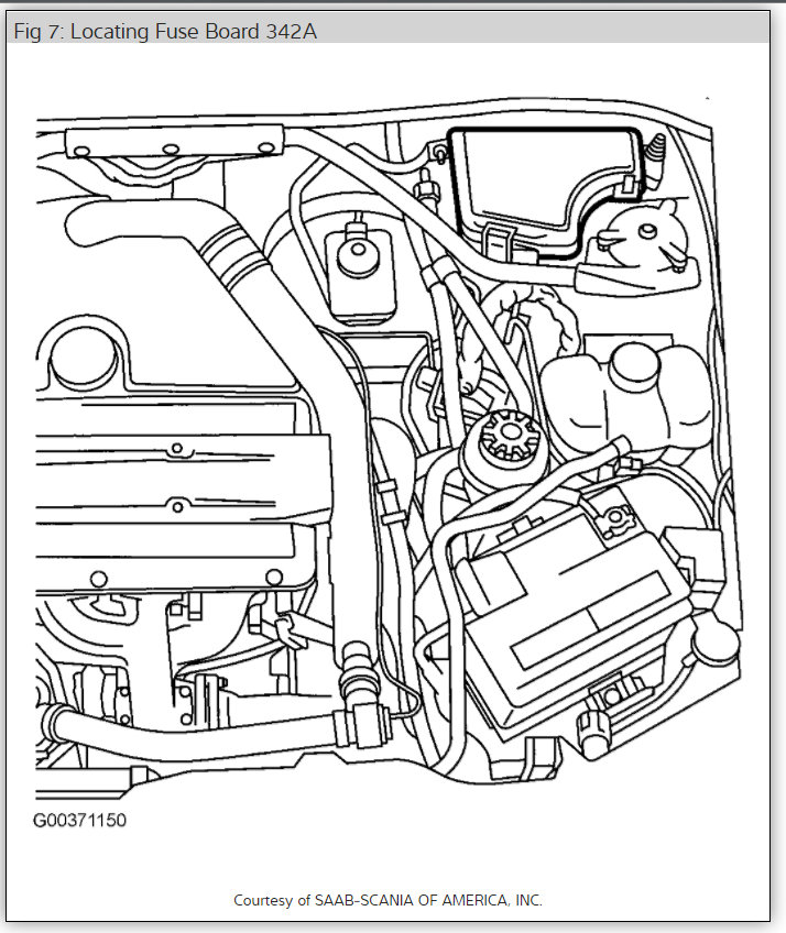

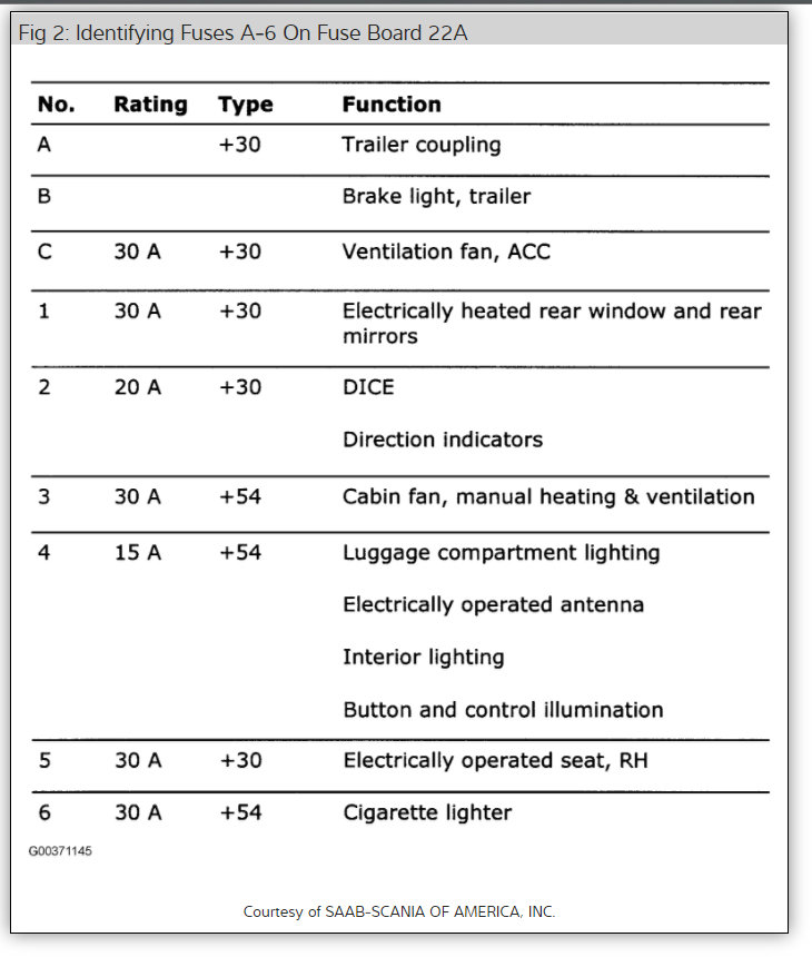

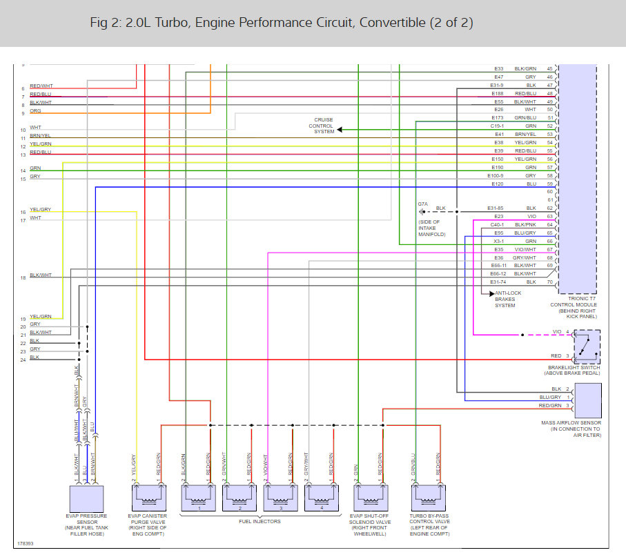

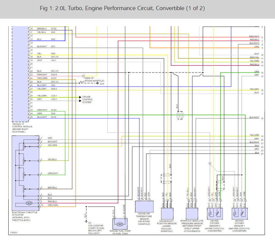

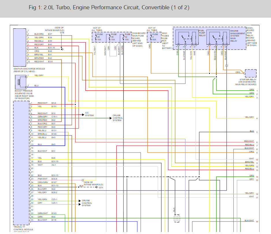

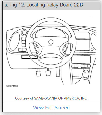

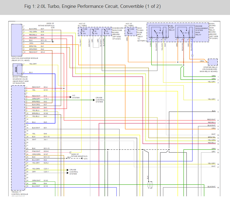

First noticed over a period of time mpg decreased, then one day engine started missing and quit and will not crank. Fuel pressure at rail but no spark. High mileage but engine still strong. I replaced crankshaft position sensor but still no start.

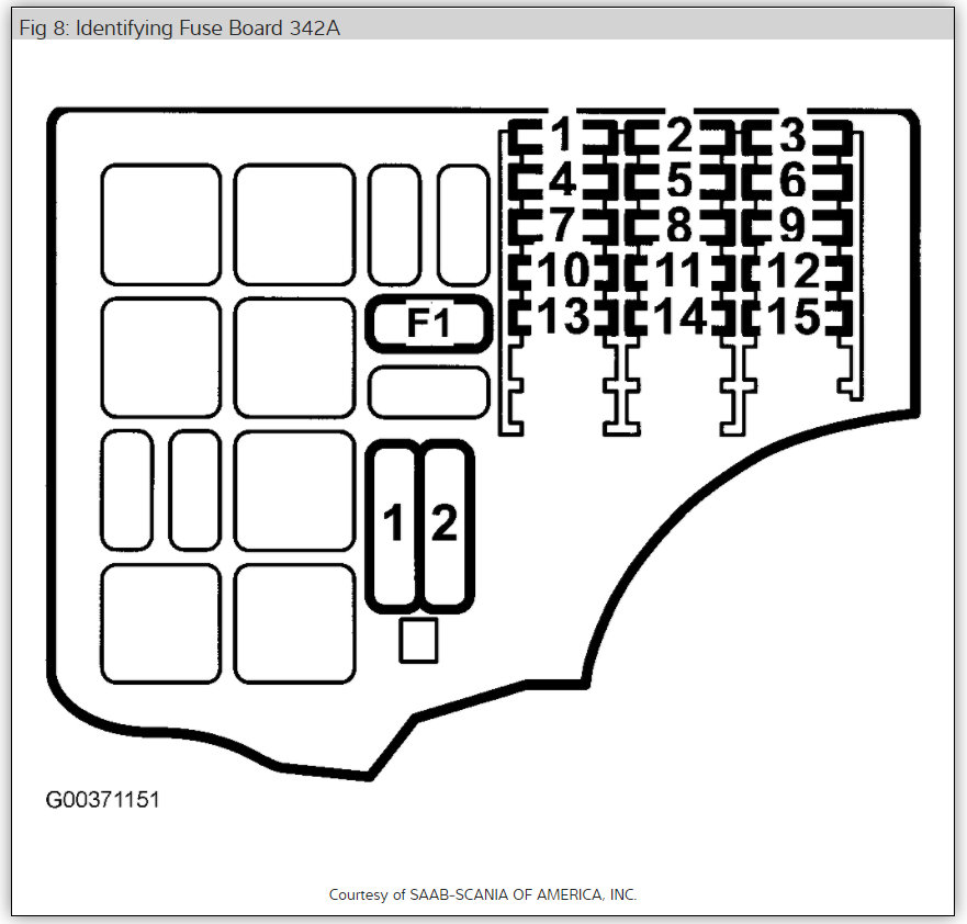

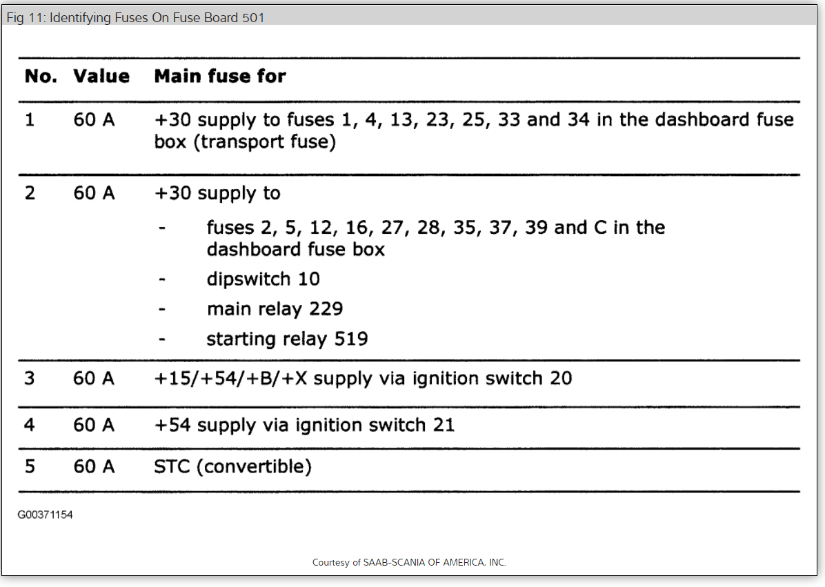

Can I ask if the security light is flashing? If so then this guide will help.
https://www.2carpros.com/articles/how-to-reset-a-security-system
If not then we need to run codes here is a guide to help.

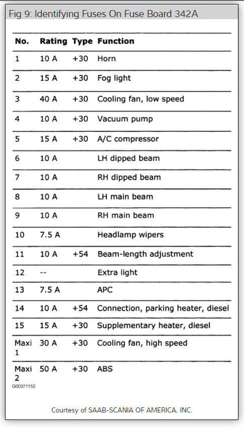

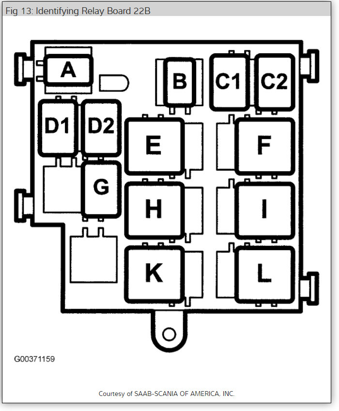

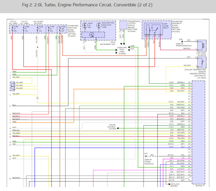

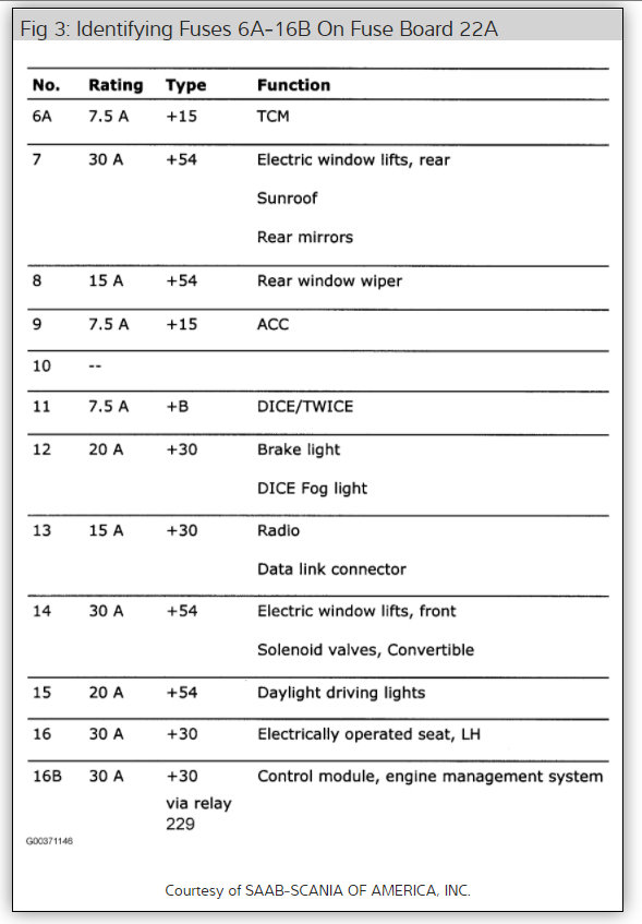

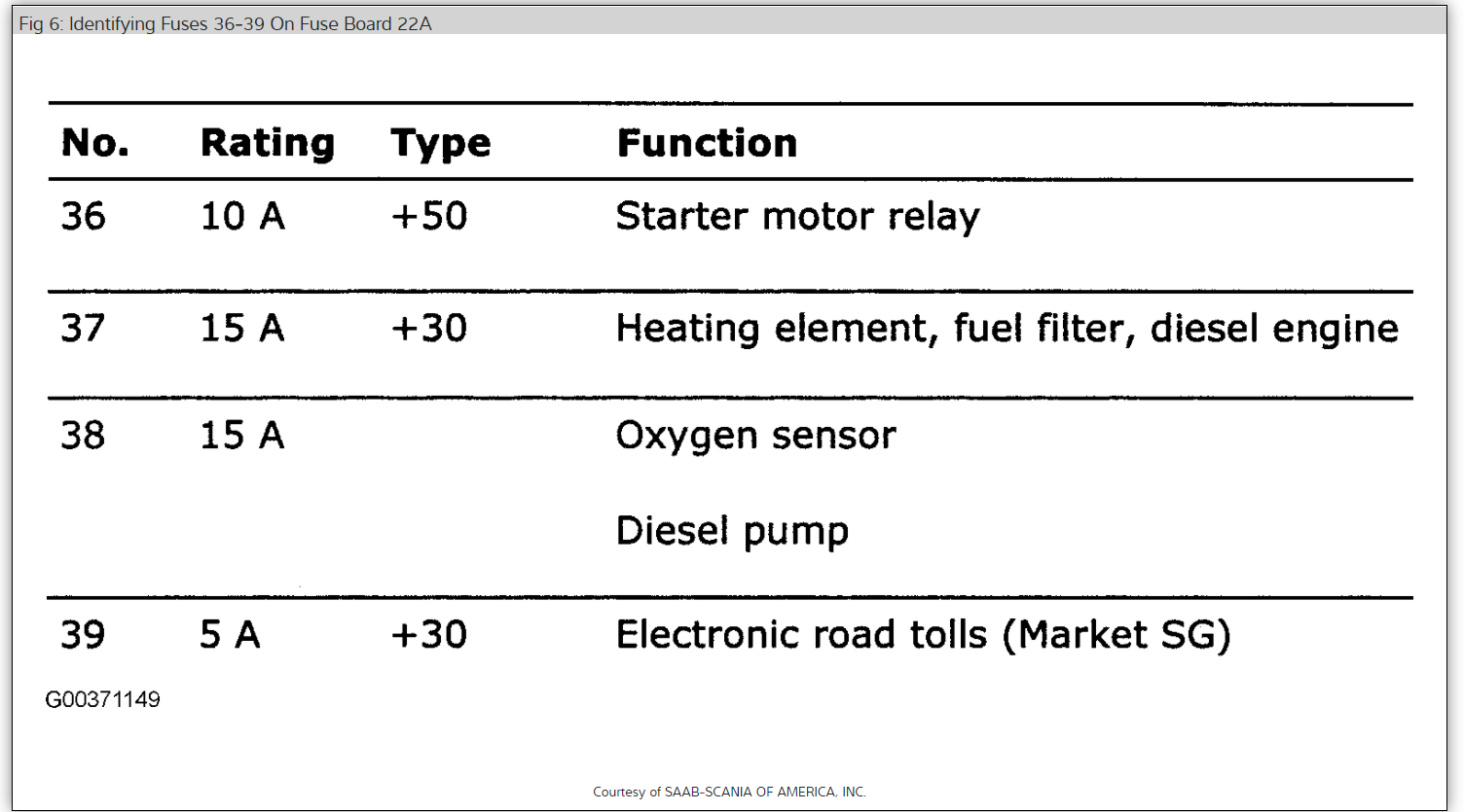

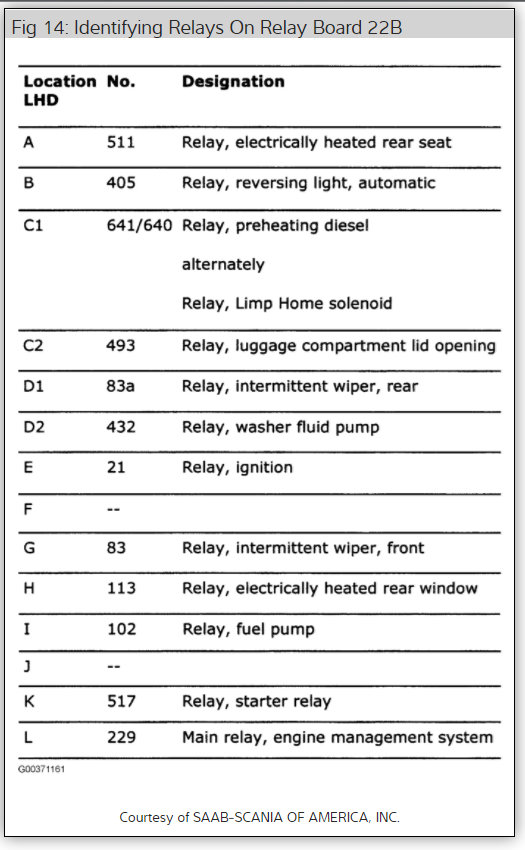

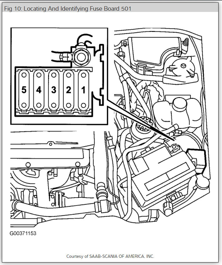

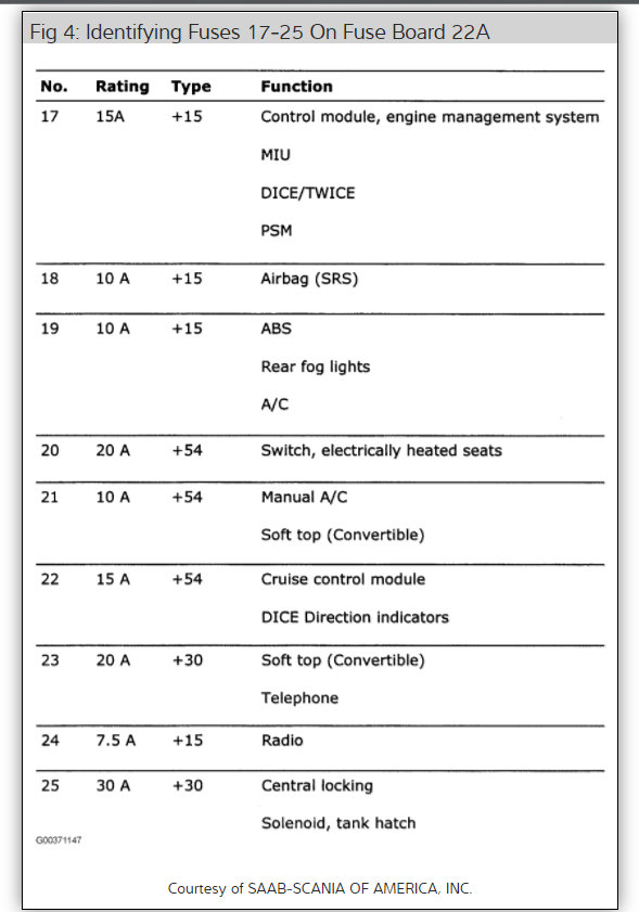

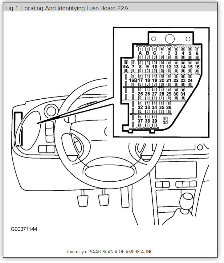

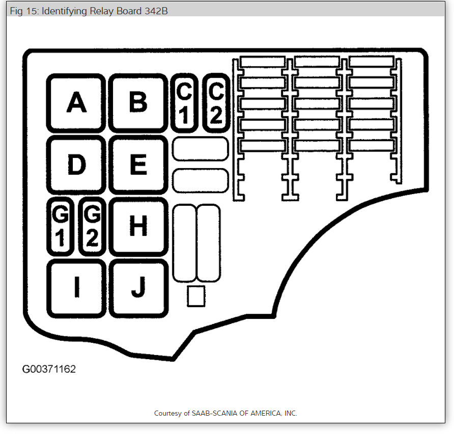

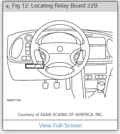

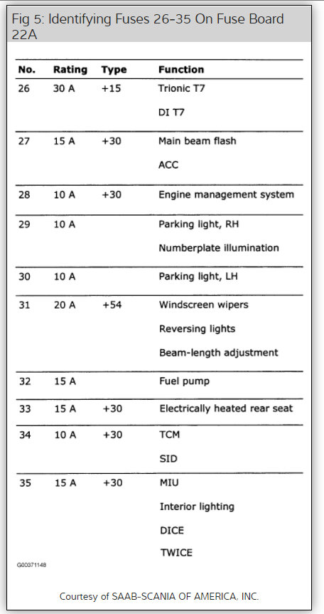

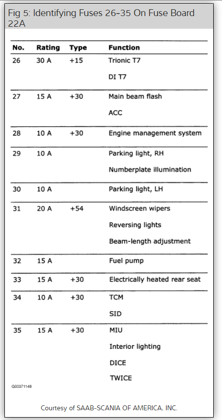

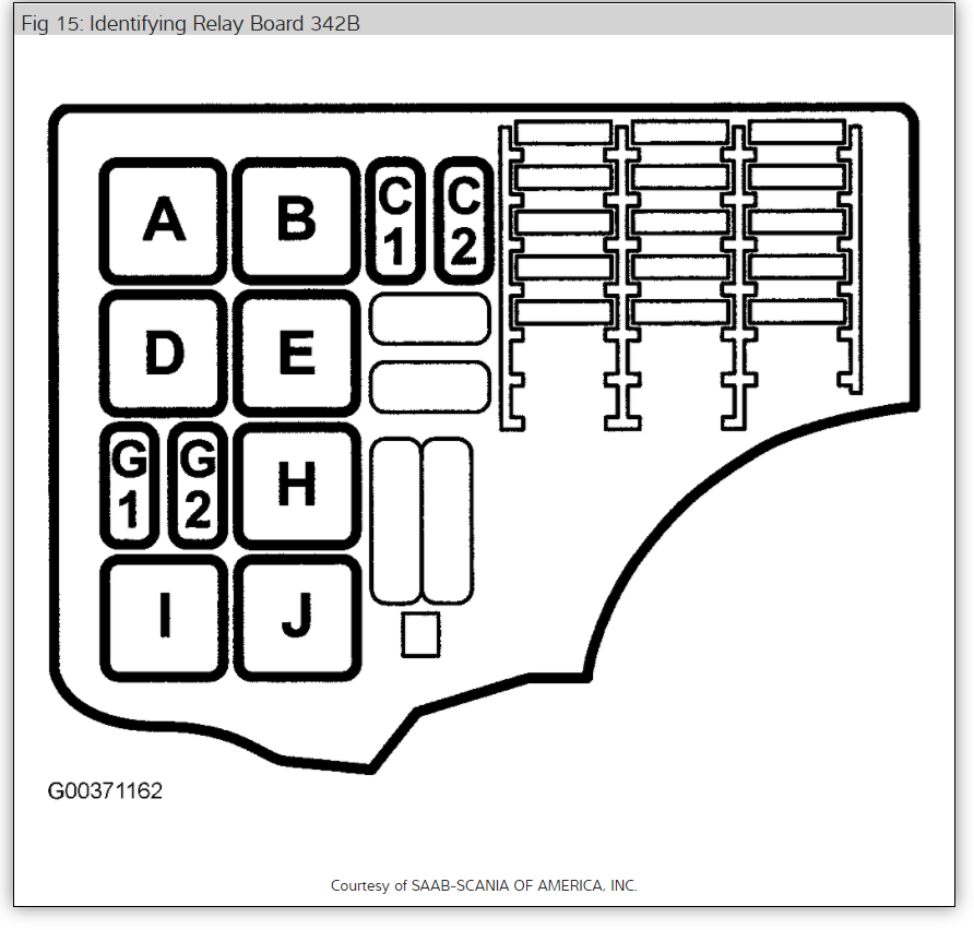

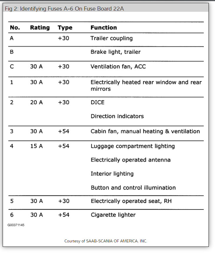

If no codes are present then I would check the ENGINE MANAGEMENT RELAY (L). There are also 5 fuses that run the system lets check those as well.

Did you check the fuses?
