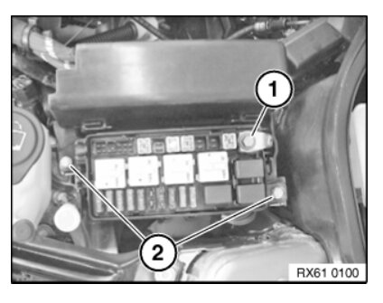

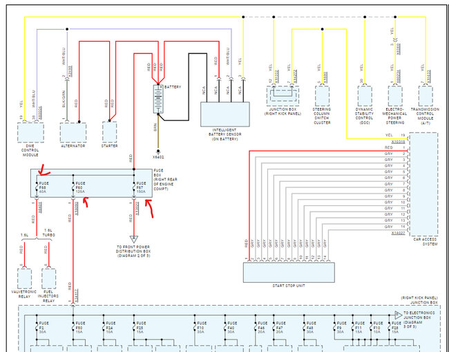

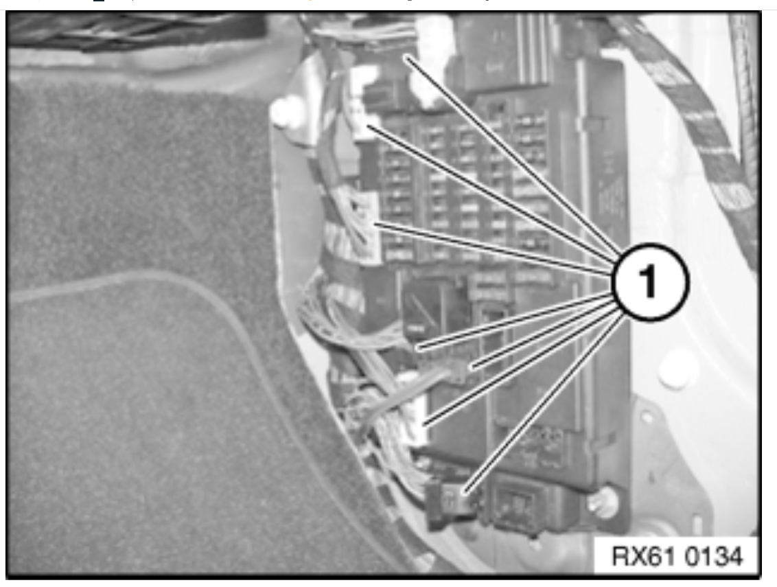

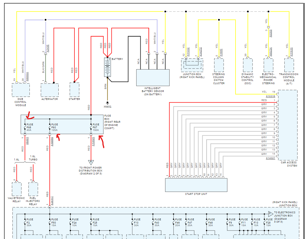

So, when the battery cables get reversed it will blow fuses which is where we need to start. I would check all fuses for power with the ignition system on.
This guide will help:
I have included the fuse location in the diagrams below. Also, please go over this guide as well:
https://www.2carpros.com/articles/resolving-reverse-battery-connection-in-cars-a-step-by-step-repair-guide

Check out the images (below). Please upload pictures or videos in your response of any problems so we can see what to help you with.
Oct 5, 2024 at 7:12 AM

When you say you checked the fuses and all good do they have 12 volts? Also, does the car seem to have power to all of the lights? Can you tell me what else does not work? Please check these fuses for power. Check out the images (below). Let us know how it goes.
Oct 6, 2024 at 11:26 AM
