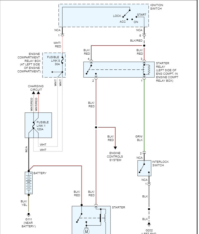

Tried pop starting it with plenty of speed wont turn over. what are some things to look at?

Also, I attached a picture of the starting system schematic for you to see. If nothing happens when the key is turned, check the clutch switch to make sure it isn't causing an issue.
Please let me know if the starter is doing anything so I know which way to direct you.

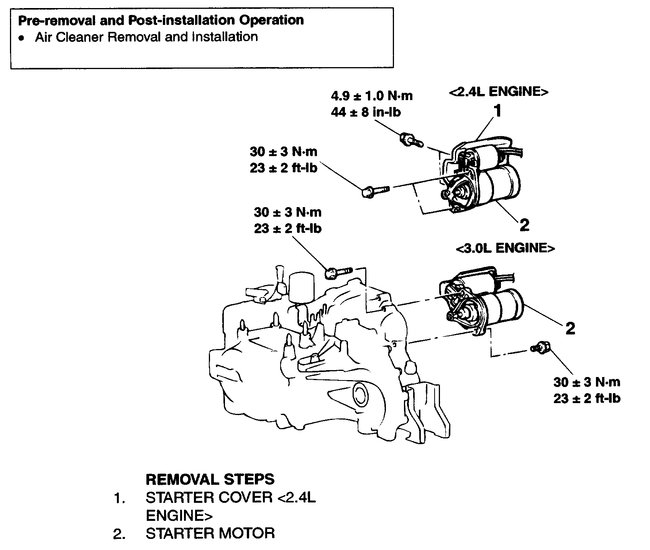

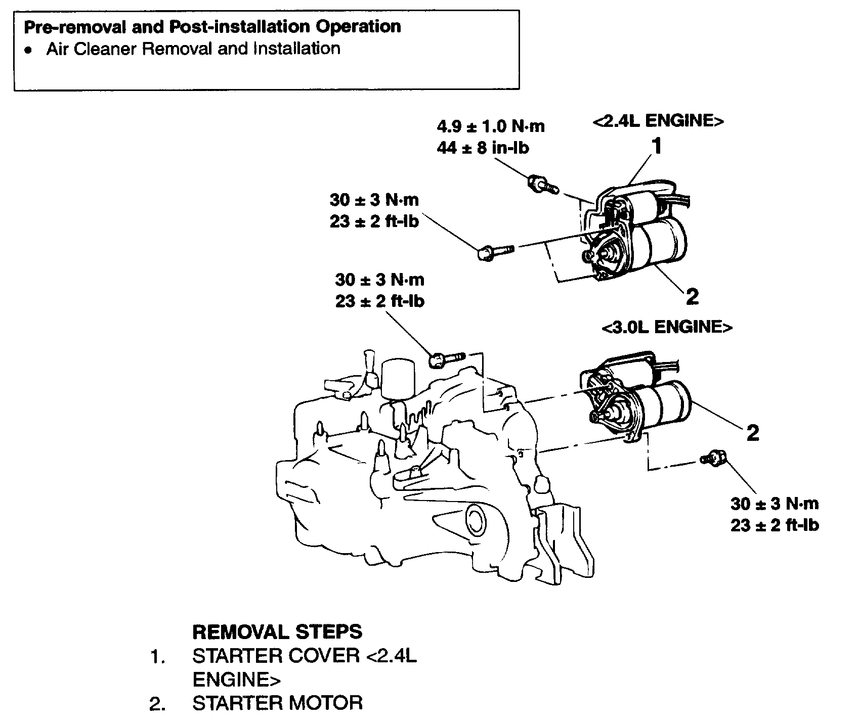

Here are directions for removal and replacement of the starter. The attached picture correlate with the directions (actually are the directions).
_____________________
2001 Mitsubishi Eclipse RS L4-2350cc 2.4L SOHC MFI
Removal and Installation
Vehicle Starting and Charging Starting System Starter Motor Service and Repair Removal and Replacement Removal and Installation
REMOVAL AND INSTALLATION
Starter Motor Assembly
see pic 1
