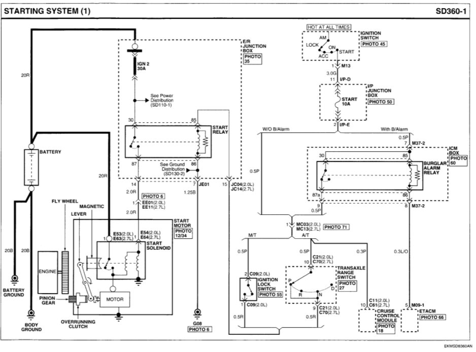

You can do that and cut the power to the starter but that is really not needed. More than likely you just need to replace the starter as the solenoid is shorted inside the starter motor.
The way to prove this is to test the voltage on the control wire from the relay when you release the ignition switch. You should only have 12 volts on this wire when you are cranking the engine. Then when you release it, it should cut the voltage.

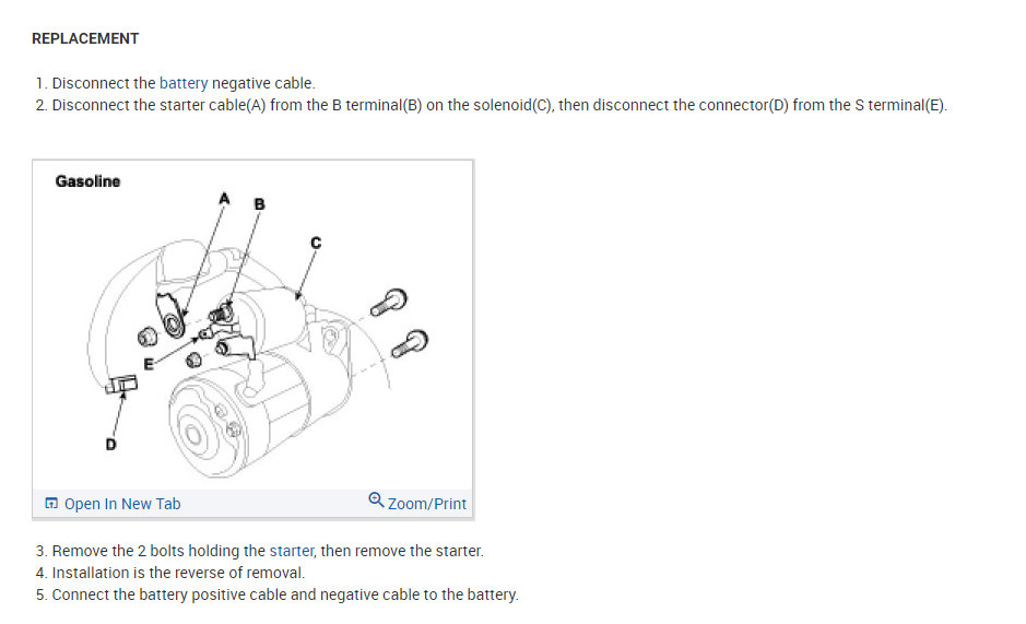

Here is a guide that will help with this:
As you will see from the wiring diagram below the starter has an internal solenoid. If this is shorted then the switch will remain engaged and the starter will not shut off which means replacing the starter will correct this.
If it were me, I would replace the starter but if you want to confirm it by checking for voltage on the control wire then the wiring diagram is below to do that.
Please let us know how you make out. Thanks

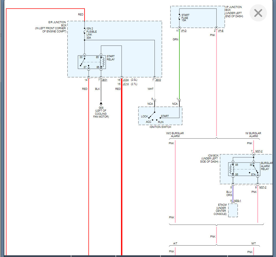

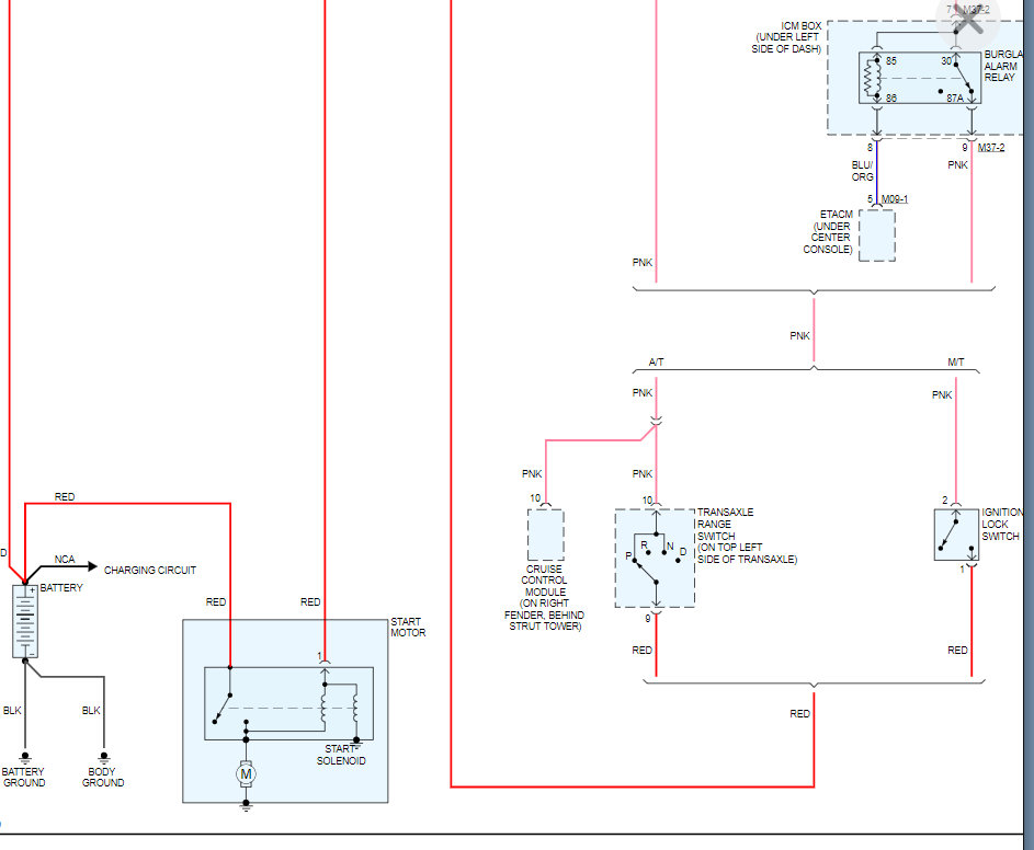

Okay. That is valuable info. I think I understand now.
So if this started after the ignition interlock was installed then depending on what circuit they tapped into then they most likely connected the incorrect wires that causes the starter to engage in the on position and not solely on the start position.
This means we need to run a new wire from where you find voltage on this control wire in the on position.
Take a look at the wiring diagram that I attached again below. Basically just put the key in the on position and go to the ignition switch or where ever they tapped this in and check for voltage.
Either they damaged/shorted the ignition switch, or put the wrong wires together when they installed it.
When you find this, I would just run a new wire to bypass the issue unless it is the switch itself. At that point you will have to replace it.
Does that make sense?
Jun 26, 2021 at 10:37 AM

diagrams help but the printing of the words , well it's so small I can't see it clearly.
Jun 26, 2021 at 12:55 PM
Sorry. It looks fine on my computer so it is hard to know how yours looks. if you are using a phone it can be small. If you have an iPhone you should be able to zoom in on it.
However, let's try the OEM diagram as they write in a little more bold print. If this doesn't work then I will zoom in and cut it into more sections. Thanks
Jun 26, 2021 at 12:59 PM
KGUN74
  • 10 POSTS
That image is much better thanks. It's going to be a few days until I get the car back in the garage and do any work on it but this should help. Too hot outside to do it. Thanks again.
