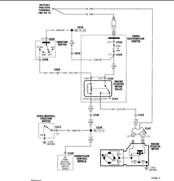

As soon as I hook up my battery she tries to engage.

The first thing I would do is remove the relay and see if it still cranks. If it does, it sounds like the starter. If it does not, then we need to do some voltage checks.
You will need a test light or voltmeter.

starter check out good, pulled the relay still tries to engage. was having some issuse's with the starter cable, got another one from the junk yard, had Jeep running before I changed the cable.

Anyway, remove the little wire on the starter solenoid and see if it still tries to start

Did that earlier. no it wouldn't start.

If you removed the wire and it did not start and you pulled the relay and it started, then you have a short to power on that small wire to the solenoid.

so I should replace the solenoid wire?
Jan 15, 2019 at 6:14 PM
I would try to find the short in the harness. If you do not find it there may be future issues with other systems.
