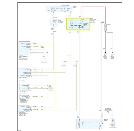

I get a "click" sometimes when trying to start the car
CANNON1349
  • 2006 JEEP LIBERTY
  • 4 CYL
  • 4WD
  • 200,000 MILES
Eventually it will start. I can hear the relay click with a stethoscope and the "click" is the starter arm engaging. Does this mean the starter motor is bad and needs replacement?
Battery, alternator and starter tested good at Advance Auto.

Good afternoon,
Does it eventually start? If it does, it is not the relay.
If it does not, testing needs to be done in the starting system.

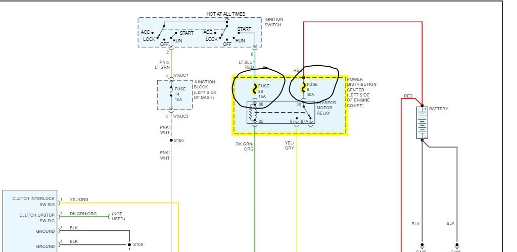

I attached a wiring diagram for you to view. You need to test the fuse for power on both sides.
Thursday, August 8th, 2019 AT 12:24 PM
CANNON1349
  • 670 POSTS
Yeah. It starts. And I had a helper start while I used a stethoscope on the relay. Even when it doesn't start, the relay clicks, and the starter clicks.
Thursday, August 8th, 2019 AT 12:28 PM
  • 52,797 POSTS
Then it sounds like the starter motor has failed. It has a dead spot on the armature.
Thursday, August 8th, 2019 AT 12:29 PM

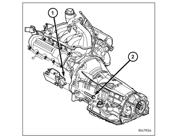

Procedure below.
No to the driveshaft.

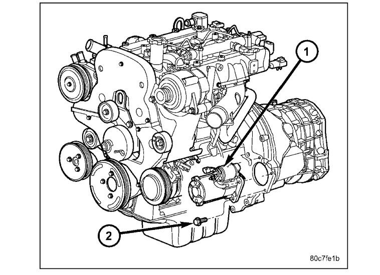

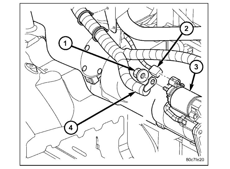

1. Disconnect and isolate negative battery cable.
2. Raise and support vehicle.
3. Disconnect solenoid wire connector (2) from solenoid terminal.
4. Remove battery cable eyelet (4) from stud on starter solenoid.
ImageOpen In New TabZoom/Print
5. Remove three starter mounting bolts (2).
6. Remove starter (1) from transmission bellhousing.
Thursday, August 8th, 2019 AT 12:34 PM

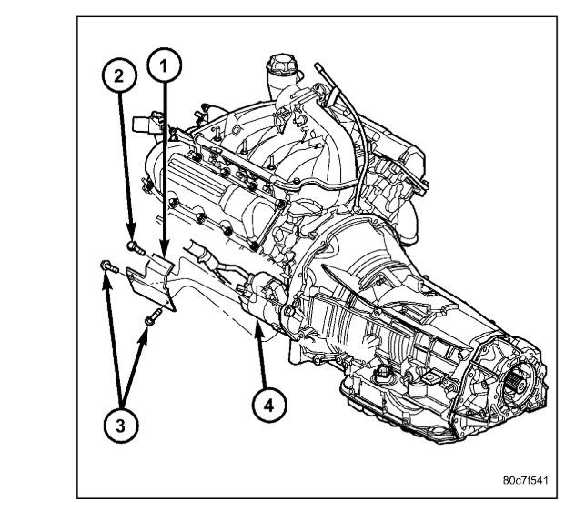

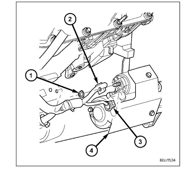

REMOVAL
3. Remove 2 flange bolts securing left exhaust downpipe to crossover pipe. Lower pipe slightly to allow front propeller shaft removal.
4. Remove front propeller shaft.
5. Remove two starter heat shield bolts (3) at side of starter.
6. Remove starter heat shield nut at front of starter.
7. Remove starter heat shield.
8. Remove solenoid wire connector (3) from solenoid terminal.
9. Remove battery cable eyelet (2) from stud on starter solenoid.
10. Remove two starter mounting bolts (2).
11. Position front of starter to face rear of vehicle. Rotate starter until solenoid position is located below starter.
12. Remove starter from vehicle by passing it between exhaust pipe and transmission bellhousing.
Thursday, August 8th, 2019 AT 12:48 PM

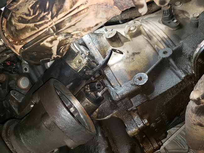

This is ridiculous. I don't know what I'm missing here, but it wont come through because of the catalytic converter. Every video online people are just sliding the starter between it but I do not have room like in the videos. Picture attached.

  • 52,797 POSTS
Okay, it makes a big difference with the right year and the right engine.
The exhaust has to be dropped as in the procedure I attached. 2002 is different than in 2006.

I lowered the exhaust to remove the propeller shaft. You're saying unbolt the rest from the head?
Saturday, August 10th, 2019 AT 4:27 AM
  • 52,797 POSTS
Correct. It has to come down low enough to remove the starter.
Saturday, August 10th, 2019 AT 4:36 AM
CANNON1349
  • 670 POSTS
Anything special about that procedure?
Saturday, August 10th, 2019 AT 5:15 AM
  • 52,797 POSTS
No, not at all. Straight forward procedure.
