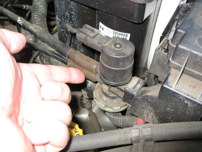

It's the vacuum line that comes down from the throttle body and T's into the bottom line from the purge solenoid. The purge solenoid has 2 vacuum lines and an electrical connector. When I leave all vacuum lines plugged in, but disconnect electrical connector, Jeep still stalls. When I reconnect electrical connector but disconnect bottom vacuum line, letting more air get to throttle body, then the Jeep runs fine with no codes. No engine light. No stumbles. Just runs. So for some reason, it runs fine with a vacuum leak, with air getting sucked into throttle body, but will stall and get PCM code if I fix vacuum leak. Just doesn't make sense.
https://images.2carpros.com/forum/automotive_pictures/387567_IMG_3177_1.jpg
Purge Solenoid. Part of the emissions system. The vacuum line that had the leak I fixed T'd into the bottom one on this solenoid.

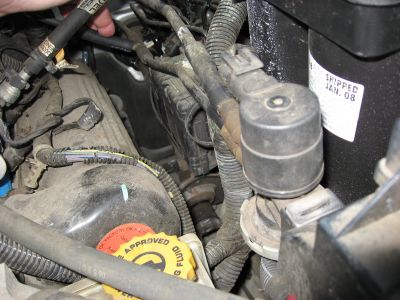

This is the section of hose I replaced. When I found the leak, the hose piece that was there was split lengthwise and wrapped around the two connections. Now that I've fixed the vacuum leak, the Jeep gets great gas mileage but I have this stalling problem.

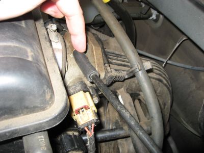

This is where the line goes into the throttle body. When I disconnect it, the Jeep runs fine, idles a tad high, sucks a LOT of air in through here, but runs fine with no codes.

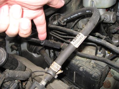

Picture of Purge Solenoid in foreground and line going to T with section of hose I replaced.
