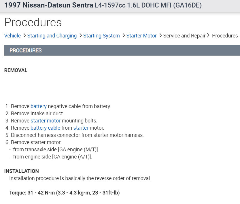

I’m a girl with tools and some experience/knowledge of working on my Nissan truck. So this is car. I would like diagram or pics with step by step detailed instructions. If all possible. Thank you
Aug 18, 2023 at 11:16 AM
  • 55,456 POSTS

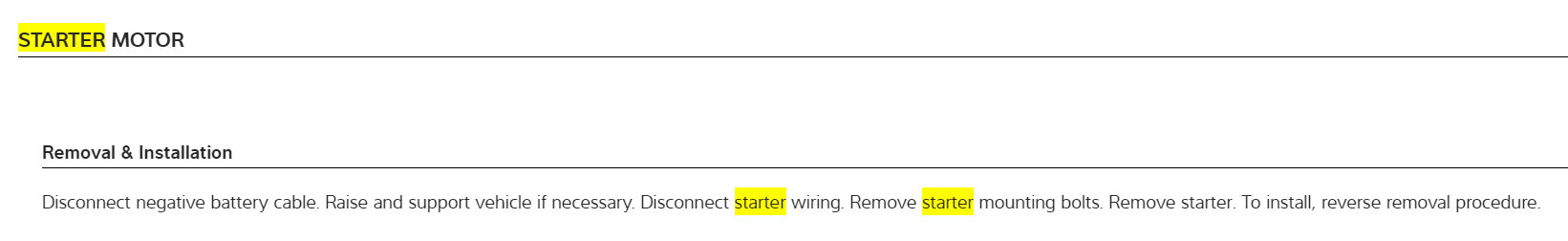

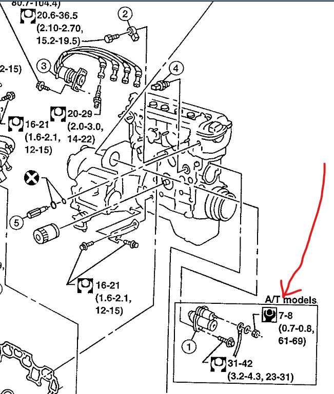

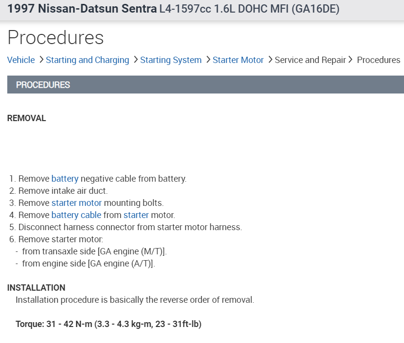

Sure, here is a generic guide to help you step by step with instructions in the diagrams below to show you how on your car:
They don't have complete images for some reason, sorry. This is all Mitchell1 and Alldata has. If you get stuck, please upload a short video or an image so I can help. Check out the images (below). Please let us know what happens.
