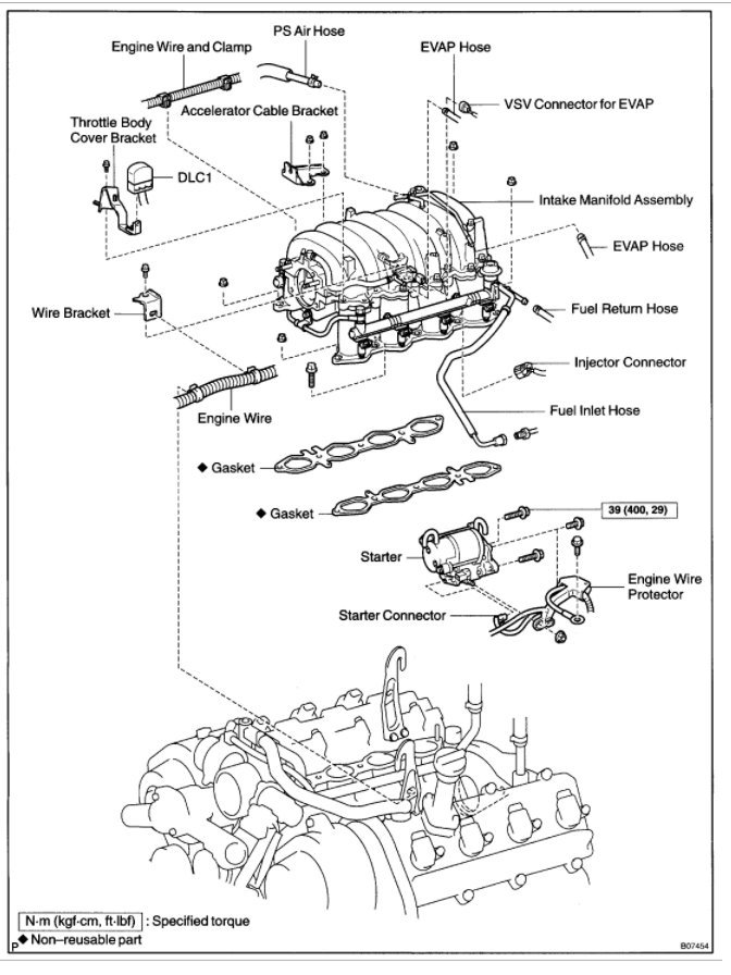

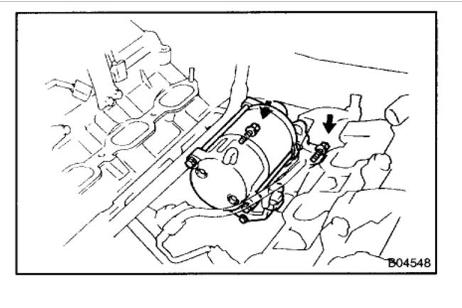

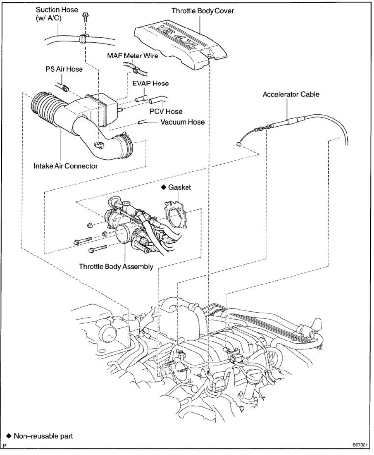

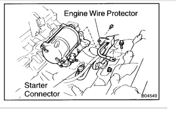

Looking for detailed step by step instructions on how to change the starter.
May 16, 2017 at 2:04 PM
  • 55,694 POSTS
You must start by removing the negative battery terminal. Here is a step by step guide and some diagrams for your car. (BELOW)
Yours is under the intake manifold which make the job a little tougher but you can do it.

Battery off (use a memory saver if you can or you will loose radio function until you code it again) remove any under engine covers, there will be 2 wires on the starter one heavy and one small, remove these heavy will be a 12mm nut and small push on, starter is secured with 2 bolts, undo and carefully remove starter.
