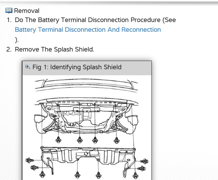

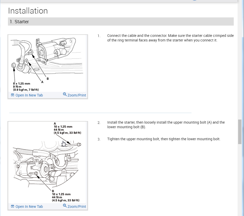

I'm looking for detailed instruction on how to replace the starter. I've replaced starters on older cars and if it's not too complicated. I'll be replacing one on this car listed above.

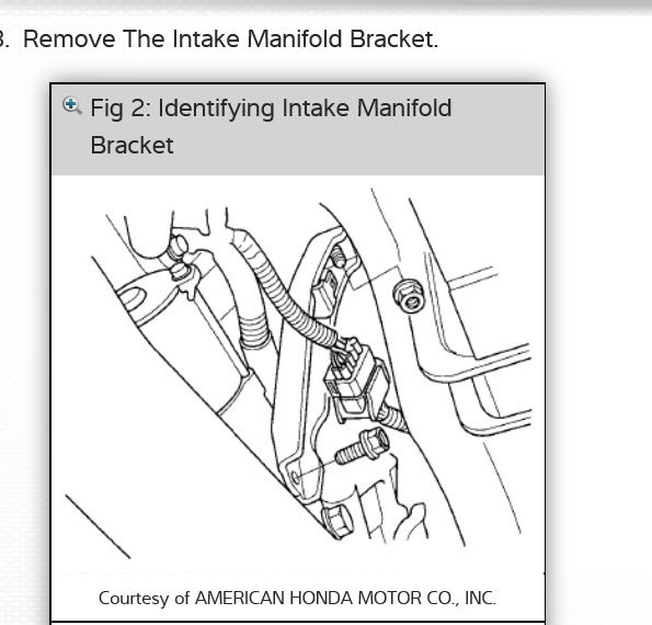

I cannot get to my starter to check things.
Jan 22, 2021 at 5:22 AM (Merged)
HMAC300
  • 48,601 POSTS
if it is not starting and you have a known good battery try resetting security system. See the link.
https://www.2carpros.com/articles/how-to-reset-a-security-system

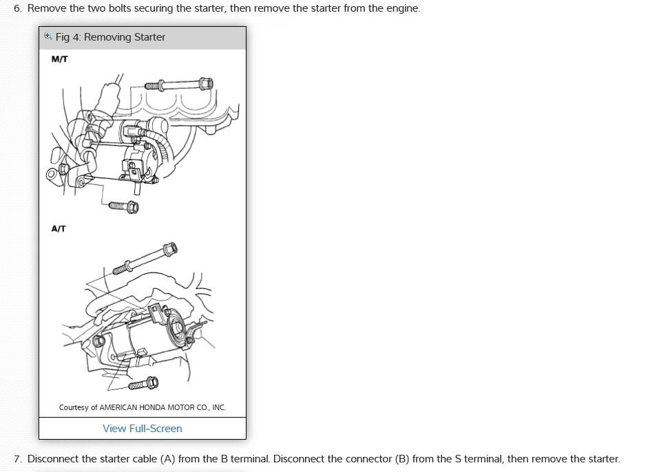

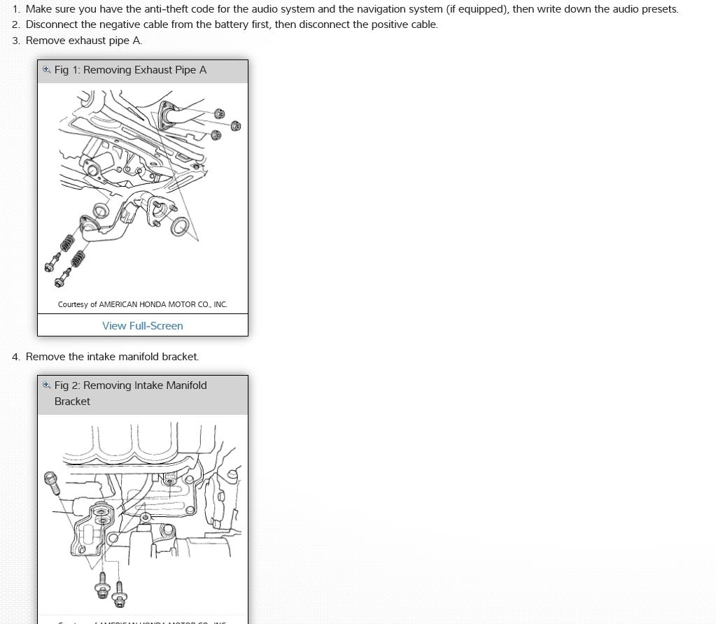

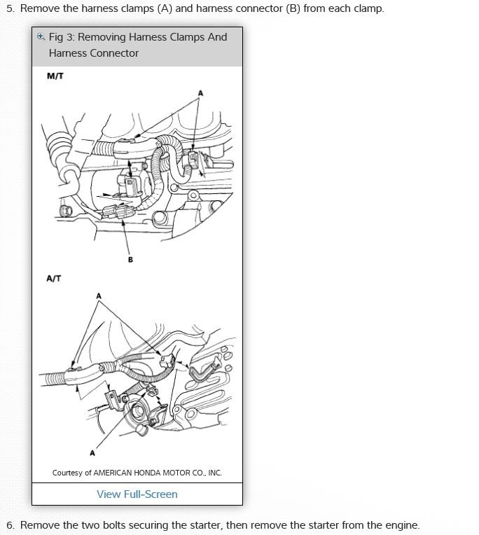

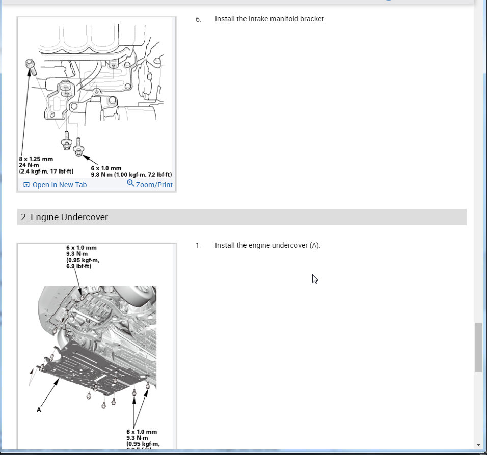

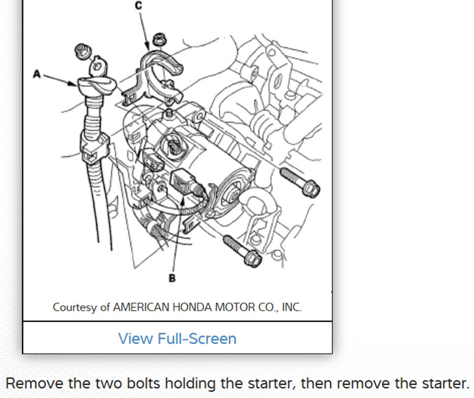

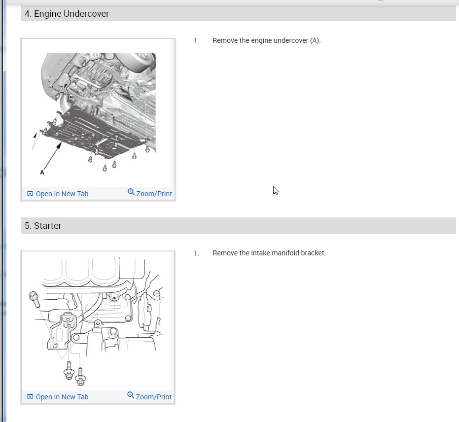

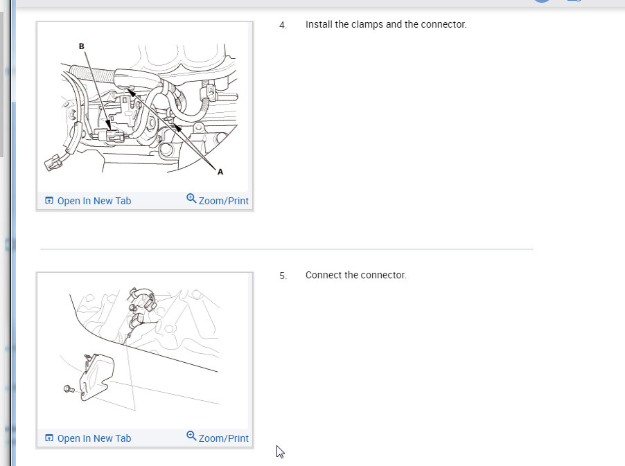

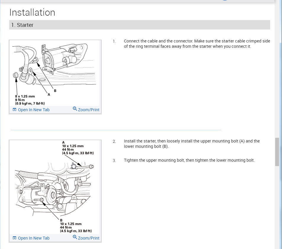

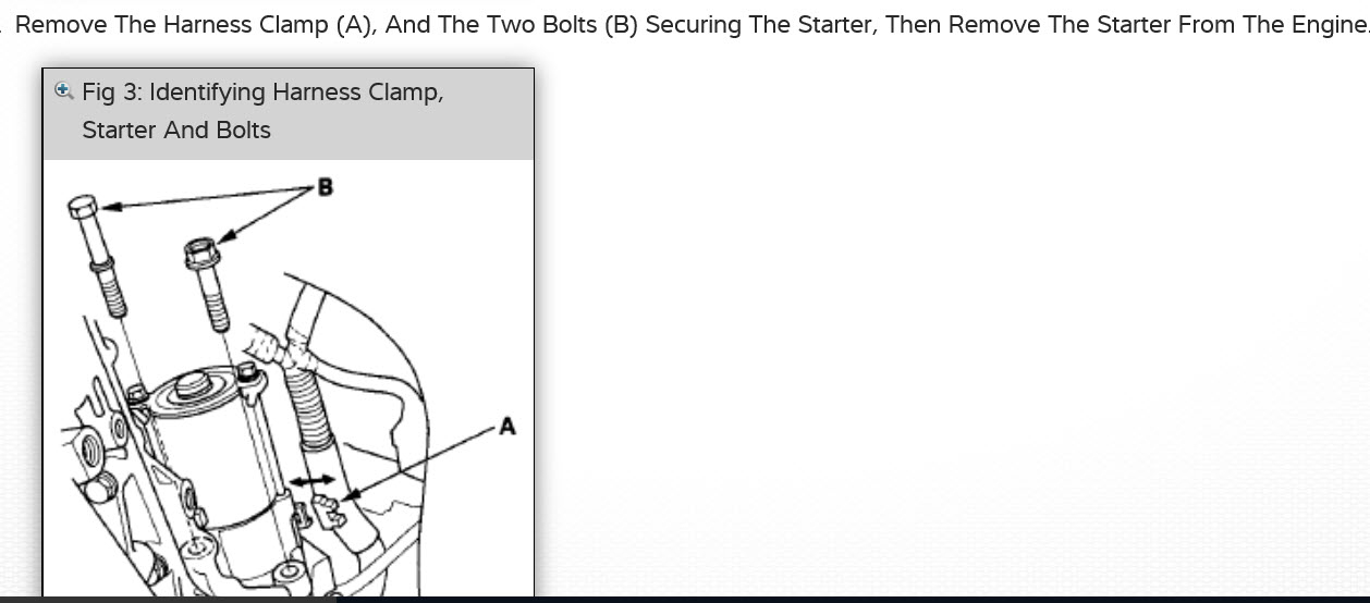

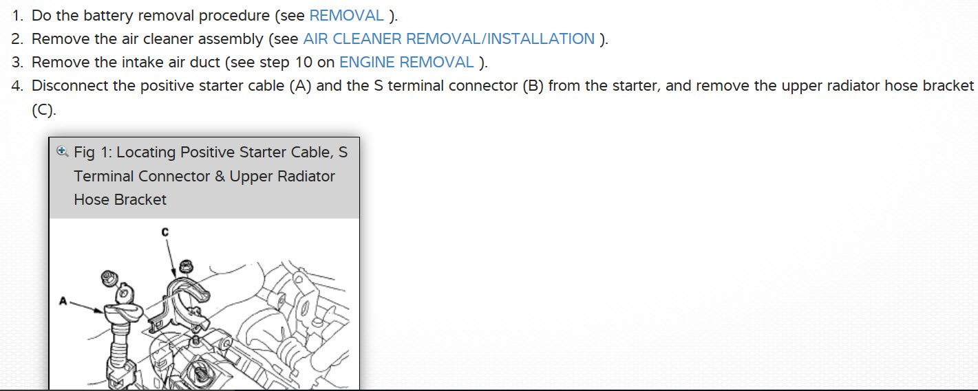

if starter is bad see pictures for removal.

I want to know what I have to take apart to get to the starter as it is buried on back side of engine. everything is in the way.

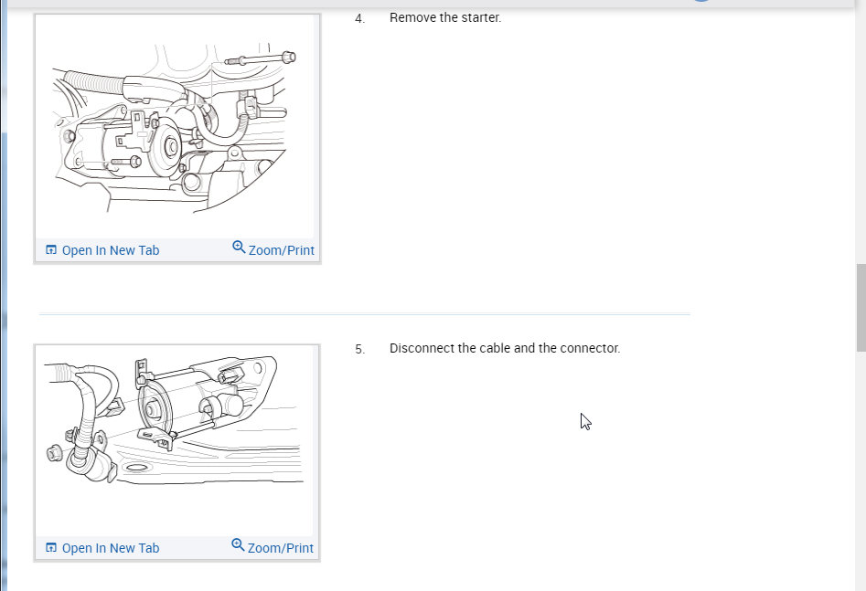

The picture just shows how starter comes out. I need to know-how to get to the starter, as the manifold is hiding it. The pictures do not show that .
HMAC300
  • 48,601 POSTS
if you would read the instructions on the picture it tells you everything to remove starter.
ALFRED HILL
  • 7 POSTS

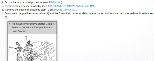

Yes it tells how to remove starter, but what do you have to take off to get to the starter? The manifold is blocking it at the top.
HMAC300
  • 48,601 POSTS
if you follow the steps you should be able to do this. this was taken form a 1.3L Honda as it does not show a 1.2L. try from bottom if this is not sufficient I apologize as this is all we have.

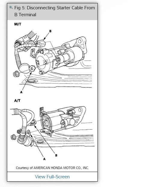

CALLIE02
Trying to remove and replace starter. Does anyone have a step by step picture of how to do this?
Thank you,
Brenda
Jan 22, 2021 at 5:23 AM (Merged)
PATENTED_REPAIR_PRO
  • 1,853 POSTS

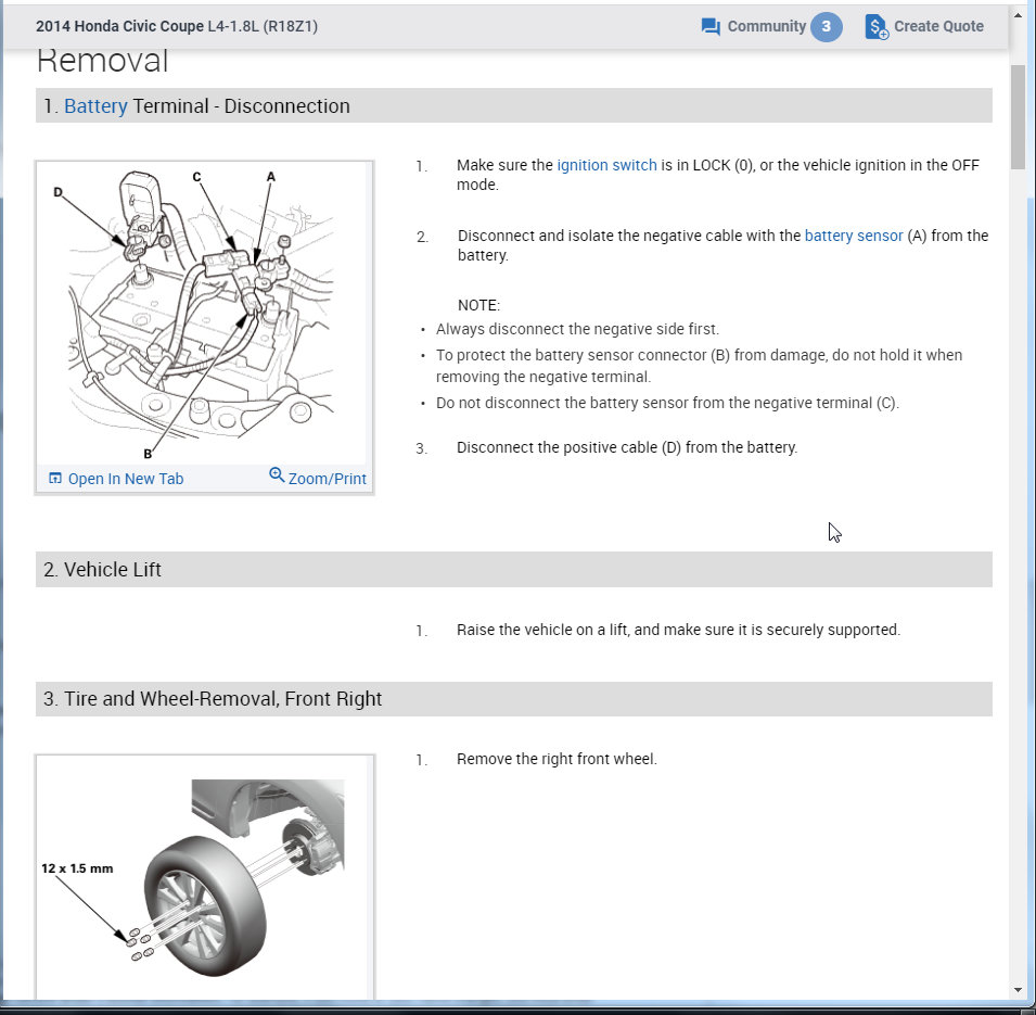

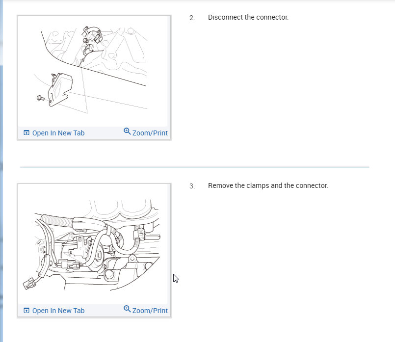

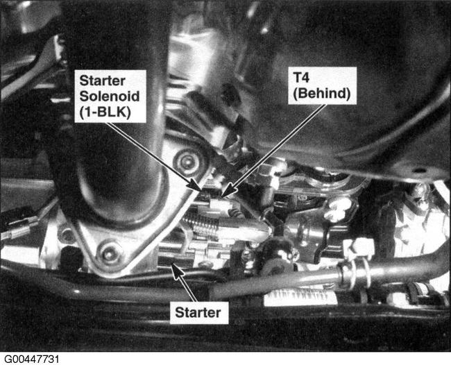

Here are the instructions on how to remove this starter: Here is a guide to help you step by step with instructions in the diagrams below to show you how on your car.
Here is the location in the diagrams below. Please let us know if you need anything else to fix it.

Here is a guide that will show you how to change it out with a diagram below to show you the starter location.

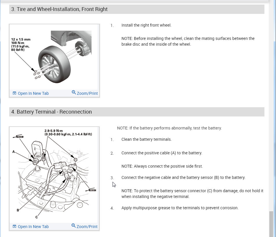

I have a new starter and I am ready to install it. Is it easier to go from under the car or take the intake manifold off and just work up top?
HMAC300
  • 48,601 POSTS
see pictures for removal and reverse for install. make sure to remove knock sensor for easier access and not to break it. also remove negative battery cable prior to beginning.

Not enough info... what do you take off after taking manifold brkt off ? Does the manifold come off ?
  • 55,542 POSTS
Hi ALFRED,
No the manifold stays on, you only take off the manifold to gain access to the starter.

how to remove starter from 1.8 2007 honda civic ex

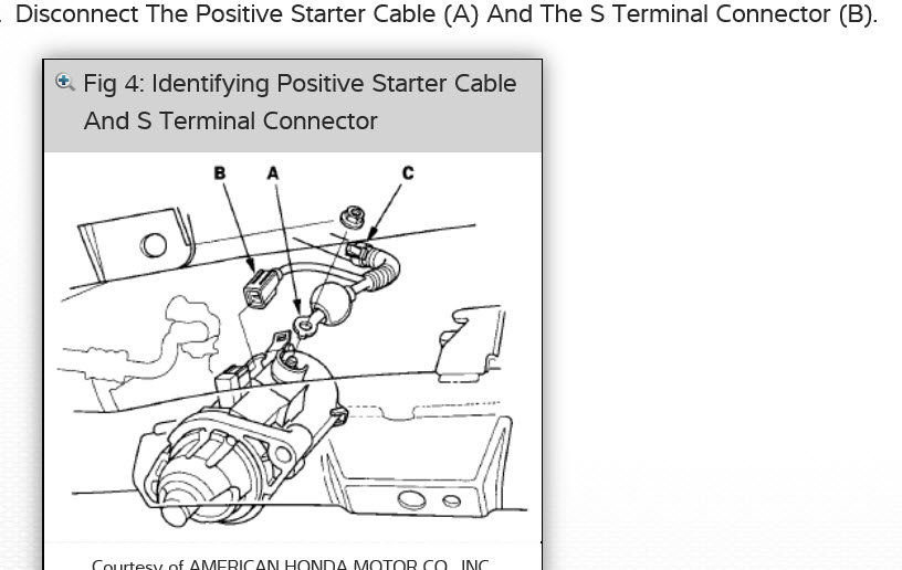

SATURNTECH9
  • 30,869 POSTS
Starter Removal and Installation
Removal
1. Make sure you have the anti-theft code for the audio system and the navigation system (if equipped), then write down the audio presets.
2. Disconnect the negative cable from the battery first, then disconnect the positive cable.
3. Remove exhaust pipe A.
4. Remove the intake manifold bracket.
5. Remove the harness clamps (A) and harness connector (B) from each clamp.
6. Remove the two bolts securing the starter, then remove the starter from the engine.
7. Disconnect the starter cable (A) from the B terminal. Disconnect the connector (B) from the S terminal, then remove the starter.
INSTALLATION
1. Install the starter cable (A) and connector (B). Make sure the starter cable crimped side of the ring terminal faces away from the starter when you connect it.
2. Install the starter, then loosely install the upper mounting bolt (A) and lower mounting bolt (B).
3. Tighten the upper mounting bolt, then tighten the lower mounting bolt.
4. Install the harness clamps (A) and harness connector (B) to each clamp.
5. Install the intake manifold bracket.
6. Install exhaust pipe A. Use new gaskets (B) and new self-locking nuts (C).
7. Connect the positive cable to the battery first, then connect the negative cable.
8. Start the engine to make sure the starter works properly.
9. Enter the anti-theft code for the audio system and the navigation system (if equipped), then enter the audio presets.
10. Set the clock.
