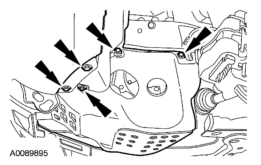

1. With the vehicle in NEUTRAL, position it on a hoist.
2. Disconnect the battery ground cable.
3. Remove the pin-type retainer, 6 bolts and the LH splash shield.
- To install, tighten to 9 Nm (80 lb-in).

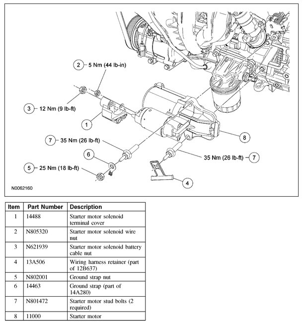

4. Remove the starter solenoid wire nut.
- To install, tighten to 5 Nm (44 lb-in).
5. Remove the starter solenoid battery cable nut and disconnect the starter motor solenoid terminal cover and cables.
- To install, tighten to 12 Nm (9 lb-ft).
6. Disconnect the wiring harness retainer and position aside the wiring harness.
7. Remove the ground strap nut and position aside the strap.
- To install, tighten to 25 Nm (18 lb-ft).
8. Remove the 2 stud bolts and the starter motor.
- To install, tighten to 35 Nm (26 lb-ft).
9. To install, reverse the removal procedure.
