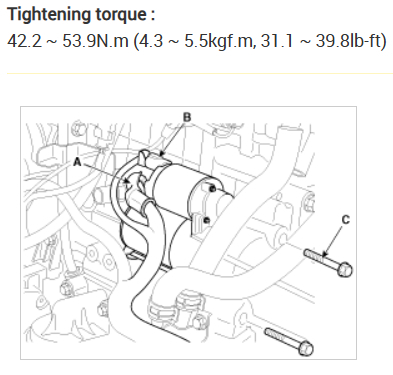

how to replace the starter motor on this 2012 Hyundai Sonata 2.4l and how many hours?

I would start by disconnecting the battery negative cable. Then raise the car up so you can get at the starter motor. Here is a video to help show you how to raise the car up safely.
https://www.youtube.com/watch?v=xLFn_bMkZc0&pp=0gcJCSgLAYcqIYzv
Next, remove the main power cables and the trigger wire from the starter solenoid. Here is a guide to help you step by step and I have included a diagram for your car in the images below.
https://www.2carpros.com/articles/how-to-replace-a-starter-motor/
Labor time is 1.2 hours to do the job. Check out the images (below). Let me know how it goes

When the starter is out can you use a flashlight and check the teeth of the flex plate? Check out this guide:
https://www.2carpros.com/articles/how-flexplates-work/
