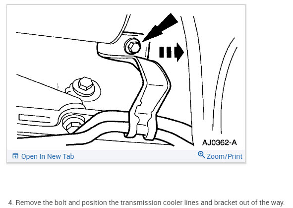

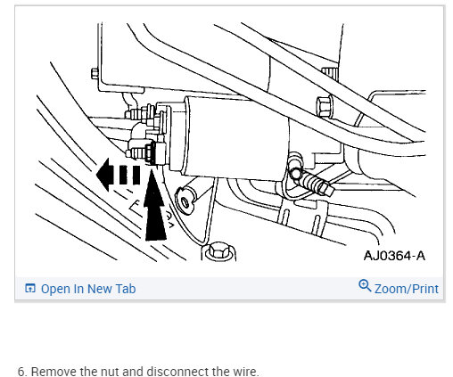

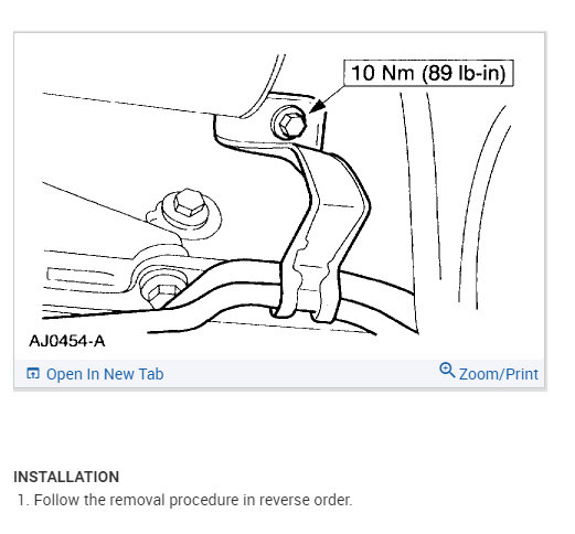

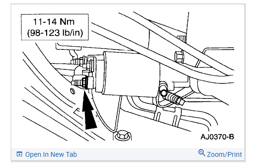

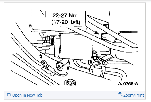

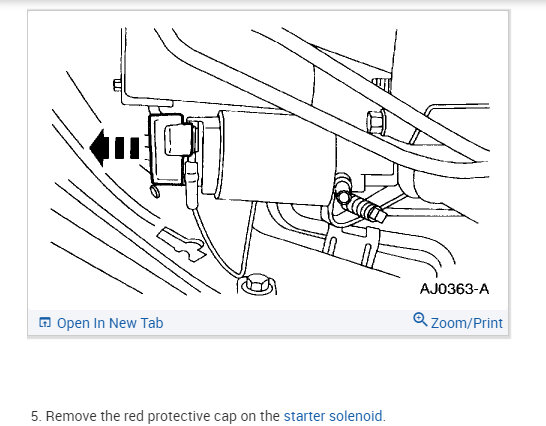

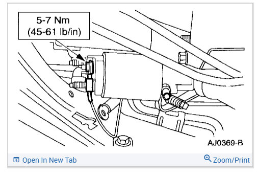

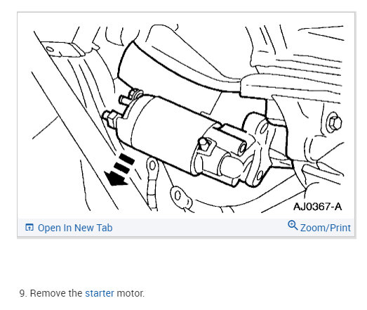

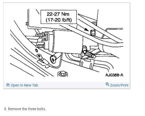

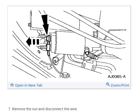

What is the best way to get out the starter and what tools are needed?
Jul 23, 2023 at 3:39 AM
  • 110,241 POSTS

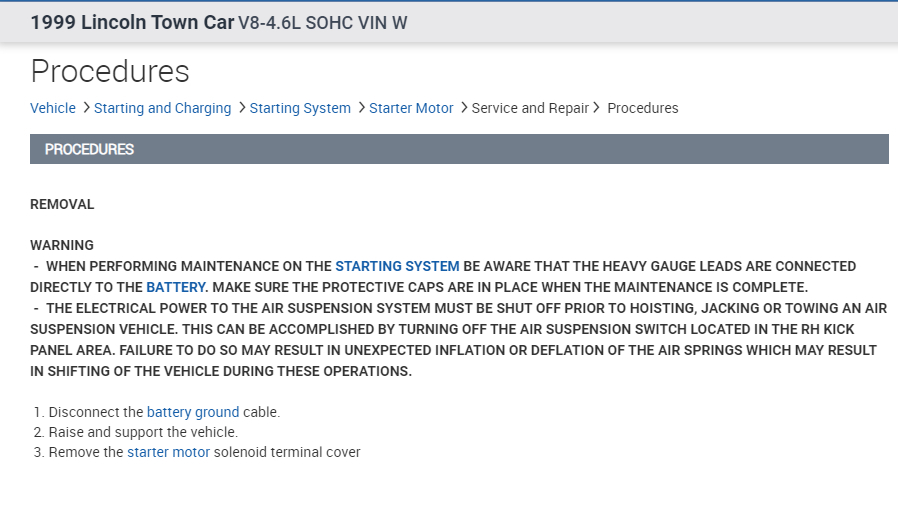

Replacing the starter isn't too difficult. It may be hard if you can't lift the vehicle. If you do, make sure to use jack stands as a safety measure.
To get you started, here is a link that explains in general how to replace a starter motor. You can use this to help guide you.
If you look below, I attached the directions specific to your vehicle. Take a look through them and let me know if you have any questions.
Let me know if this helps.
See pics below. Note: Make sure the battery is disconnected prior to working on the starter.

It did not tell/show how to remove the top left bolt on the starter.
Mar 24, 2026 at 2:33 AM
  • 55,402 POSTS
Yep, that is a tough one this video show you how.
https://www.youtube.com/watch?v=iySmMQM5OLE
Let us know if you need anything else.
