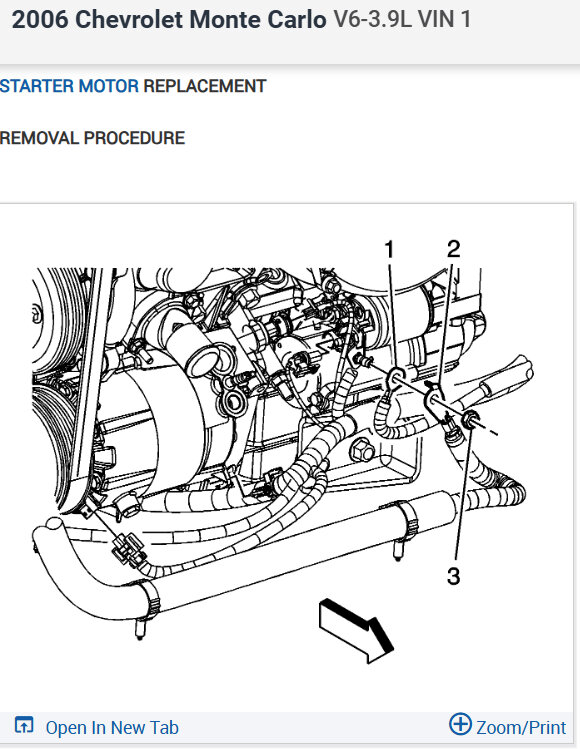

my starter went out after we had a heavy rainstorm a bit back, I just don't know how to change it exactly as this would be the first starter i ever changed.

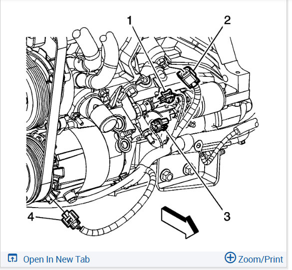

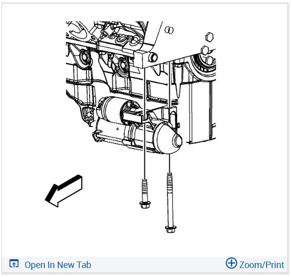

Okay, no problem I can help walk you through it, start by disconnecting the battery, (negative side) then you need to raise the car up and secure it with jack stands, this video can help.
https://www.youtube.com/watch?v=xLFn_bMkZc0
Here are the step-by-step instructions on how to change the starter out with additional information for your car below.
Tighten the bolts to 43 N.m (32 lb ft).
Check out the images (below). Please upload pictures or videos in your response of any problems so we can see what to help you with.
