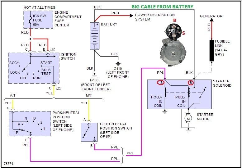

Working on friends car they had pulled off the wires to the starter. I know where the larger ones go but there are two smaller ones a red and a black wires where do they go to?

Got the wire diagram from "Prodemand"
I added the back view of the starter from "Autozone".
The red circles/red text/green text, I added from "MS Paint" to maybe get you oriented better.
Let me know if this helps.
