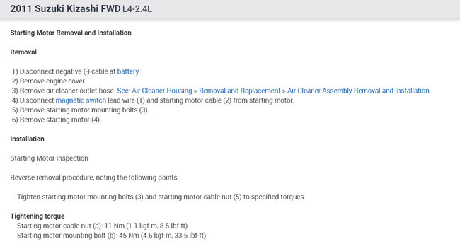

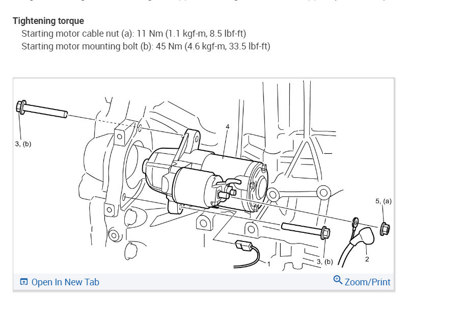

How to replace the starter?
2011 SUZUKI KIZASHI
147,000 MILES • 4 CYL • 2WD • AUTOMATIC
LISAGREEN57
Video or how to change starter.
May 18, 2023 at 6:49 AM
  • 55,433 POSTS
We don't have a video, but here is a guide to help walk you through the steps and instructions in the images below to help you with your car:
